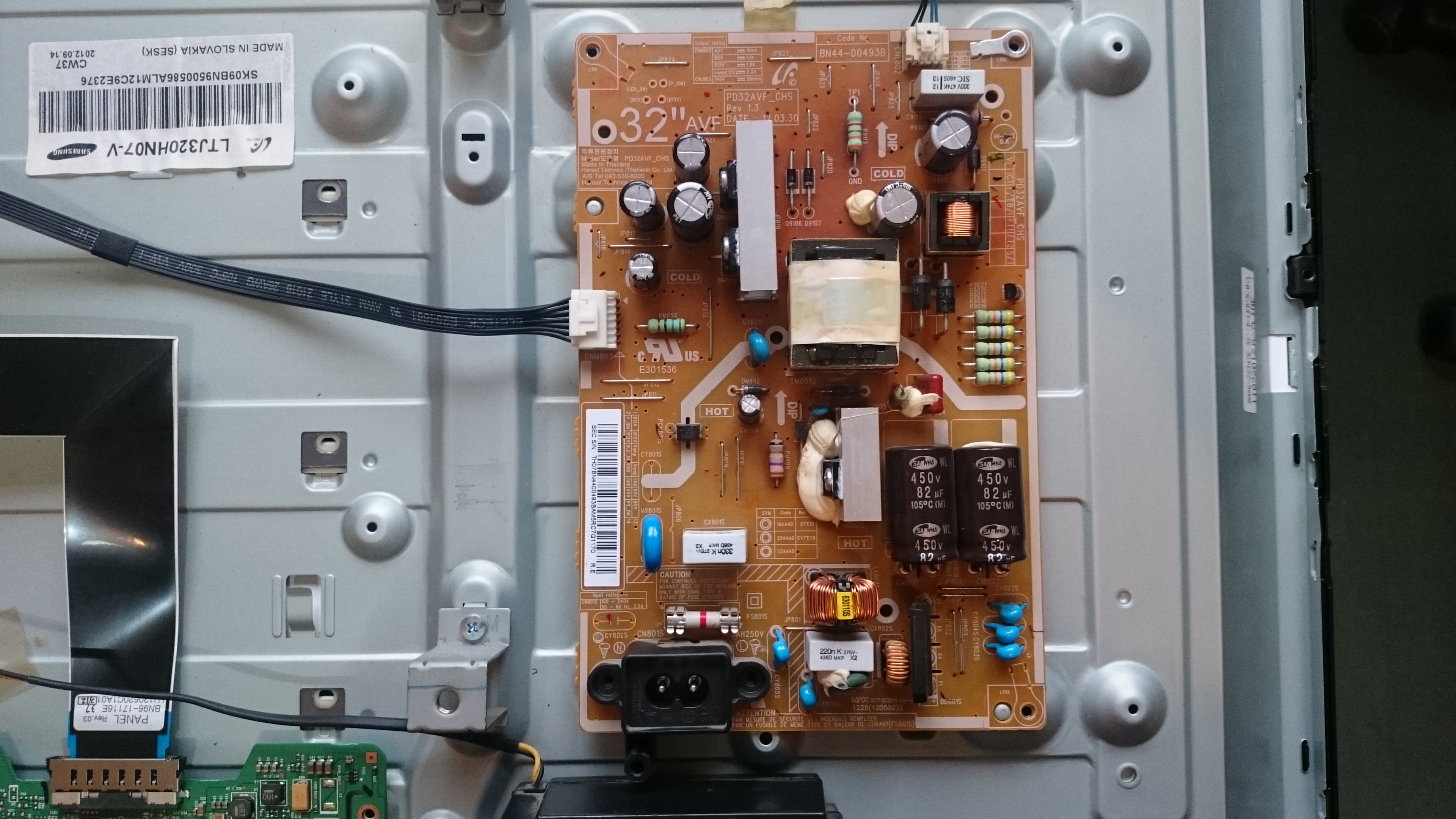

  • Measured 80/178 V rails; LED strips confirmed operational
    #1 16249355
    Piasecki Bogusław
    Posts: 1368
    Help: 158
    Rate: 318
    Similar topic (https://www.elektroda.pl/rtvforum/topic3300869.html#16241818)

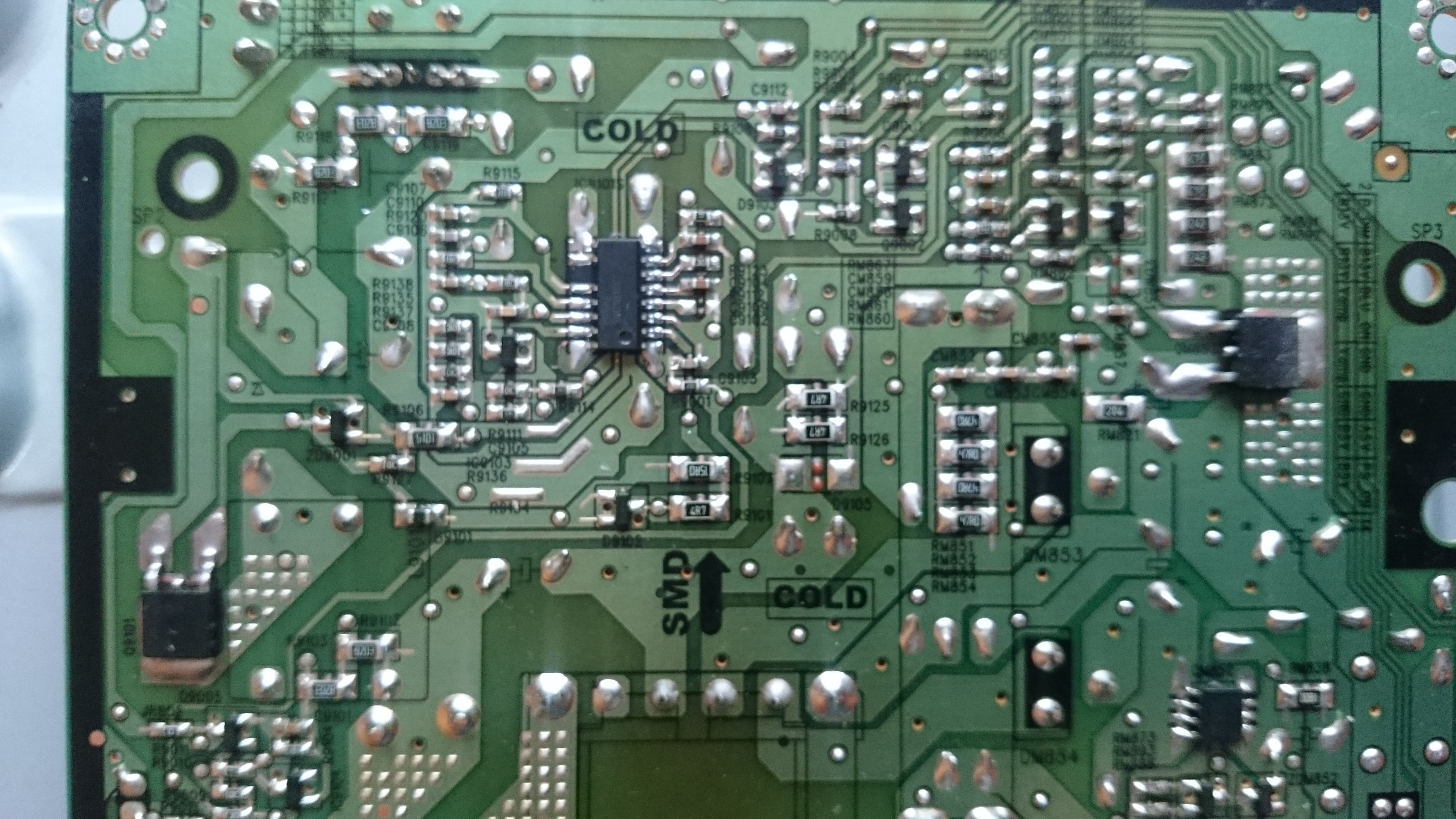

    with another PD32AVF_CHS BN44-00493B power supply. The LED controller is IC9101S / SLC1012C has power supply on one 12V foot. On the CN802 connector - 0V and 80V and 178V in relation to ground, the same on C9111 / 33mF200V - 178V. LTJ320HN07-V matrix LED strips operational, replaced SLC1012C.
    I am asking for a little "light" on this power supply, because I lost the thread.
    Best regards and thank you.

    As in the previous topic, I checked the diode by diode, after dismantling the matrix. I also connected an external power supply and had a backlight.
    The search circle is limited to the power supply only.

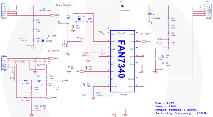

    LED TV Samsung UE32EH5300W chassis U78A - no backlight matrix
    - power supply on LED 141V / 260mA
    Exchange at the beginning the C9111 (electrolytic)
    - if pin.OVP has more than 2.2V then security works
    Vovp = R10 / (R10 + R2 + R5 + R6) * VLED
    / * see doc. Fig. above
    For the DE320BGM-C1 matrix there are 4x lines (10x LEDs in each) connected in series.

    C9111 / 33mF200V changed the value to 28mF. After replacing it, the matrix lights up but blinks quickly and after switching it off and on again, it no longer works.
    On OVP, foot 13 SLC1012C - 2.7V.
    Check OVP divider resistors, LED links, and Rsense feedback

    Either resistors in the divider (especially those with high-ohms) with pin 13 OVP or half (maybe "sits" under voltage)
    See what you have like in series with pin.ovp .. and a divider you will give a resistor about 3k
    See how you get through the LED links .. depends on (Rsense))> see datasheet
    Maybe IC power supply
    Or as a last resort the integrated circuit itself ...
    as the backlight turns on for sec. and goes out
    pin.1-12.5-13V without ripple
    pin.2 6.3V,
    pin.8 ADIM (0.2-0.95)
    pin.13 1.8V * operating mode
    pin.16- 1,6V
