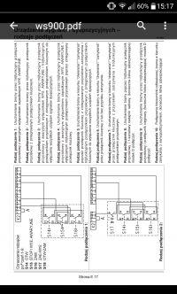

    Hi,
    I have a gate as in the subject. I would like to connect the opening, stopping and closing control with 3 OC contacts - where should I plug in?
    According to the scheme in the D bridge - each subsequent impulse will change the state from opening, stop to closing - but it does not work.
    Anyone dealt with this model?
    greetings

    Not to bridge D. Connect D bridge if you want to connect 1-channel radio control or pull switch (and connects to other terminals - see manual). Then the impulse acts step by step.
    What does it mean
    JarekMk wrote:
    control of opening, stopping and closing with 3 OC contacts -
    . Do you want to control some OC transistor output?
    Write specifically what you want to control. Want to have lift, stop and lower separately?

    Scheme no.1 Elektromaten WS900 Gate Control: Connecting Opening, Stopping & Closing with 3 OC Contacts
    The stop must be NC
