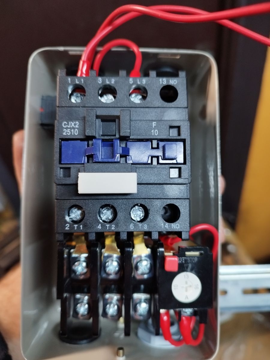

    Hello, I need professional help on how to connect the compressor compressor main switch exactly. With L1 it is released on the switch, what are these 2 free cables (blue) for L3 and A2, do you need to bridge the coil?
    For one phase will the coil go?
    I attach photos:
    Wiring a 7.5 kW Compressor Switch: Guidance on L3, A2 and Coil Bridging20170617_1..506.jpg (3.31 MB)You must be logged in to download this attachment. Wiring a 7.5 kW Compressor Switch: Guidance on L3, A2 and Coil Bridging20170617_1..333.jpg (3.64 MB)You must be logged in to download this attachment. Wiring a 7.5 kW Compressor Switch: Guidance on L3, A2 and Coil Bridging20170617_1..318.jpg (4.03 MB)You must be logged in to download this attachment. Wiring a 7.5 kW Compressor Switch: Guidance on L3, A2 and Coil Bridging20170617_1..350.jpg (3.56 MB)You must be logged in to download this attachment.

    In the first picture you have a photo of the contactor with a 380 V coil, i.e. phase-to-phase, i.e. you will not supply this contactor with one phase.
    Blind blue wires stick out because someone had such a fantasy. Nothing comes of it.
    On the following photos you have a diagram, and connected components according to this diagram.
    And what do you want
    Jaaaaajććć ...
    Sorry, these are photos of the same mailbox.
    Between these 2 blue should be plugged pressure switch that controls all this.
    If you short these 2 blue ones, you turn them on, but nothing turns you off, there must also be a pressure switch.

    L1, L2, L3 supply to L1, L2, L3 on the contactor, blue blinded to the pressure switch.
    I don't tell you anymore, because if you don't start after this post, it's better not to do it.

    Connect the pressure switch as prompted by a colleague Beam_beer. Upper clamps; L1, L2, L3 are power supply, lower terminals output for the motor.
    Of course, when connecting the power supply you can not forget about the PE protective conductor.

    A1, A2 - on the contactor, are the contactor coil terminals. These two blue ones connect to the pressure switch.
    The control is yes;
    The L1 phase comes to the L1 power supply terminal, it goes to the circuit breaker
    - a thermal break comes from the switch
    - from the thermic goes to A1 (contactor coil clamp)
    - from the L3 terminal (to which the supply L3 phase is connected) the wire goes to the terminal A2 of the contactor coil
    The coil is powered between phases (400V) as previously written by colleagues.

    With a 3-phase pressure switch, you use one pair of contacts to which you connect the blue wires insulated with plastic plugs.

    A thermostat is connected to the contactor output, and a motor is connected to the thermostat output.

    In this case, the blue wires must be connected to each other. In this system, the contacts of the pressure switch, which is probably more expensive than the contactor you have used, suffer unnecessarily.
    I would do as I write (the pressure switch controls the contactor), do as you like.

    I connected as described above, everything works fine, sorry for the misunderstanding and thank you very much for your help

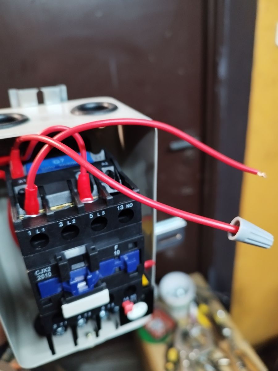

    Hello. A little digression, but I have the same problem. I have a similar contactor, although the original connections are a bit different. The power and motor connections are clear. Where should I connect the pressure switch? Under the coil A1 and L1 as it is originally derived? Then coil A2 remains free.

    If you connect A1 with the L1 wire, does the contactor work?
    The other terminal A2 is at the bottom of the contactor.
    One wire from the thermal switch is connected to it (auxiliary contact), the other wire is connected to L3.
