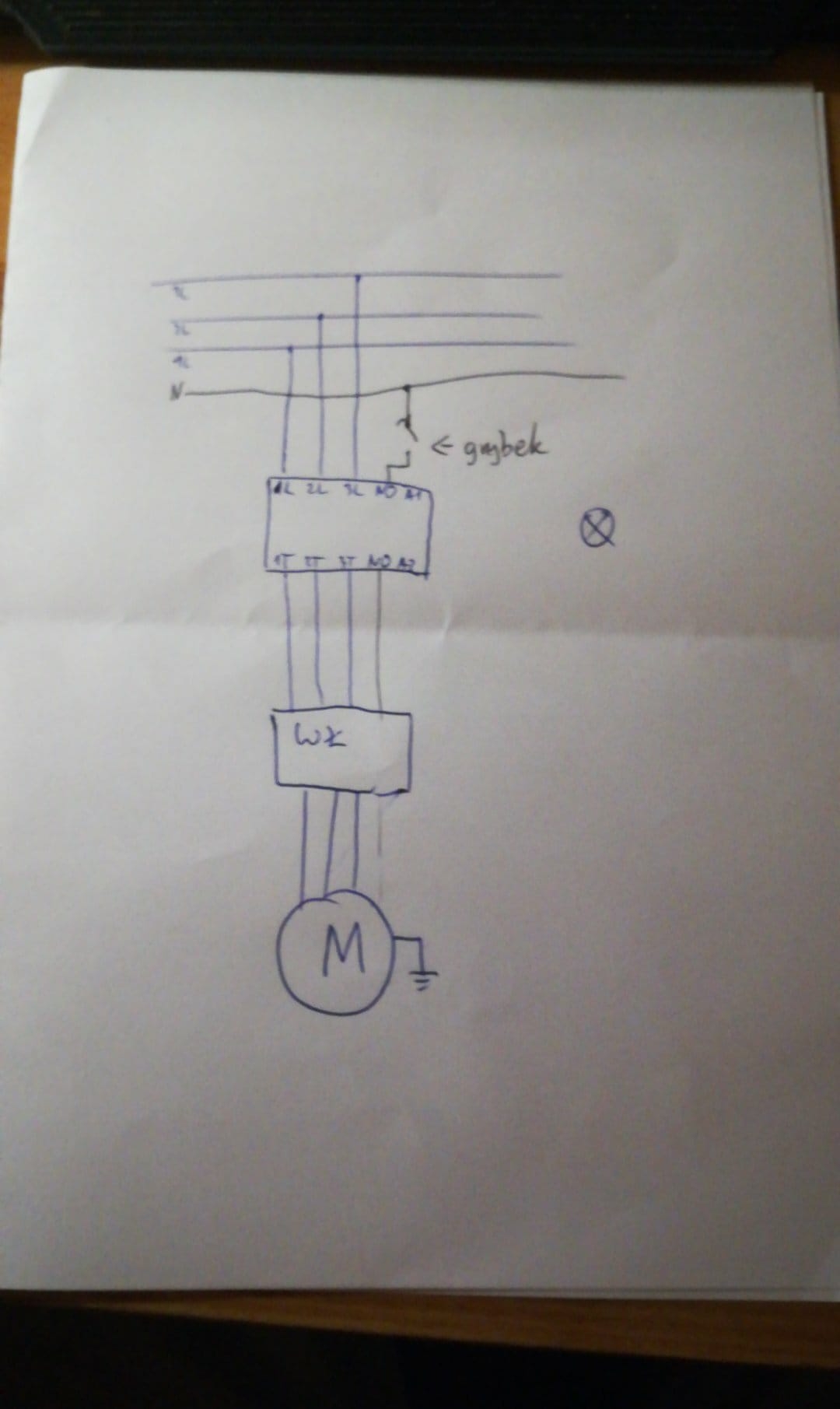

    I warmly welcome,
    I was given the task of connecting a 3-phase motor to a chainsaw in a workshop (I am an electronic engineer at rest :) ). The installation is 4 core, 3 phase and one earth / neutral. I have a 16A schneider contactor, an old type switch (such a twisted switch), a safety mushroom and a motor. Please tell me how to connect a single-phase plug to a contactor (inputs on it L1, L2, L3, NO, A), to disconnect the contactor with the plug? My concept was (and I do not know a lot about the contactor) to pass the phase to the L inputs, neutral through the mushroom to the NO input (from what I understand it is normally open, i.e. it must be somehow powered - here I have a problem) and go further to switch.
    Connecting Three-Phase Motor to Chainsaw with 16A Schneider Contactor, Mushroom Switch & 4 Core
    I don't know if I am thinking right, so please be understanding.
    Best wishes :)

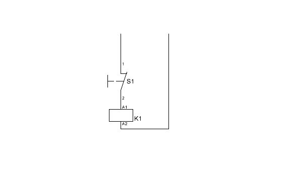

    You break the contactor coil circuit with a mushroom, which causes only the motor.

    so I run the cable through A1 to the mushroom and from the mushroom to A2, right?

    This is not how you will short circuit.
    Power to A1 goes through the mushroom and that's it, and A2 goes to power.

    @cr! S What "Grzybek"? Toruński? It's called the "safety button". You connect it in series with its NC contacts to the contactor coil. What you wrote is a parallel connection, completely pointless. Besides, this diagram is also nonsensical as you only use a contactor for emergency disconnection. And now someone will leave the three-phase switch in the "on" position, and another will unlock the pressed "mushroom." The "start" and "stop" buttons are used, an overcurrent thermal relay, matched to the motor power, and the auxiliary contacts of the contactor provide its self-support. Connection diagrams everywhere, also on the Forum. :D

    My colleague, the motor must have overload and short-circuit protection. The off button must effectively turn off the power to the motor.
    No switch on button. Here is a diagram.

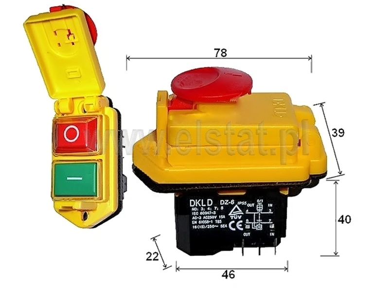

    Of course, if you were doing your own home, you could forgo the extra alloy. But for the public utility it should be equipped like this. Good devices use a compact solution, for example.
