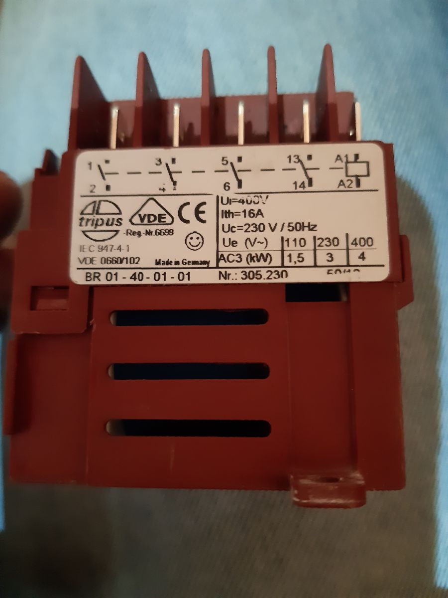

    I need help connecting the cement mixer switch to a three-phase motor.
    The problem is that the switch does not lock, locks when pressed, you only have to hold it all the time.
    I unscrewed it seems that the cables are well connected I also measured the coil resistance and once it came out 10Kohm sometimes it dropped to 4KOhm. It looks like the coil doesn't turn on
    Maybe the cables are badly connected?
    The cables shown in the picture are connected to the plug from below Cement Mixer Switch Connection: Three-Phase Motor, Coil Resistance, Cable Connections

    Coil for what voltage is, maybe N does not come as it is on 230V.

    The coil is 230V type 305.230 and is very often damaged.

    If, after pressing the start button, the contactor does not switch on and the measurement of the coil winding resistance is variable, it indicates that the coil is damaged, you need to replace the entire automaton (contactor).

    It is not a coil, because when the start button is pressed the contactor is switched on.
    Maybe the problem is with the "stop" button, which should be of the NC type.
    A friend of Wojtek 9007 may be right ...

    In fact, I did not read that it turns on, so the coil works, but why such discrepancies in measurements? The contact in the contactor remains. That is, parallel circuit switching with the contacts of the "start" button.

    Only in this contactor I do not see an additional contact to support:
    -4 working contacts and coil power supply ...
    I would check if the "stop" button is closed (NC).

    Since when the 3 phase motor has 4 wires of the current circuit.
    And what is marked on the contactor 13-14.

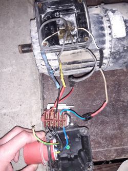

    Hello, I have a similar problem, i.e. when I hold the start button of the concrete mixer, the concrete mixer works and when it is released it stops working
    The connection looks like the picture photo of the contactor
    Of course, the ground cable (yellow-green) is connected to the motor housing
    I am asking for help / hint what is wrongly connected

    You need to check if there is a phase on the white wire on the right side after pressing the green start button.
    You can also disconnect the white wires and check with a multimeter (meter) if there is a transition.
