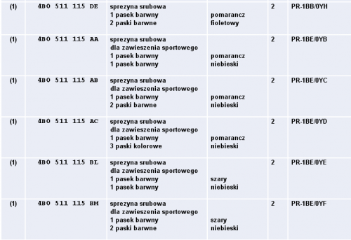

    I am trying to replace the front springs because the ones I have are very hard, no comfort whatsoever.
    To make things easier, I will add that the sticker says OJH OYD 1BA.
    I would like to know from you how they were color-coded?
    Because it seems to me that the predecessor exchanged for some sports because the car stands rigidly and selects each hole.

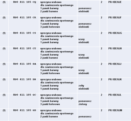

    Passat B5fl 1.9tdi AWX 2002 - The color and number of dots on the front springs. maybe it will do

    I was more concerned with the comfortable suspension, what is the symbol?
    The list you provided is for the sports suspension.
