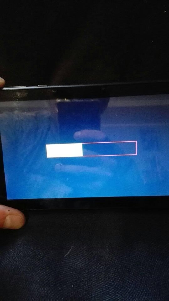

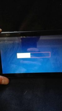

    I burned the image on the card, put it in the tablet, with the recovery level turned on the external medium and such a window is, a good clue ide?
    Cavion Base 7.1 Quad Tablet - Stuck on Android Logo after Factory Reset & Auto Reboot Issue
    Added after 57 [minutes]:
    Can someone tell me what this window means because it has been in the place for an hour

    Upload using the program, not cards.

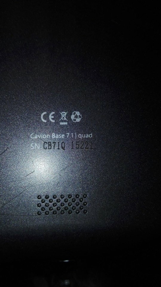

    Please take a clear picture of the back panel where the tablet type is indicated.
  • #13 16859338

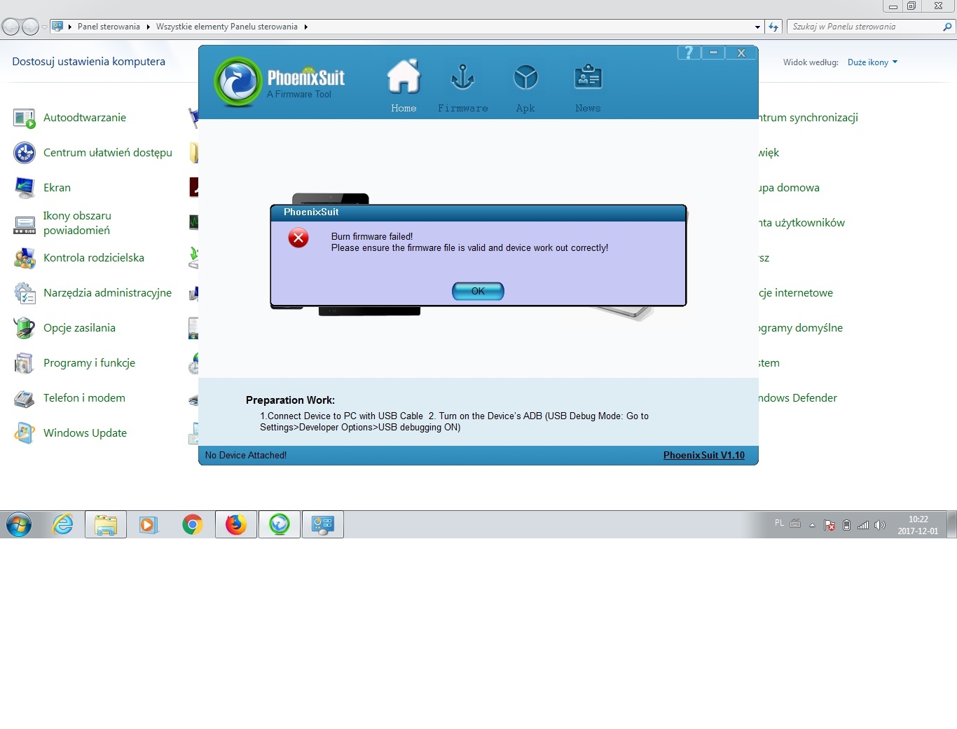

    Whenever I try to load an image with the .img soft, the program does not want to load it, and therefore I have the whole problem, I have software from elektroda.pl

    Show the photo with the displayed error
    Added after 9 [minutes]:
    My colleagues did it, on another computer, which had no drivers, it went smoothly, thank you all.
