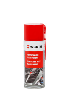

    A very specific statement, I would be more aware if you wrote me more about why you are against lubrication. In that case, I will ask, is there anything that can be done so that the rusting hub does not "weld" to the disc over time? Following that thought, I just asked if any measures should be taken.
    Being in the automotive store, the seller assured me not to use copper grease, ceramic paste, and offered something like this:
    Restoring and Protecting Rusted Hub on Superb II 1.9TDi 77kw: ATE Discs, Pads and Calipers
    Content 400 ml
    Color Transparent
    Min./max. skin formation time 90-120 min
    Skin formation time - conditions At 20 ° C
    Type 360 ° valve
    Min. Temperature resistance -25 ° C
    Temperature resistance 160 ° C
    30 cm spraying distance
    Application temperature min. 15 ° C
    Application temperature max. -25 ° C
    Density 0.665 g / cm3
    Density conditions 20 ° C
