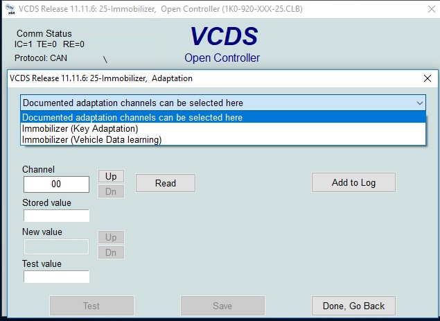

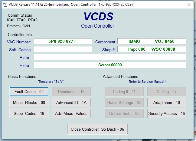

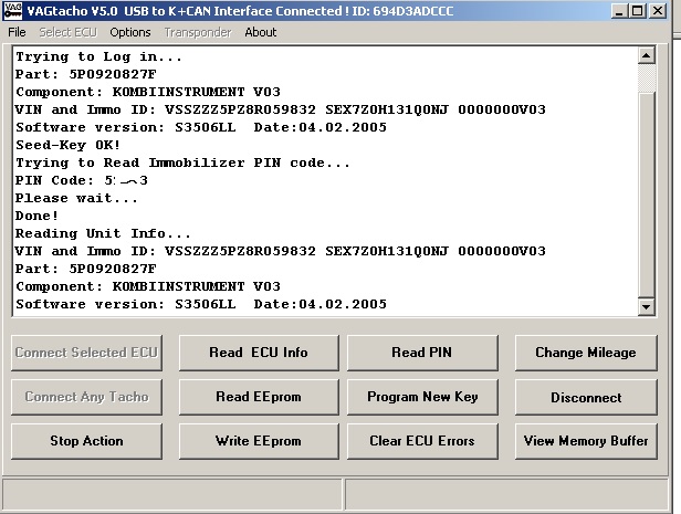

    Hello, I lost my 2008 Altea XL key. I would like to add a new immo to myself, PIN I downloaded VAG TACHO (5 digits), I already have the milled pilot bought and fitted (opens, closes, etc.), the predecoded transporder also I already have Megamos Crypto ID48 TP22. And the problem is that as soon as I connect VCDSem to Immo and enter the PIN - of course he accepts me. Then I give adaptation and there only 2 channels 01 and 02 available. In channel 01 I have "adaptation key". all the descriptions that I found are that the key adaptation is in channel 21 and I have 01. Anyway, as read and show me that two keys are programmed and give 0 then test and save it looks like it's ok but I don't really like reset and still remains 2. and as I type 2 and give test and save and of course, I put the keys in order, i.e. the one that works and then the new one is not programmed. I have the impression that although I enter immo, I do not have write permission. Anyone know if I can do this in my seat using VCDS? Maybe I'm doing something wrong. do you have any idea
    Screenshots from vcds and vag tacho are attached

  • #12 16580948
    duperszfel
    Posts: 11
    Rate: 8
    I believe that the forum is to help each other, so I do not intend to hide the solution. VagTacho 5.0 with alliexpres did the trick, first read the PIN with it and then added a new key. Earlier I didn't want to use VagTacho to add just to read the PIN, but I decided that it would try and it took me 1 minute and the key added.
  • #13 16581315
    oktawian89
    Posts: 1046
    Help: 52
    Rate: 444
    This is because altea xl does not use so-called Dealer key, which requires 7 bytes of security component to be encoded. So a transponder precoded under the brand alone is enough.
