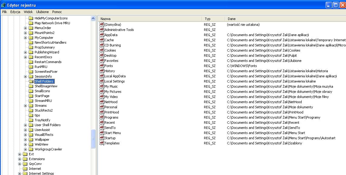

    C: \ Documents and Settings \ All Users \ Documents \ Desktop
    On
    C: \ Documents and Settings \ Krzysztof Żak \ Desktop
    I have been trying to change the value in the register for a long time as in the attached picture and nothing comes of it. I was looking for answers on the web but I am also not able because I ran out of ideas and then you can find the answer.
    With this value:
    How to effectively change the location of the desktop folder in the Windows XP S
    On this:

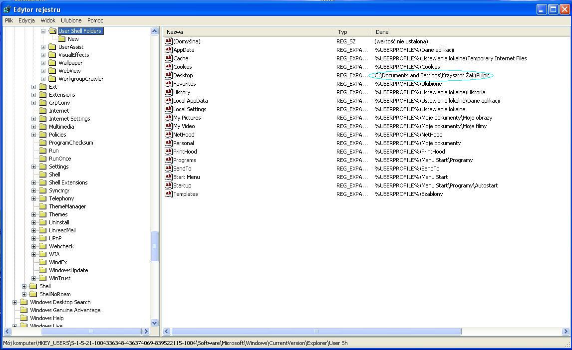

    Added after 1 [hours] 12 [minutes]:
    The method from item 4 in this Post helped.
    Information taken from link .
    I don't know if the methods from the previous post affected the final result.
    Added after 23 [minutes]:
    In the photo below you can see the "blue" change in the register.
