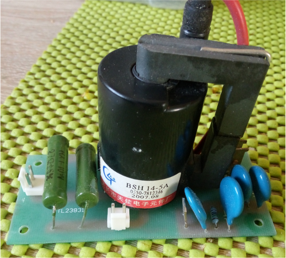

    I have an old "no name" transformer welder.
    This welder is a device based on a welding transformer, which is wound with aluminum wire.
    A rectifier built on four diodes has been added to the transformer outputs. Throttle missing.
    Idle output voltage: 62V.
    The manufacturer specifies the maximum welding current parameters at 160A.
    There is little truth in this but the electrode 3.2 can somehow be welded there.
    I tried to use this as a TIG source by connecting a TIG torch and of course gas (argon).
    Several times I was able to initiate the bow correctly and then it was welding even cool (for someone who never had a TIG in hand).
    The problem is the arc initiation. After another sticking of the electrode and damage to several electrodes, my enthusiasm subsided a little.
    Now I have such a neat plate - a high voltage generator from the Flora Dekatech TIG130 inverter.
    Does anyone have a scheme to control such a generator? (I mean the value of the supply voltage and frequency).
    I can handle the welding output connection and protections.

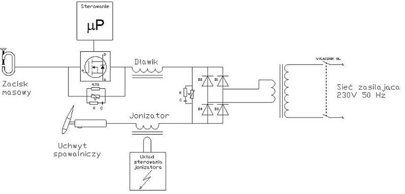

    I don't know if it will be useful, but I once "tracked down" such a pattern. How to Connect a High Voltage Generator to an Old Transformer Welder for TIG

    The scheme is unlikely to be useful. This is a completely different system that increases the welding voltage output.
    This is to facilitate arc initiation and improve MMA welding stability.
    Scheme or other information about the above ionizer still sought after.

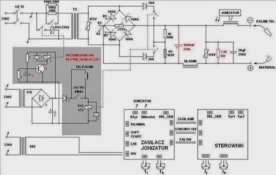

    I looked at the offers (sale section but no offers) in the AVT store, until recently they had PCBs and a detailed description (it is in one of the AVT monthly magazines from a few years ago) quite a simple conversion (attachment) of the SPB315 welding machine (three-phase, direct current) to TIG, maybe look for how to make an ionizer.

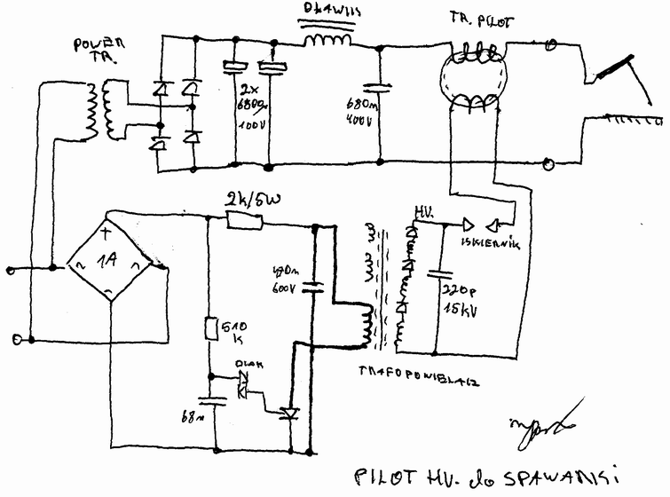

    As for me, this means problems and not normal welding. Secondly, TIG and MMA welding are not much different, except for the type of electrodes and the ignition of the arc is the same. Without the ionizer, aluminum is not welded. (Do not ignite the arc by rubbing against aluminum) A welding machine with a rectifier without a choke is welded worse than a regular transformer. What is the role of a choke, please read it. For example diagrams.
    How to Connect a High Voltage Generator to an Old Transformer Welder for TIG How to Connect a High Voltage Generator to an Old Transformer Welder for TIG
