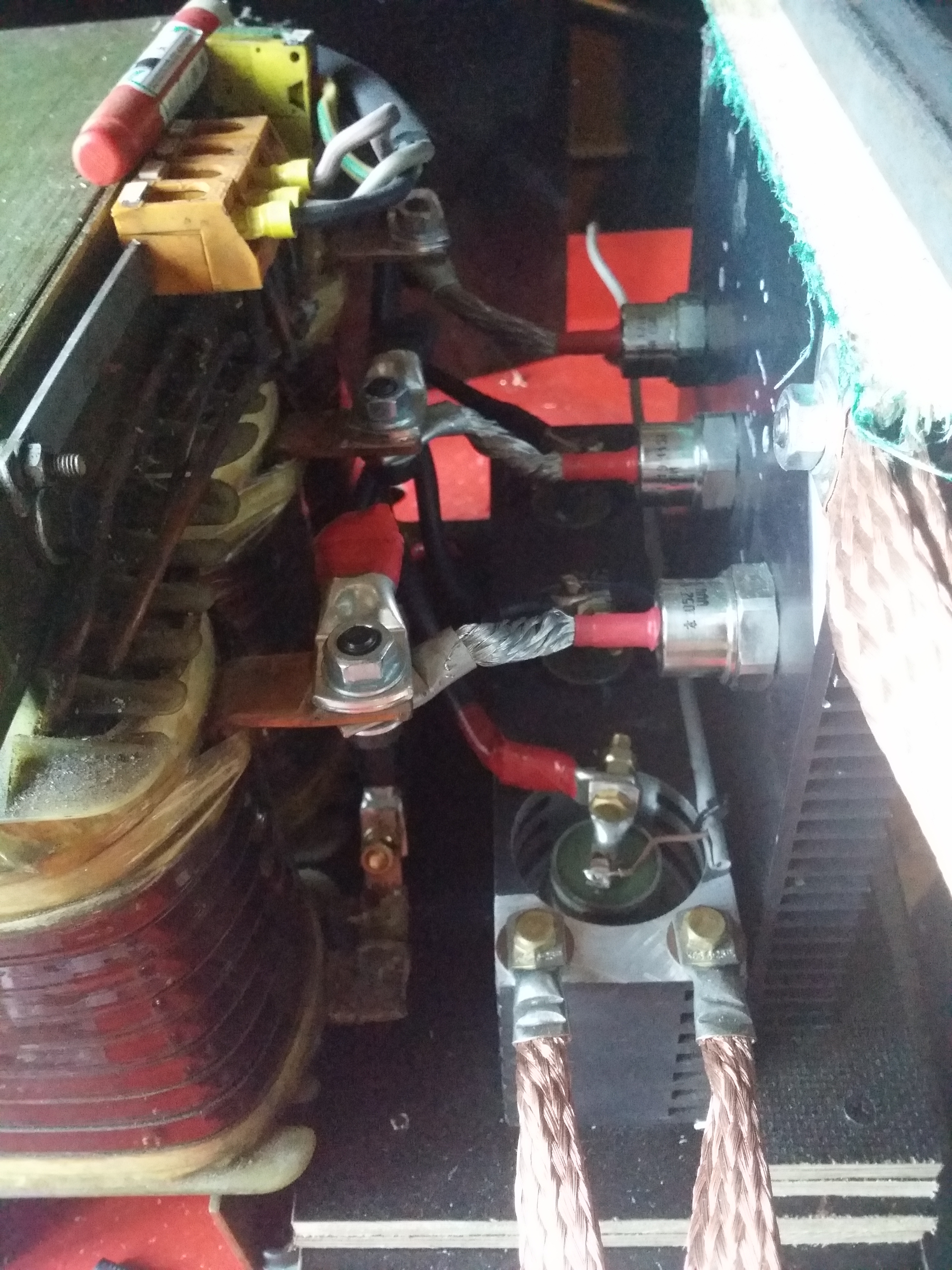

  • Temporary delta connection and rectified voltage test results
    #12 16853531
    napoleon215
    Posts: 6
    ] I have not read the subject, so I asked others what their opinion was on this subject. After familiarizing myself with the topic, I wrote some observations in the previous post. It describes the current expected in delta connection. Of course, regulation of thyristors.
    I just checked the theories in practice.
    In the pictures below, provisional delta connection of the transformer and voltage after straightening (of course, the wires and rectifiers are only temporary for testing)

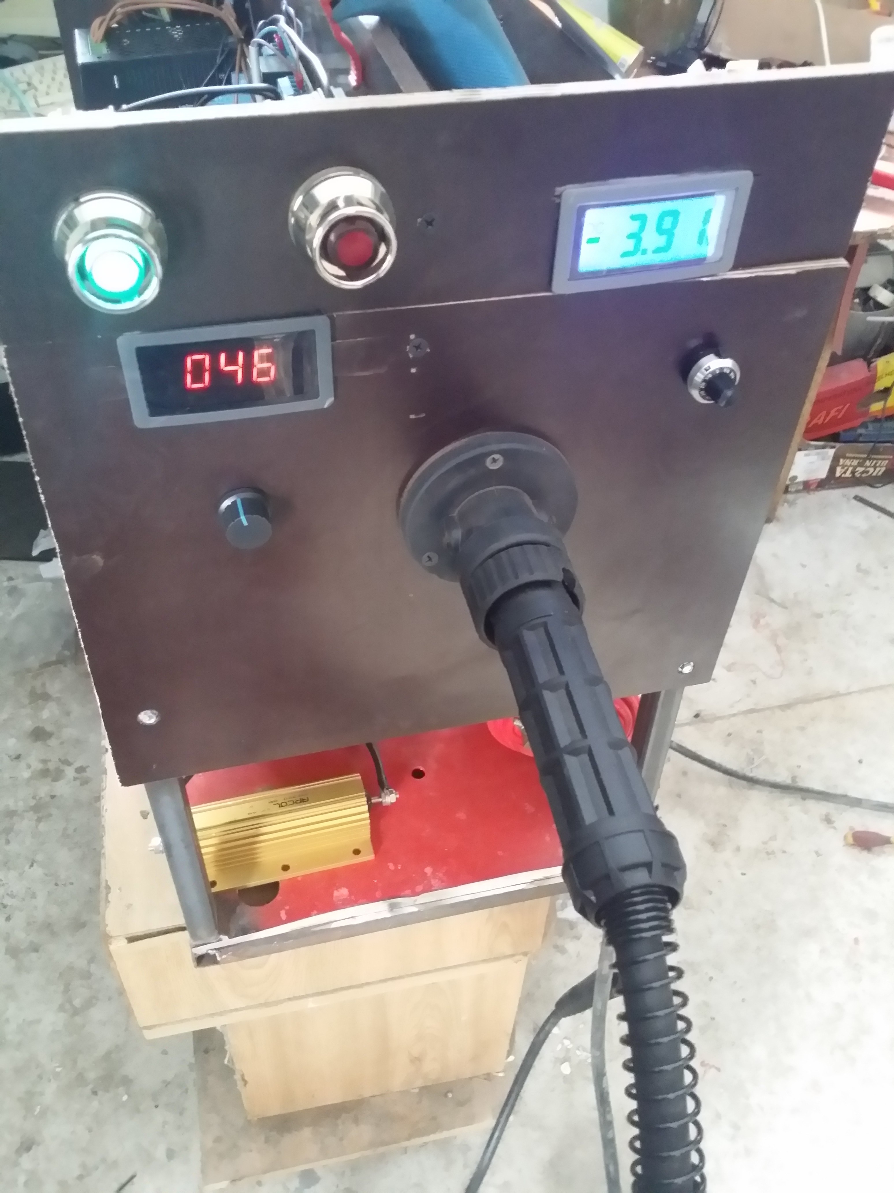

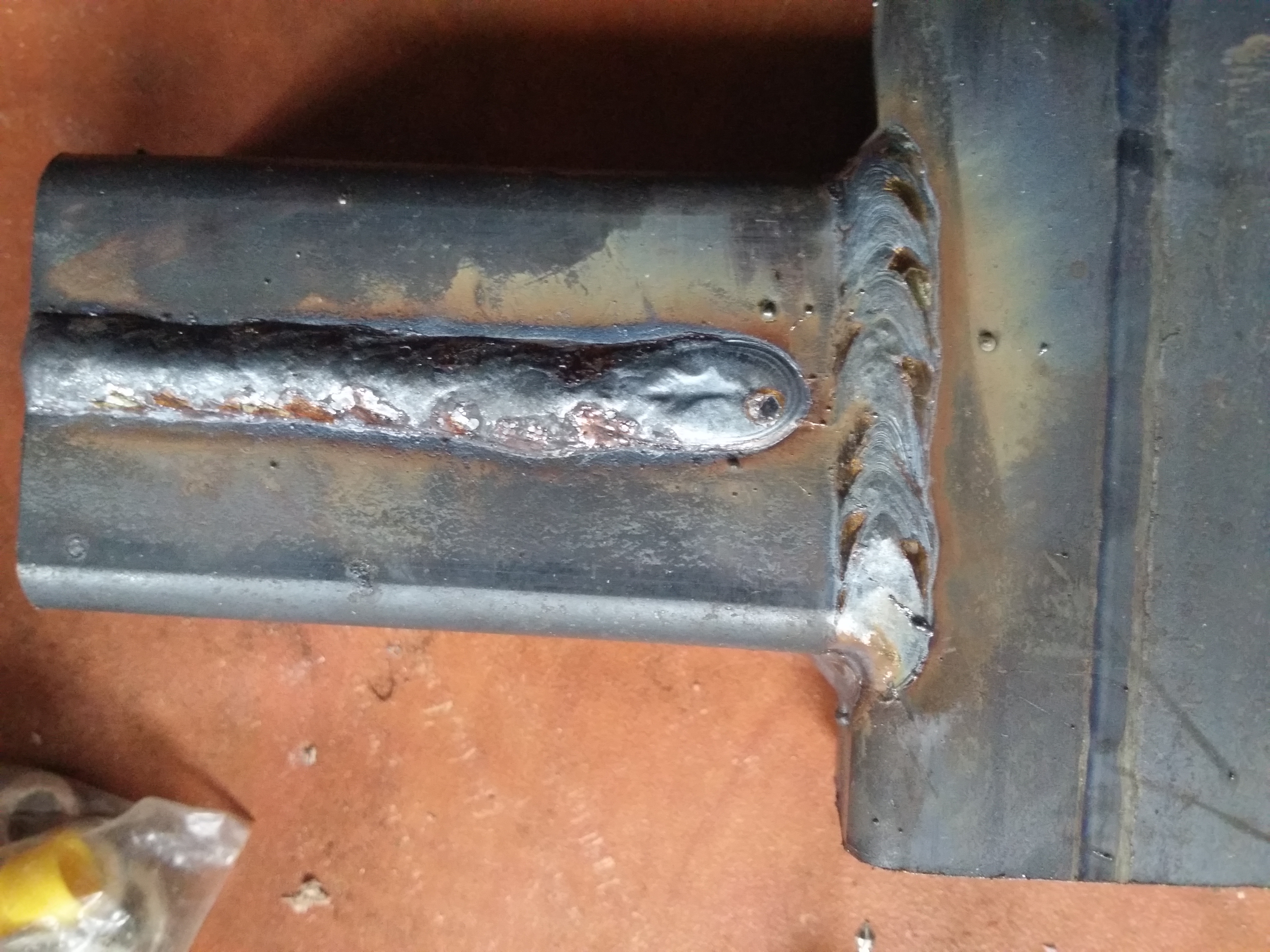

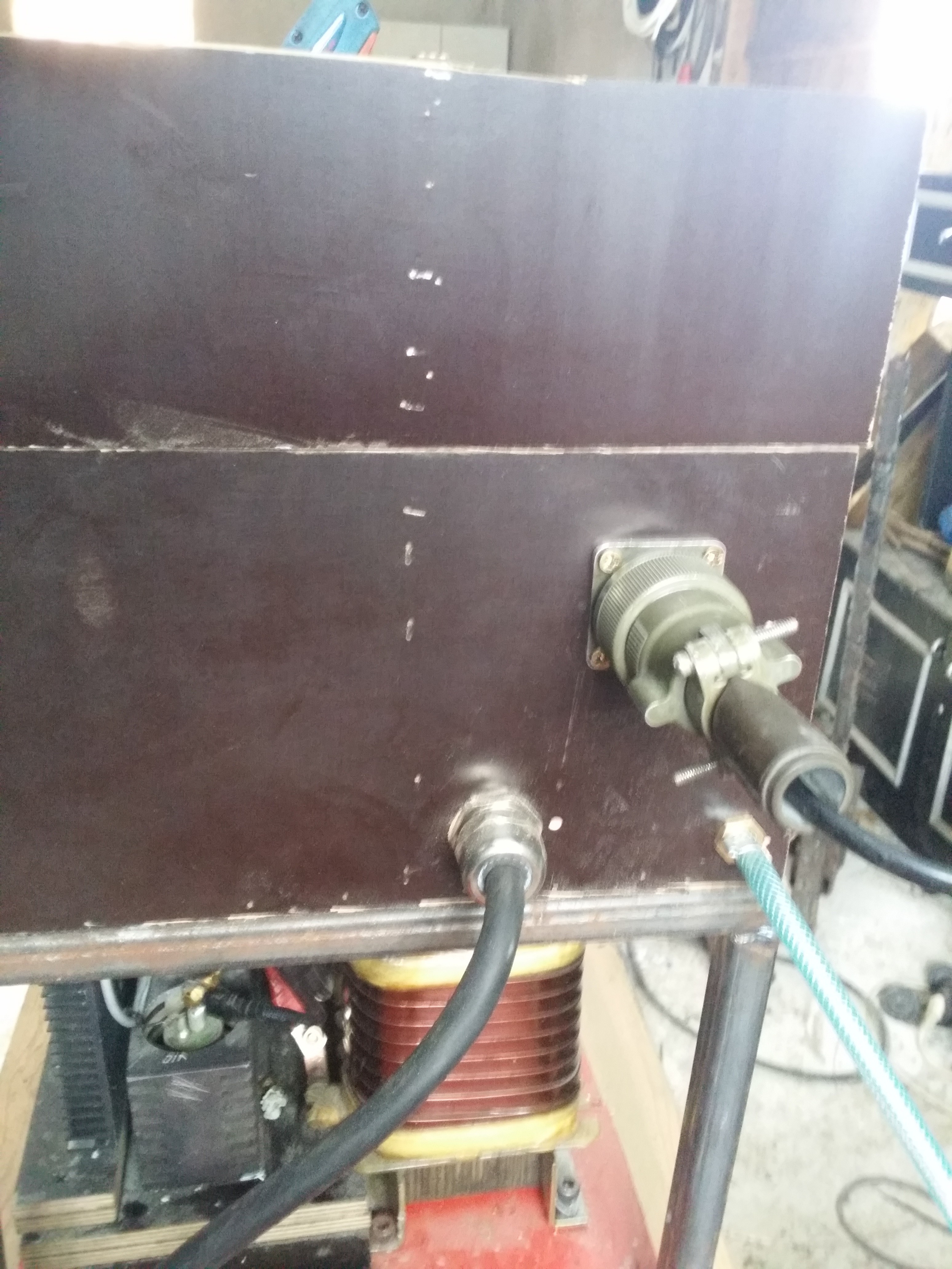

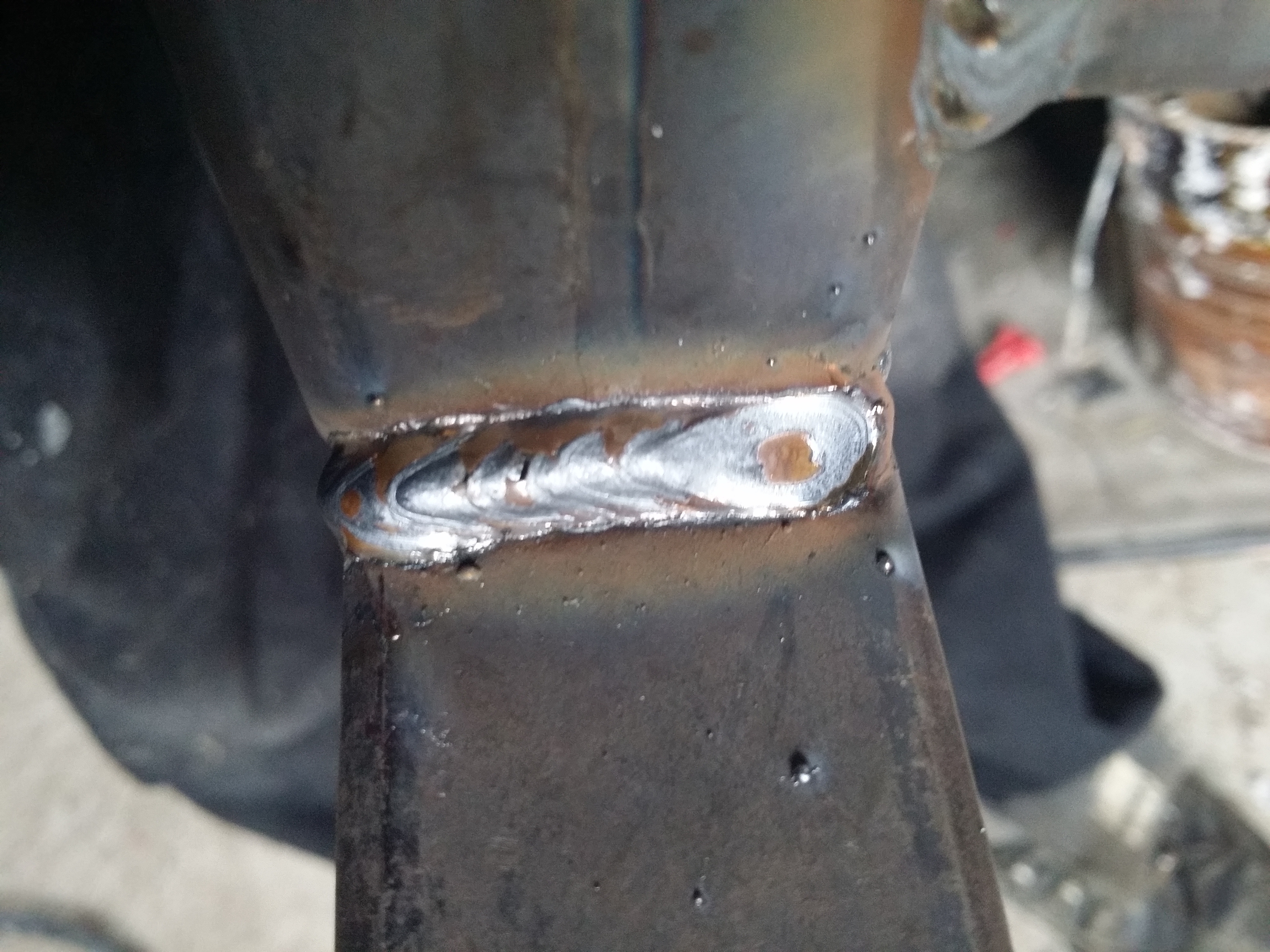

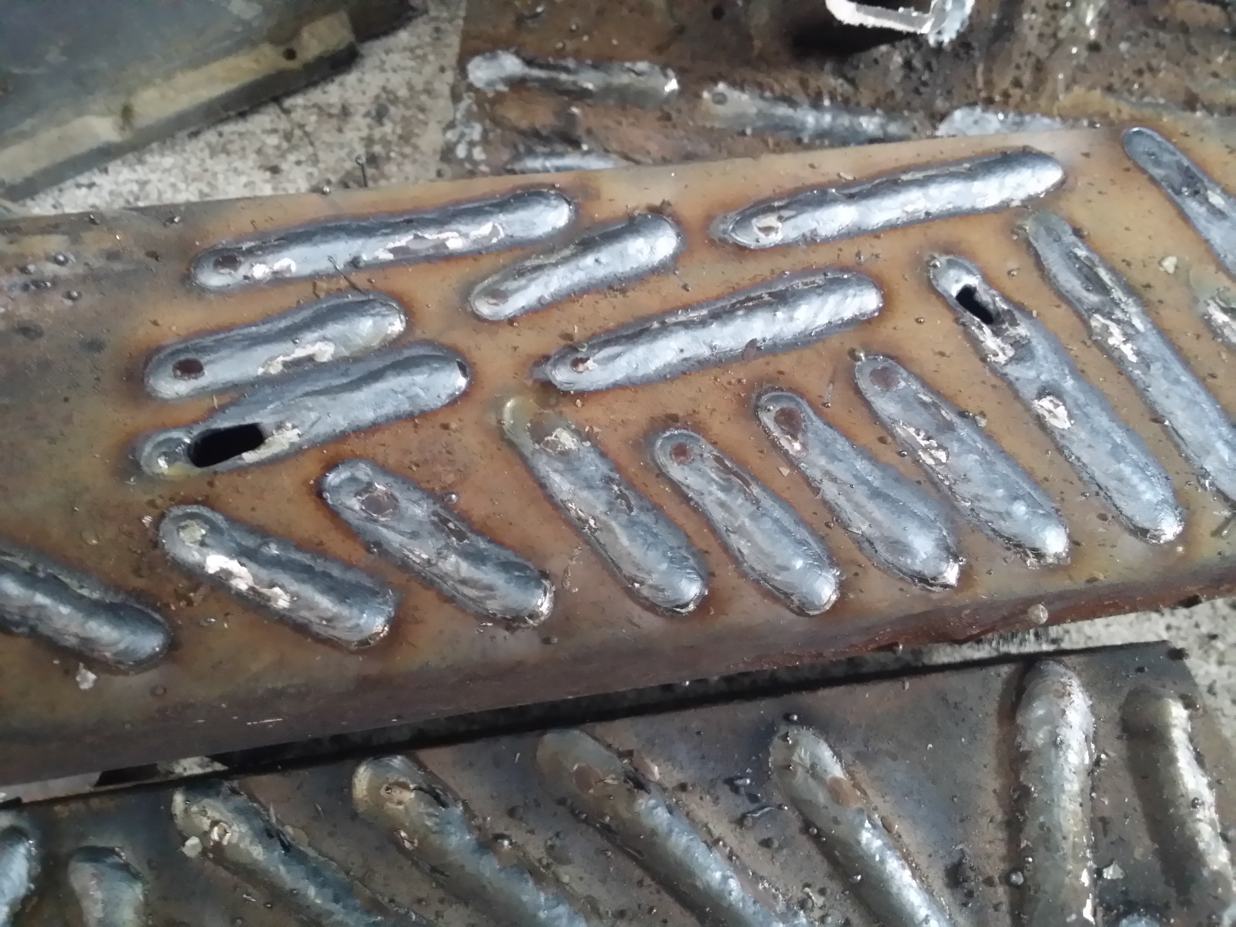

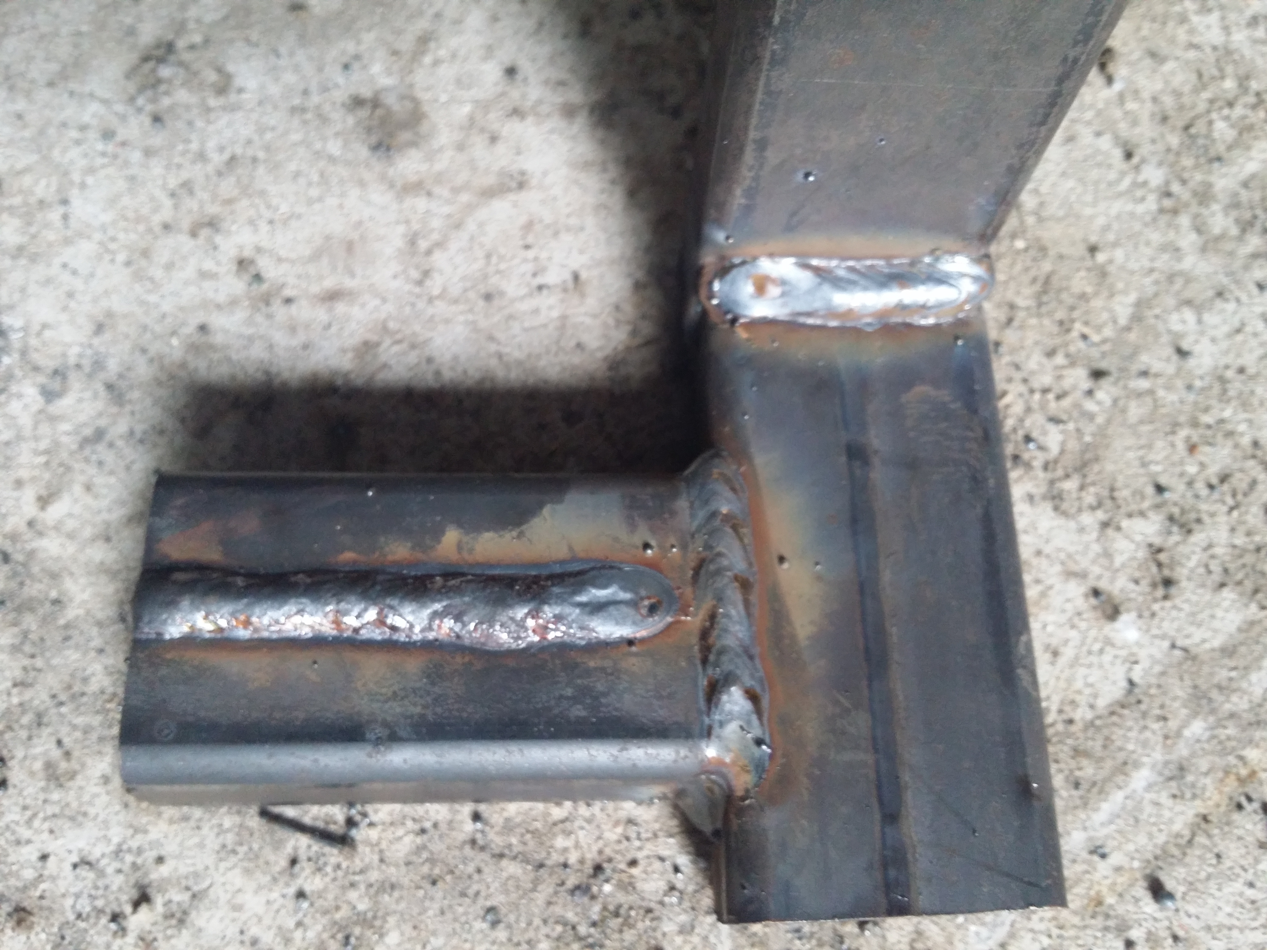

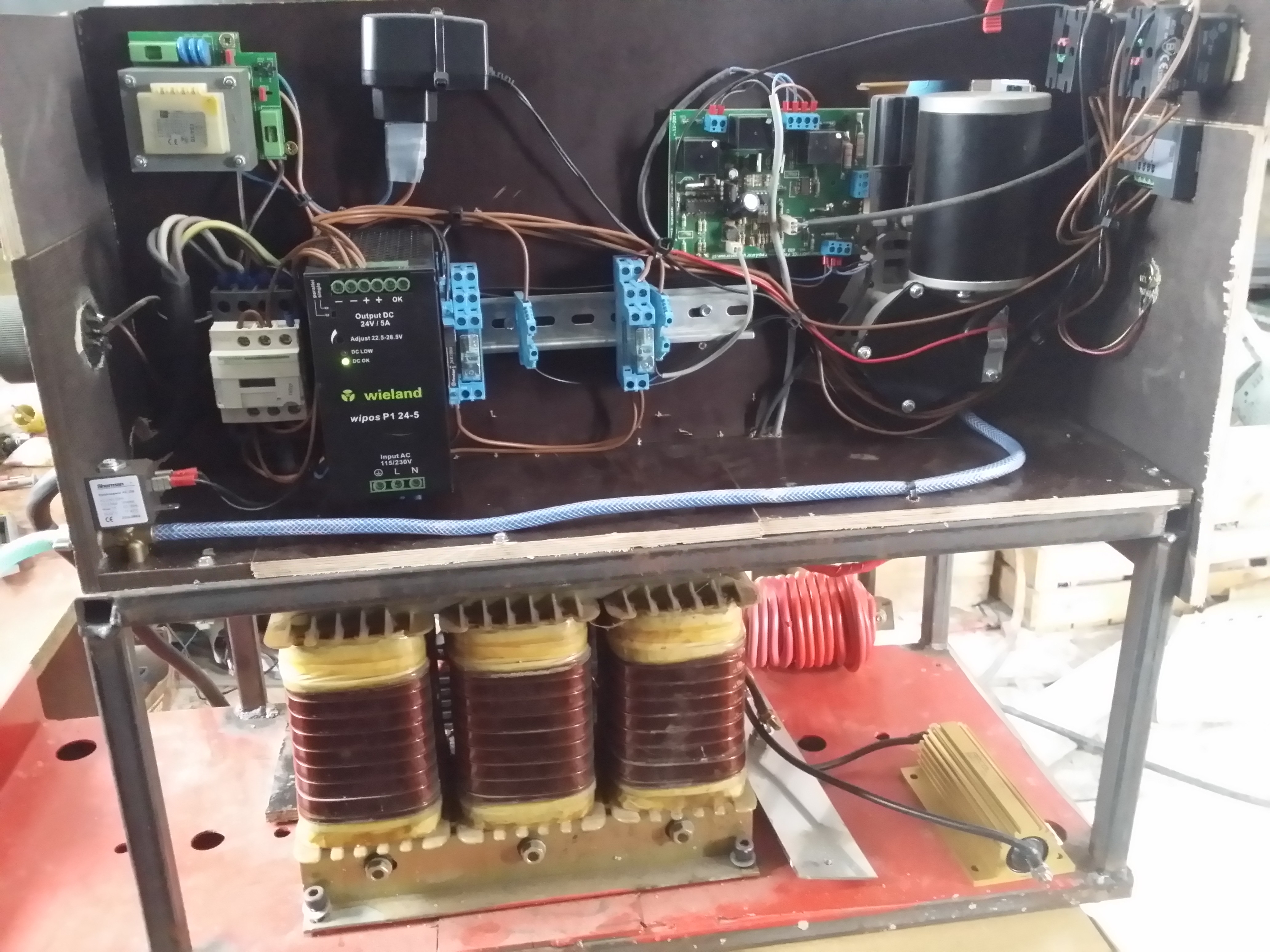

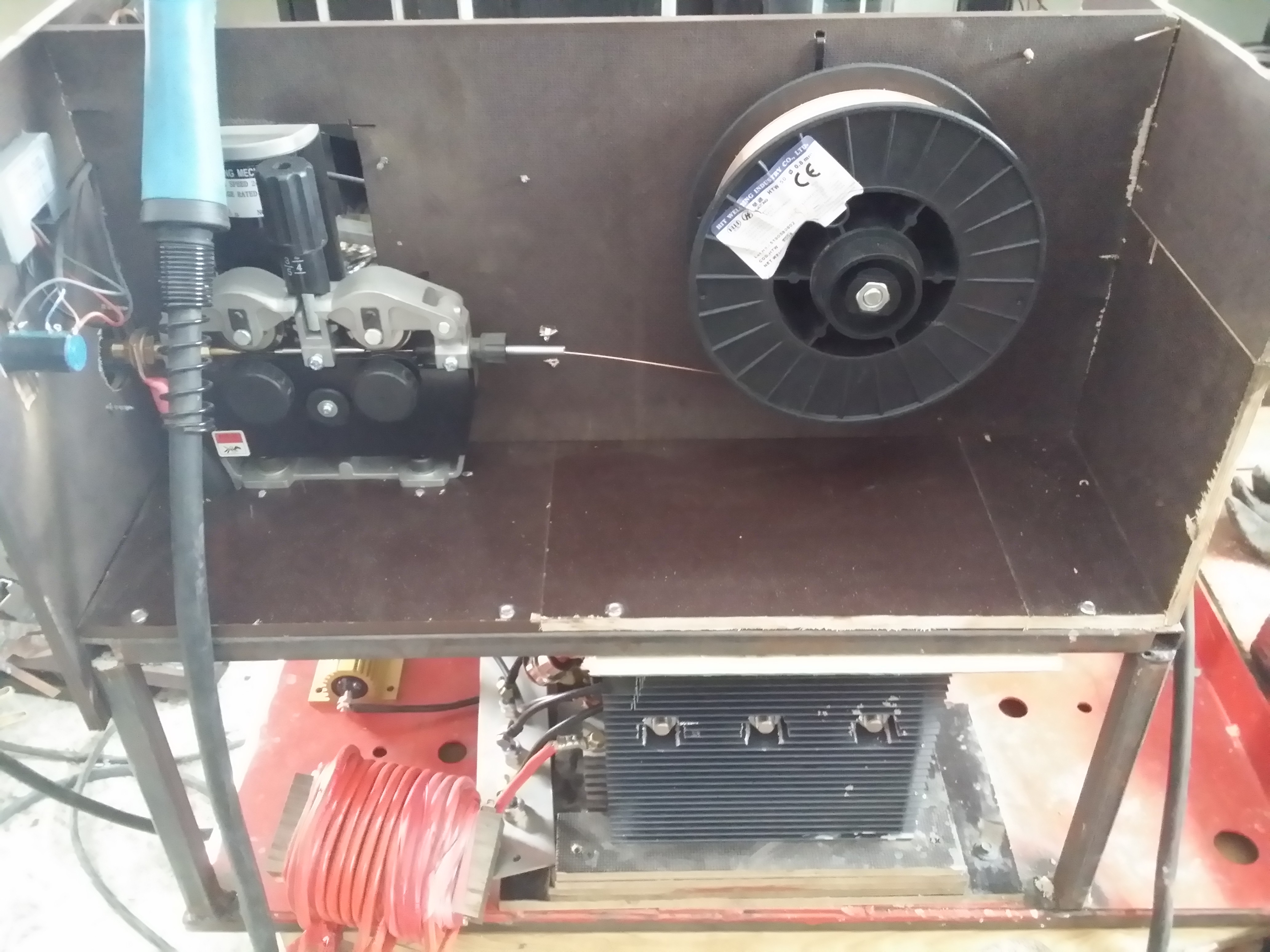

  • #17 17682578
    napoleon215
    Posts: 6
    Migomat is almost finished, there is still cooling and casing (at current temperature -3 there is no need for heat sinks and transformer are lukewarm after long welding). With a 0.8 wire, the max current is 150A and with 1.0 230A I don't have a 1.2 wire. The voltage during welding at 230A is 28v at 150A 26vA at 100A 24v.
