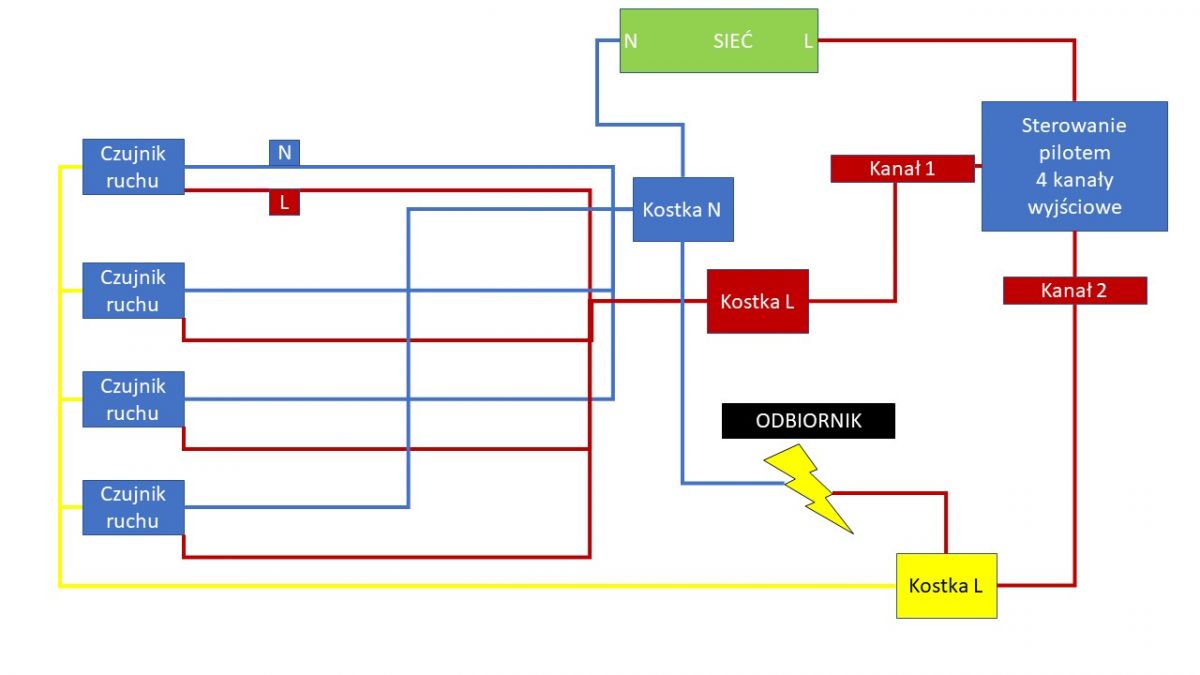

    I wonder if the installation diagram itself does not affect the unnecessary excitation of one detector by the other.
    Reducing Sensitivity of Overly Sensitive Orno OR-CR-211 PIR Detectors for LED Strips
    Pls have a look to see if there is any basic bug I am getting away with.
    Channel 2 is usually off and I made it to be able to permanently turn on the lighting bypassing the motion detectors. Rather, I exclude that it has anything to do with my problems.
    I have doubts whether connecting the L output from the sensors to one does not "reverse" the phase to the sensor and unnecessary excitation.
    On the other hand, the detectors sometimes turn on and off after a programmed time, so they seem to work. If there was a mistake in the installation, they would never work properly.
    And finally, let me just add that I have already limited the field of view of the detectors. They only look "up" by installing wooden shades halfway down the lens ;)
