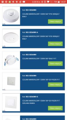

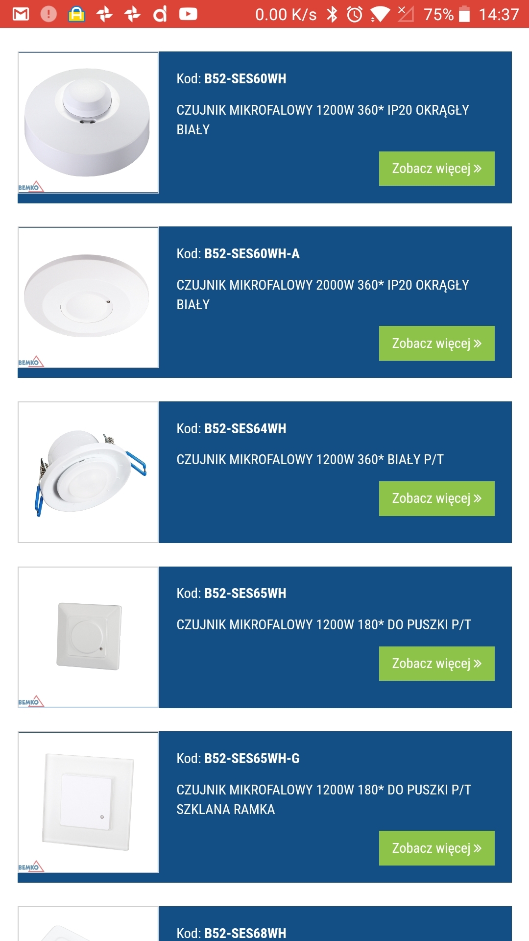

    In relation to what you wrote after my last post I have two questions for you regarding the microwave sensor.
    1. will a microwave sensor give me more resolution than a PIR? So that it detects smaller movements.
    2. what is used to set whether motion behind the wall is detected? Additional apertures on the sensor to narrow the field of view, or using a potentiometer to reduce the wave power?
  • #15 17746937
    kkknc
    Posts: 23711
    Help: 1914
    Rate: 6688
    Ad1: Mostly yes.
    Ad2. With the potentiometer you reduce the range of operation.

    kkas12
    Posts: 17380
    Help: 1076
    Rate: 4288
    Not necessarily.
    See for example: this Link .

    Influence of the number of Fresnel lens fields on the sensitivity of the ORNO motion sensor
  • #19 17747147
    kkas12
    Posts: 17380
    Help: 1076
    Rate: 4288
    You will not find any potentiometers in this sensor at the bottom of the page. And it is possible to adjust all parameters.
