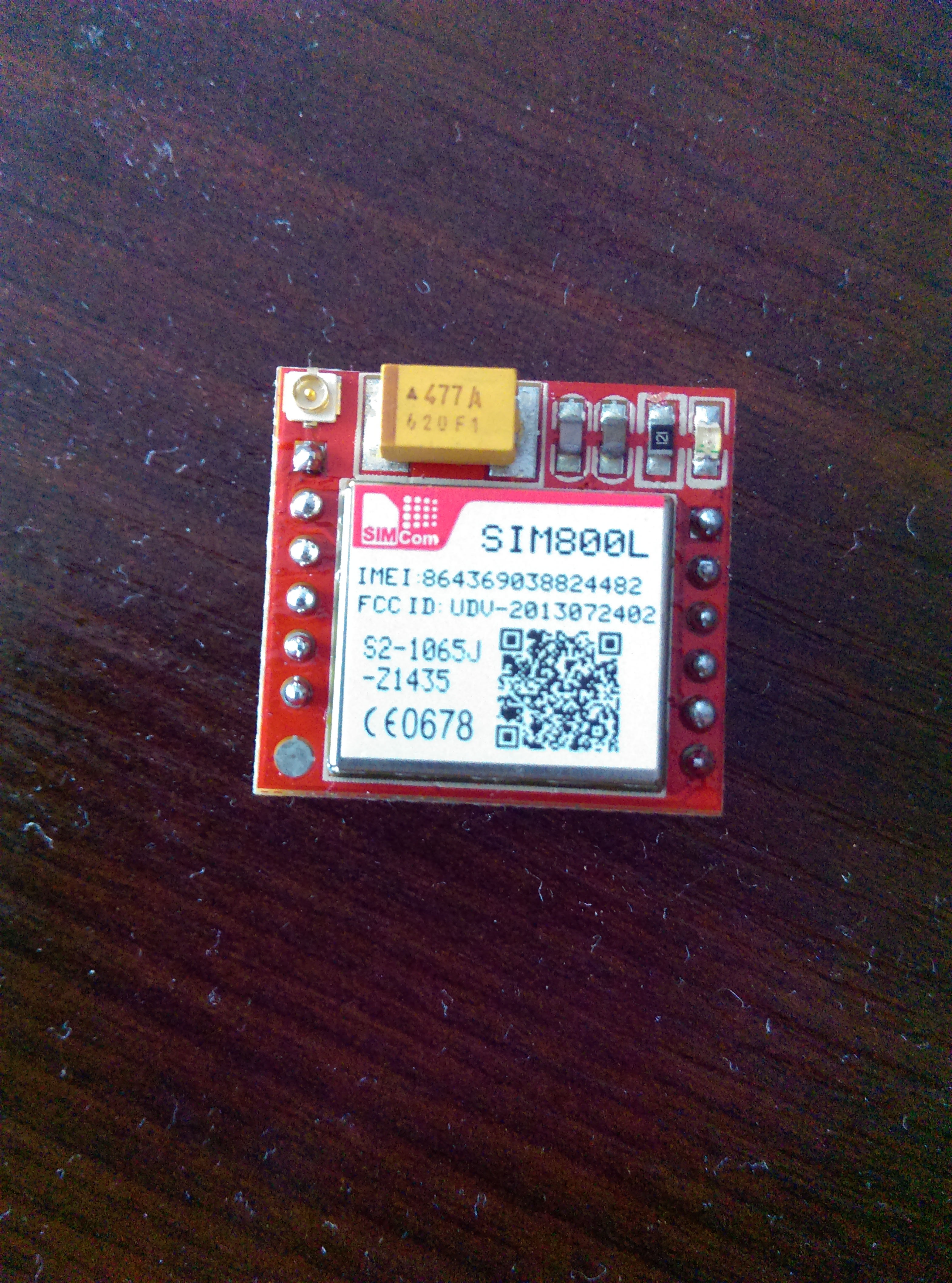

    Hello, I have a GSM SIM 800L module and I would like to use it to turn on the hydration in the yard. I also have an Arduino nano but I don't know how to do it. It would work like this: I send an SMS to 800L, and this one activates the solenoid valves via relays and after some time 5-15 minutes it disconnects the solenoid valves. Module photo: SIM800L GSM Module and Arduino Nano: Automate Yard Hydration via SMS, Solenoid Valves, and Relays

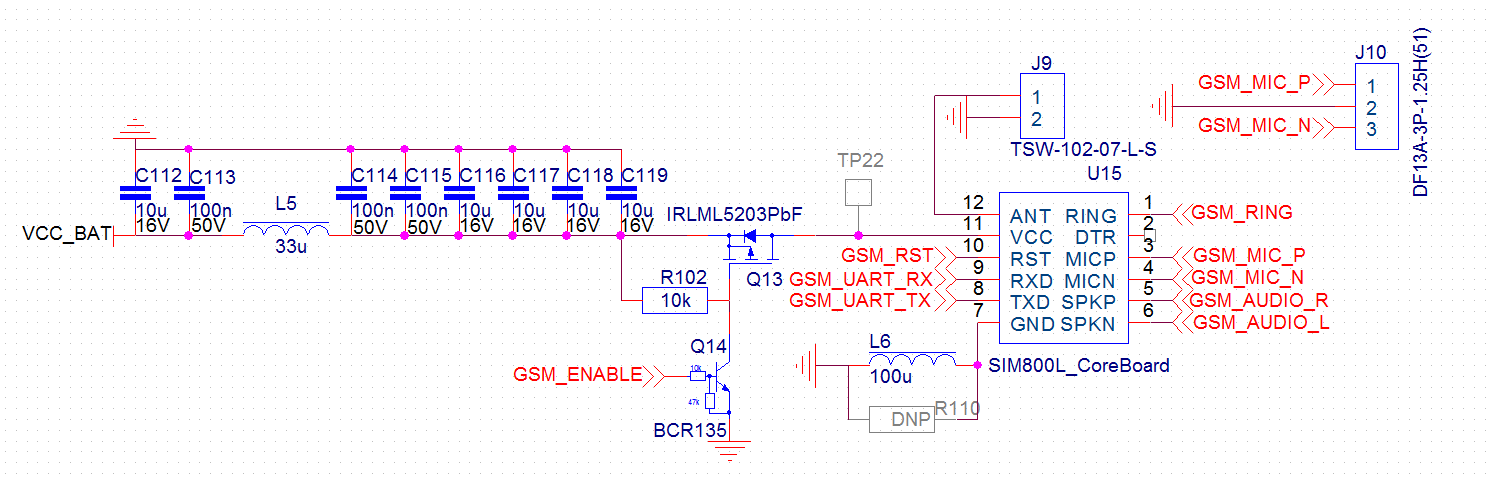

    I am currently working with this module.
    I will not implement the service of incoming text messages until the coming month.
    Overall, the matter is quite simple:
    - You connect to the module via UART with arduino with parameters 9600/8 / n / 1
    - You communicate with the module using AT commands (you can find documentation on the Internet)
    - The module is quite demanding in terms of power supply and how many GSM modules generate a lot of EMC / EMI / AUDIO interference around them. It requires a power supply in the range of 3.7-4.2V and an instantaneous current efficiency of 2A.
    If you needed a printed circuit board to solder this system, the STM32 microcontroller would not hang on the wires, we will get along somehow. I have several laminates on sale ...
    Below I present a partial diagram of my implementation and the source code as such ... I am programming the STM32L152RE microcontroller.

    The module works for me without any problems with the 3V3 logic.

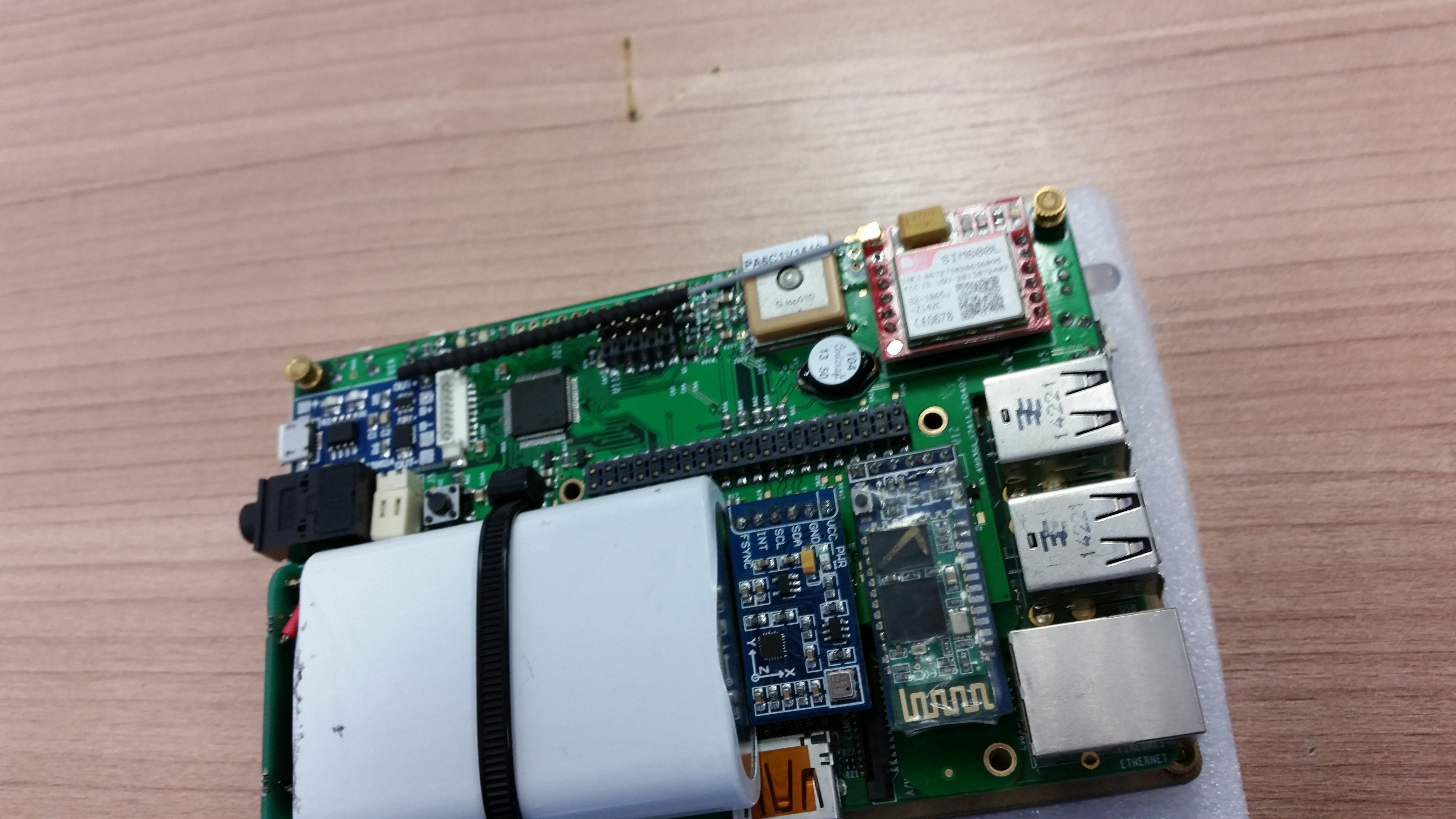

    4 layers, gold plating, double-sided solder mask and description. The dimension is 138x83mm I guess.
    This is what an already assembled module looks like:

    What you can see in the pictures is a complex prototype that also includes a gyroscope, accelerometer, compass, bluetooth, raspberry pi, GPS and a GSM module. Each of these components is optional and the microcontroller will go without them.
