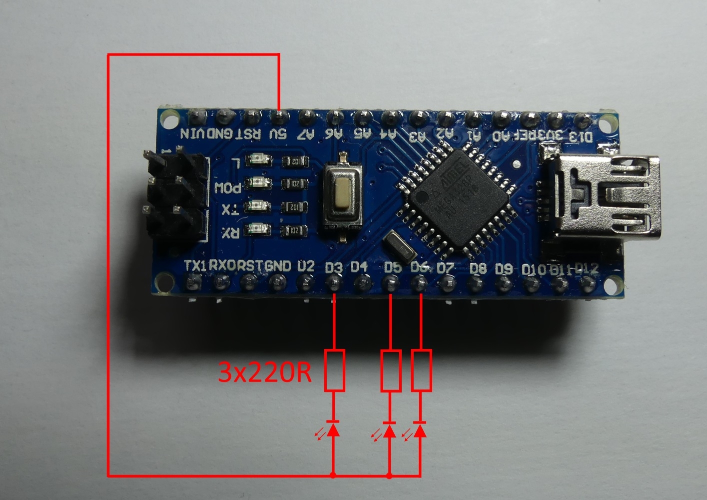

    Flashing RGB LED.
    Connect the LED GRB cathode to D3, D5, D6 through 220R resistors, and the common anode to + 5V and with PWM we can smoothly mix the light colors. As the LED is connected with the anode to + 5V, the PWM 255 filling will mean the LED will go out.
    Arduino nano - first run, test, opinion.
    Code: C / C++
    [movie: 88fd792b6d] https://filmy.elektroda.pl/5_1505668880.mp4 [/ movie: 88fd792b6d]
