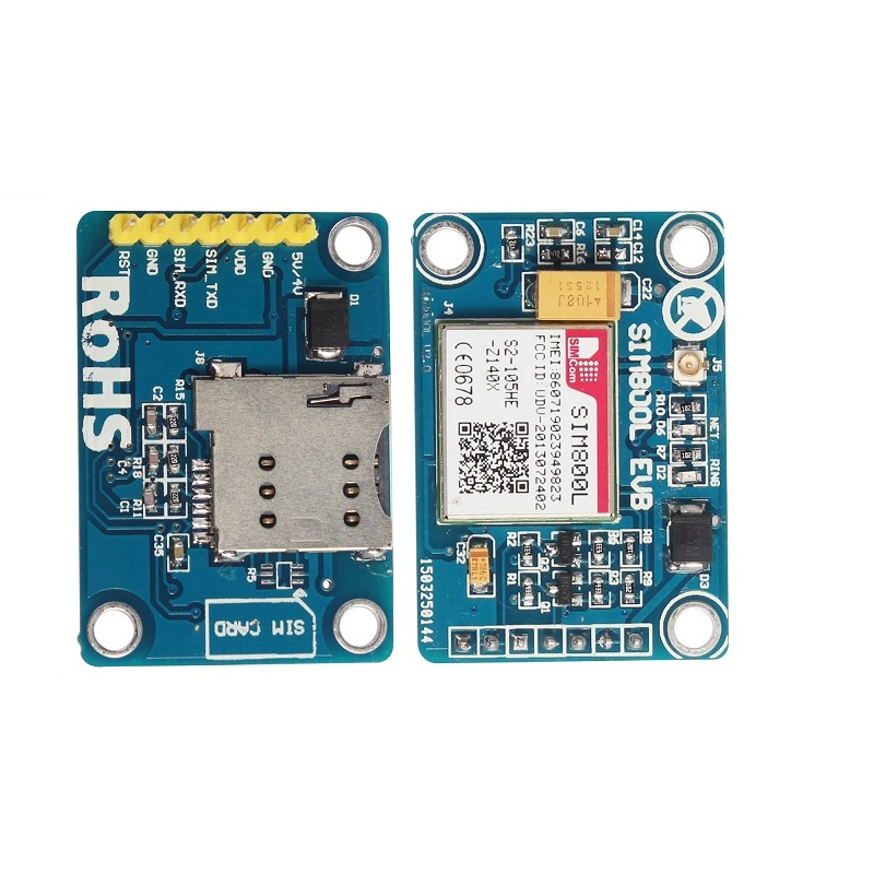

    There are plenty of topics on the internet about the SIM800L itself. I, on the other hand, have been sitting, reading and unable to bring the 800L to life for the last 3 days.
    What I have:
    - Arduino Nano BLE 33 Sense
    - Sim800L:
    Arduino Nano BLE 33 communication with SIM800L - how to get the GSM module working? .
    - Sim800L v2:
    - Mains adapter 12V, 1000 mA
    - USB power adapter 5V, 2.4A
    - 18650 3.7V rechargeable batteries
    - Diodes, resistors, capacitors.

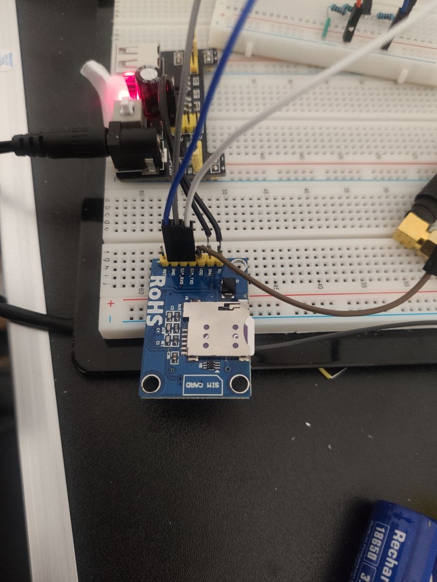

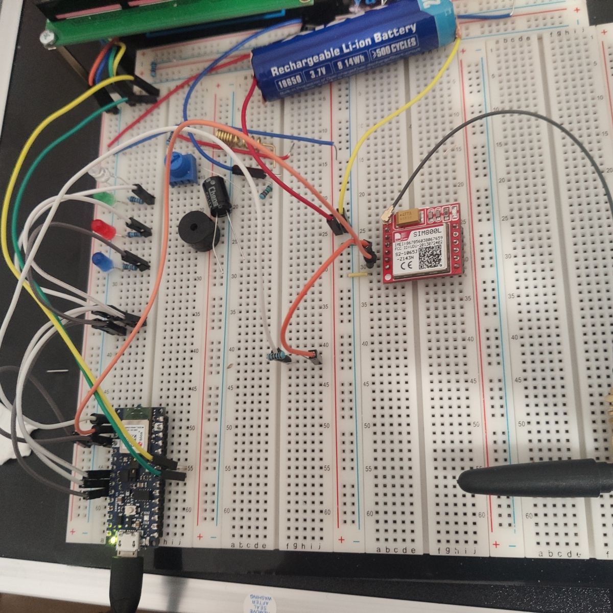

    So:
    Sim800L v2 (blue):
    Sim800L (red):
    For v2 I connect it directly to v5 and GDN from the power supply, SIM TX -> RX is at res. 1 kOhm. Here there are symptoms as if there is a problem with the power supply, as the GSM diode blinks 10x, a small pause and again 10x, etc.
    For v1 (red) I connect to a power supply independent of the Arduino, a 3.7V battery pack and a GDN. The rest as above. On this module the diode blinks every ~0.6s without interruption, continuously.
    I have the power supplies as in the 1st post. I am anxious to get any of these modules working, maybe this v2? I want a simple and concrete solution.

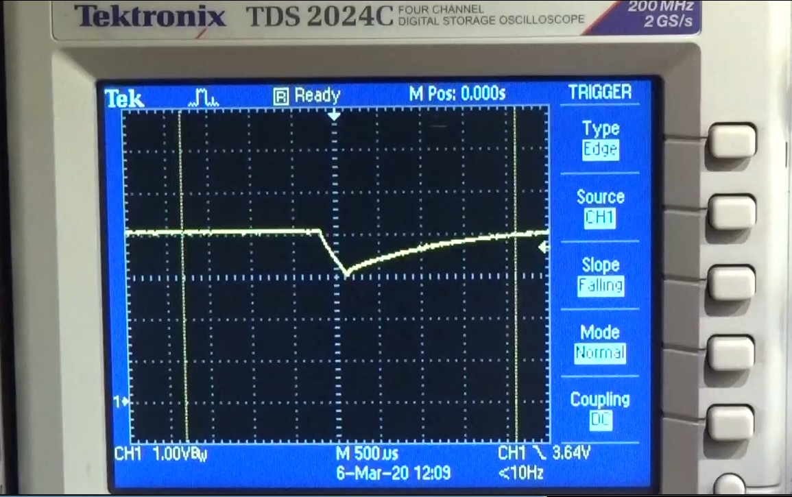

    A GSM module will not run properly on a contactor. Contact resistances are often several hundred milliohms.
    This is what the voltage looks like on the SIM808 modem, which is powered via the contact board when it connects to GPRS.
    These capacitors in the modules are not enough.
    After such an event, the modem does not respond to any AT commands or gives errors.

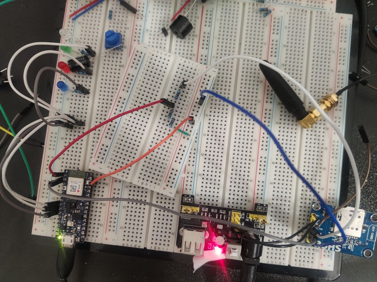

    This is what my current connection looks like: Arduino Nano BLE 33 communication with SIM800L - how to get the GSM module working? .
    The program I am running is the one in the 1st post. The simplest one possible. I'm also testing with AiThinker Serial Tool V1.2.3 and there too it doesn't respond to any AT commands.

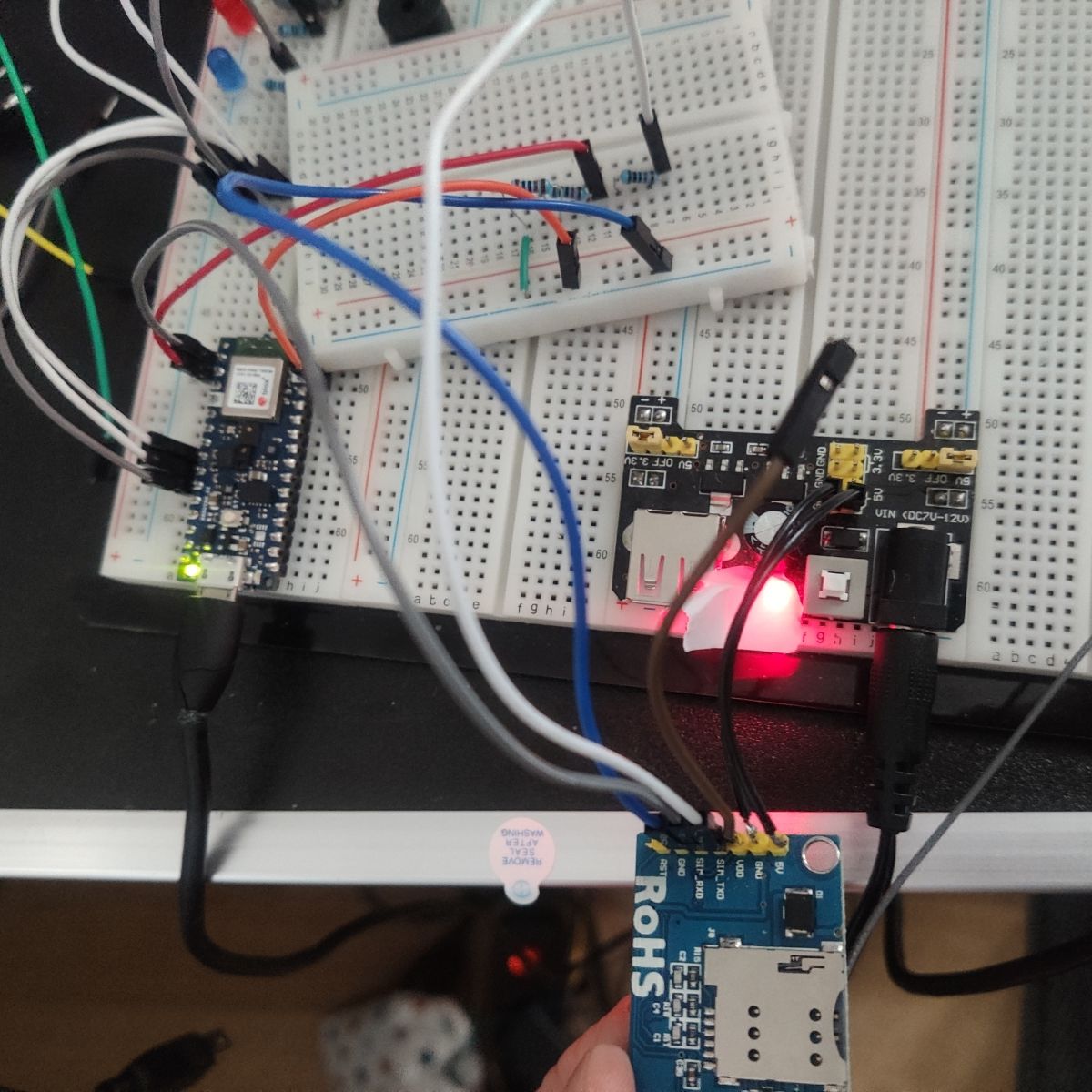

    Well you see, that's how I felt you would start with it, but just then my wife called me to the baby and I didn't edit the post to mention it anymore. While testing I have the card, I had to temporarily transfer it to the phone as I was taking the photo. Hence the lack of card in the photo. Photo with card:
    The resistors in the photo are 10k + 10k and 10k

    You have a good eye, but before you wrote I noticed it too and corrected it. This is a new picture, which shouldn't be questionable. I'm not strong with electrical stuff, hence my various mistakes, so far I've been coding games in CPP/C# and more recently I've been playing around a bit with Arduino.
    I've been wondering what's wrong with it, I'm wondering if it's because of the voltage difference, as the Arduino Nano Sense is 3.3V max, and the GSM module is powered by 5V, and the GDNs need to be connected. I don't know what the voltage difference on the serial ports is then. The current symptoms are that when I connect the GDN's, sending any command I don't even get a print of the command in the serial monitor, and when I disconnect the GDN's I get partial bushes, truncated command prints followed by bushes, the cause of the resistors from what I noticed.
