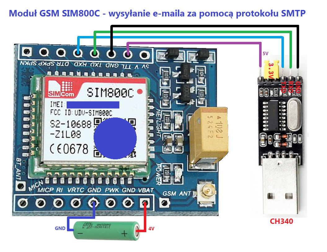

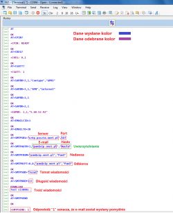

    I did a test of the GSM module SIM800C , which I used to send an email using the SMTP protocol. During the test, I sent AT commands to the module via the YAT terminal, and the whole process can be seen below. To summarise, I will write that I sent the email using the outgoing mail server smtp.poczta.onet.pl on port 587 (without SSL encryption).
    Connection diagram.
    SIM800C GSM Module: Sending Email via SMTP on Port 587 Without SSL .

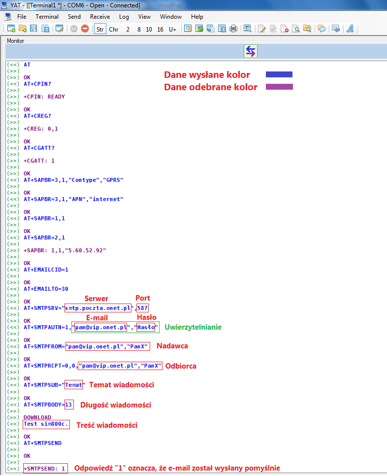

    AT commands sent.
    Spoiler:
    Code: HTML, XML

    There is a dialogue going on with the mail server i.e., every message sent has a response - see if there are no AT commands to see these responses - "OK" is not a server response, rather a confirmation that something has been sent.

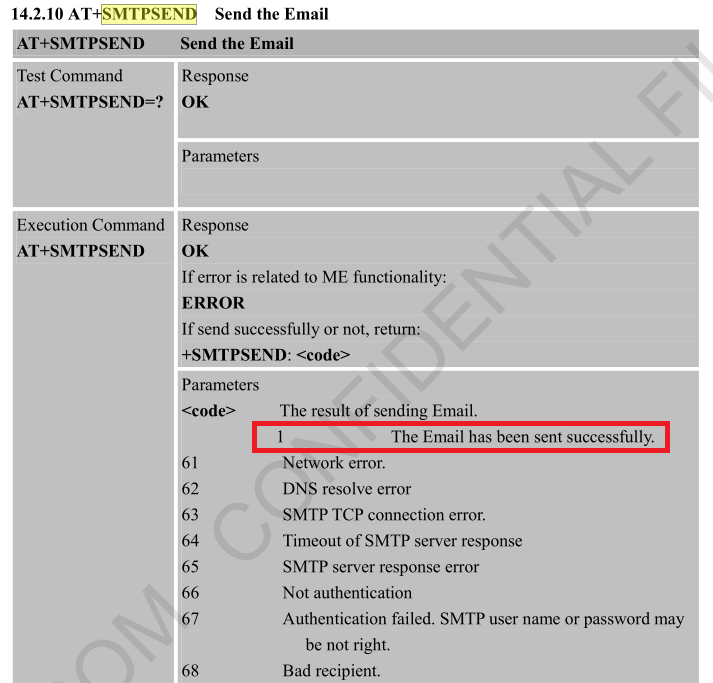

    Confirmation that an email has been sent is the response +SMTPSEND: 1 .

    Have you checked the response (dispatch confirmation) if you enter intentionally wrong authorisation data? Is it also always "OK"?

    krzbor wrote:
    Have you checked the response (shipping confirmation) if you enter intentionally wrong authorization data? Is it also always "OK"?
    If I enter incorrect authorisation data then the module returns OK , followed by +SMTPSEND: 67 .

    That is, communication and authorisation is OK. Rather, the SMTPSEND result can also be trusted. This leaves the problem of the SMTP server rejecting such a message. Servers can verify the "FROM" with the real address (account) - in your case, however, there is a match. Maybe it doesn't like sending to itself? If you have access to another SMTP server then you can check another server.
