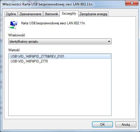

    But no, because I have other drivers besides the network card driver - I don't know how to find it. Screen is visible, where instead of the model the network card is written
    "USB 802.11n Wireless LAN Card"
  • #4 16560529
    czareqpl
    Posts: 1955
    Help: 196
    Rate: 580
    Then see what the equipment identifiers are and write them here. You will find them in the properties ...
  • #5 16560552

  • #7 16560596
    Syrkus
    Posts: 9
    System: Windows 64 bit Professional
    Ethernet controller:
    Ethernet Cable Not Detected: Network Card Driver Issues & Virus Removal - SlimDrivers Tool
    USB 802.11n wireless LAN card:

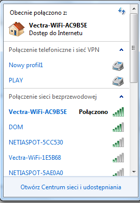

  • #11 16560691
    Syrkus
    Posts: 9
    It doesn't work - like everything is fine but ...
  • #12 16560694
    Kolobos
    IT specialist
    Posts: 85181
    Help: 17174
    Rate: 10460
    But what? The card is installed, did you get the address from dhcp after connecting to the router?
    Why do you put screen with wifi networks?

    You should decide whether you want to connect via WiFi (as now) or via cable.

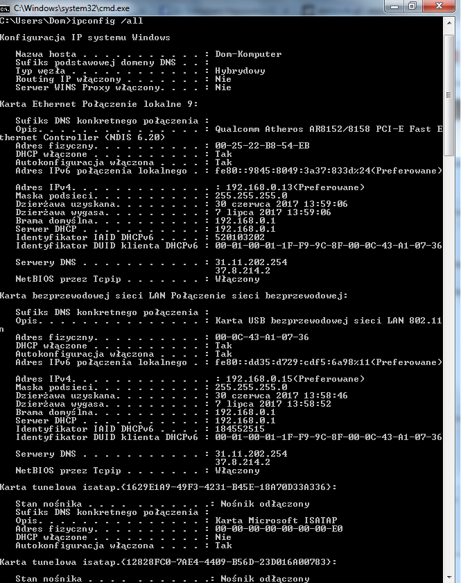

    So why are you doing this? Suddenly it occurred to you that you need to connect to the network via a cable instead of wifi?
    Have you connected the cable to the card and the other end to the router? If so, replace screen with the result of the command: ipconfig / all
    Run the command in the cmd window.
  • #16 16560743
    Syrkus
    Posts: 9
    Because I have lags via wi-fi. I have so-called mushroom on the balcony, which searches for wi-fi, and that my computer is far from the balcony, this is a weak signal.
    Yes I did
  • #17 16560752
    Kolobos
    IT specialist
    Posts: 85181
    Help: 17174
    Rate: 10460
    The screenshots show that the card got the correct address via cable, everything should work. Of course, disconnect from the WiFi network beforehand.
  • #18 16560763
    Syrkus
    Posts: 9
    Okay, it works, thanks a lot! Thanks to your help, I was able to install the drivers. Thank you again!
