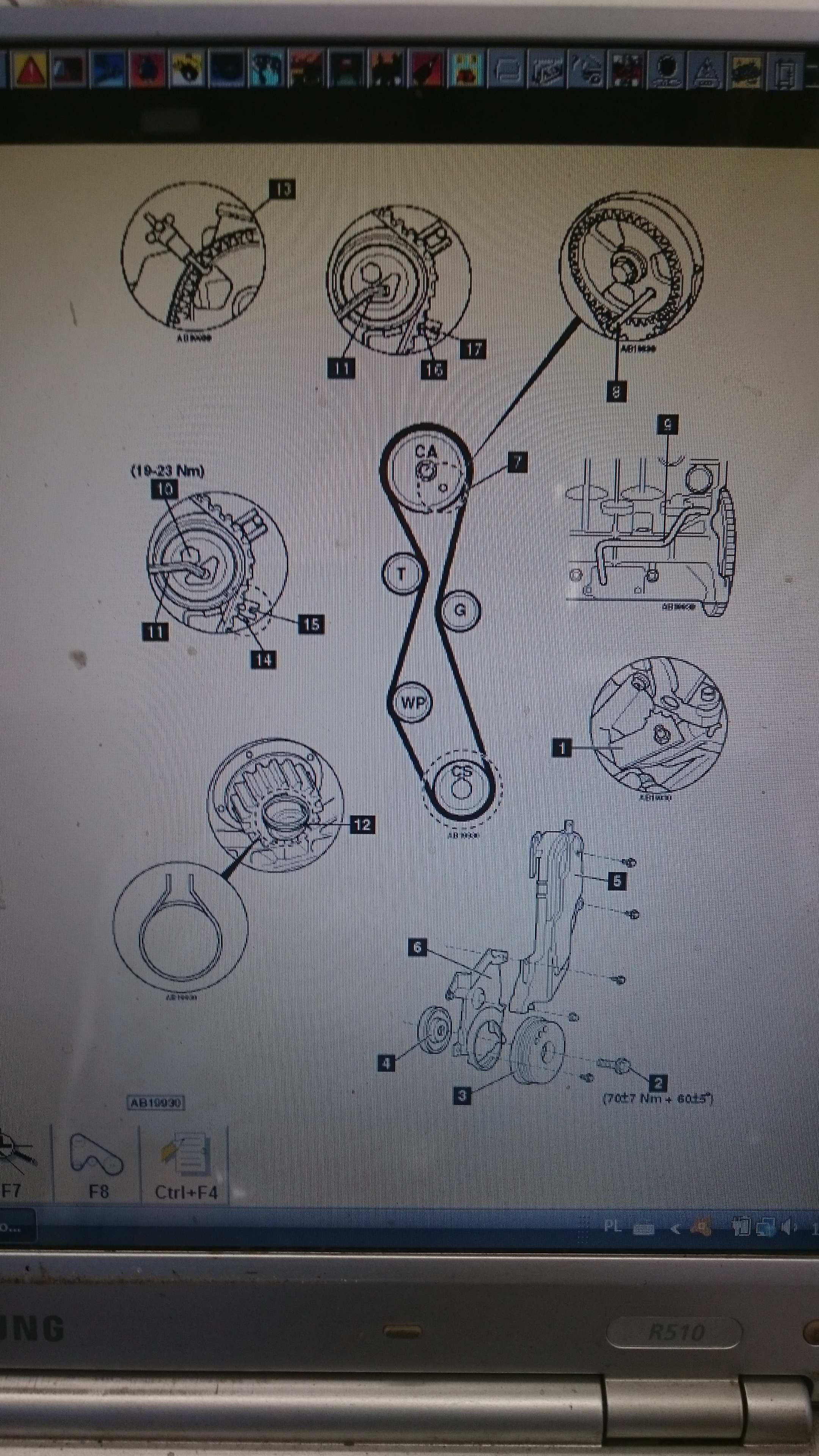

    I have a question, what time does the RHK engine change in it.

    180000km/60miesięcy - autodata

    Do you have a diagram for mounting this timing?
    Because in my autodata there is no RHR and RHK.

    Yes, quick photo Fiat Scudo RHK Engine: Camshaft Replacement & Change Time Discussion
