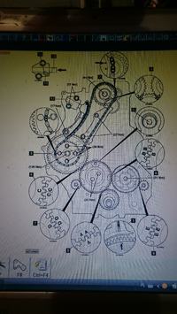

    Hello, does anyone have a timing diagram for Renault Mascott 3.0 dxi. I have to take off the head, because I think it burned the piston and throws the oil out with a bayonet. Best wishes and thanks in advance.
    #2 16209676
    mario 77
    Posts: 510
    Help: 66
    Rate: 335
    That's how I took a photo quickly. Timing Diagram for Renault Mascott 3.0 DXI 156hp - Head Removal & Piston Burn Issue

    Thank you very much, and I still have a question, do I have to remove the oil pan to remove the timing cover?
    Added after 8 [minutes]:
    Or maybe some of you colleagues had such a case in Mascota that it spits out (pours out) oil with an oil level meter?

    Measuring the compression would be worth it before disassembling the head. Then you are sure.
  • #7 16210420
    mario 77
    Posts: 510
    Help: 66
    Rate: 335
    I would also not pull the head without checking the compression. What about this driver? Has there been any errors - a problem with one cylinder? Auto going normally?
  • #8 16210437
    osimus
    Posts: 8
    Rate: 7
    The car has been downloaded on a carriage, the computer is not boring, there is less compression on the second and third cylinders.
  • #9 16215463
    osimus
    Posts: 8
    Rate: 7
    Hello, mascott spread out and it turned out to be bursting at the second piston (I saw cracks but so that the oil bayonet was going the first time) Thanks for the information and hints. I think it's closed.
