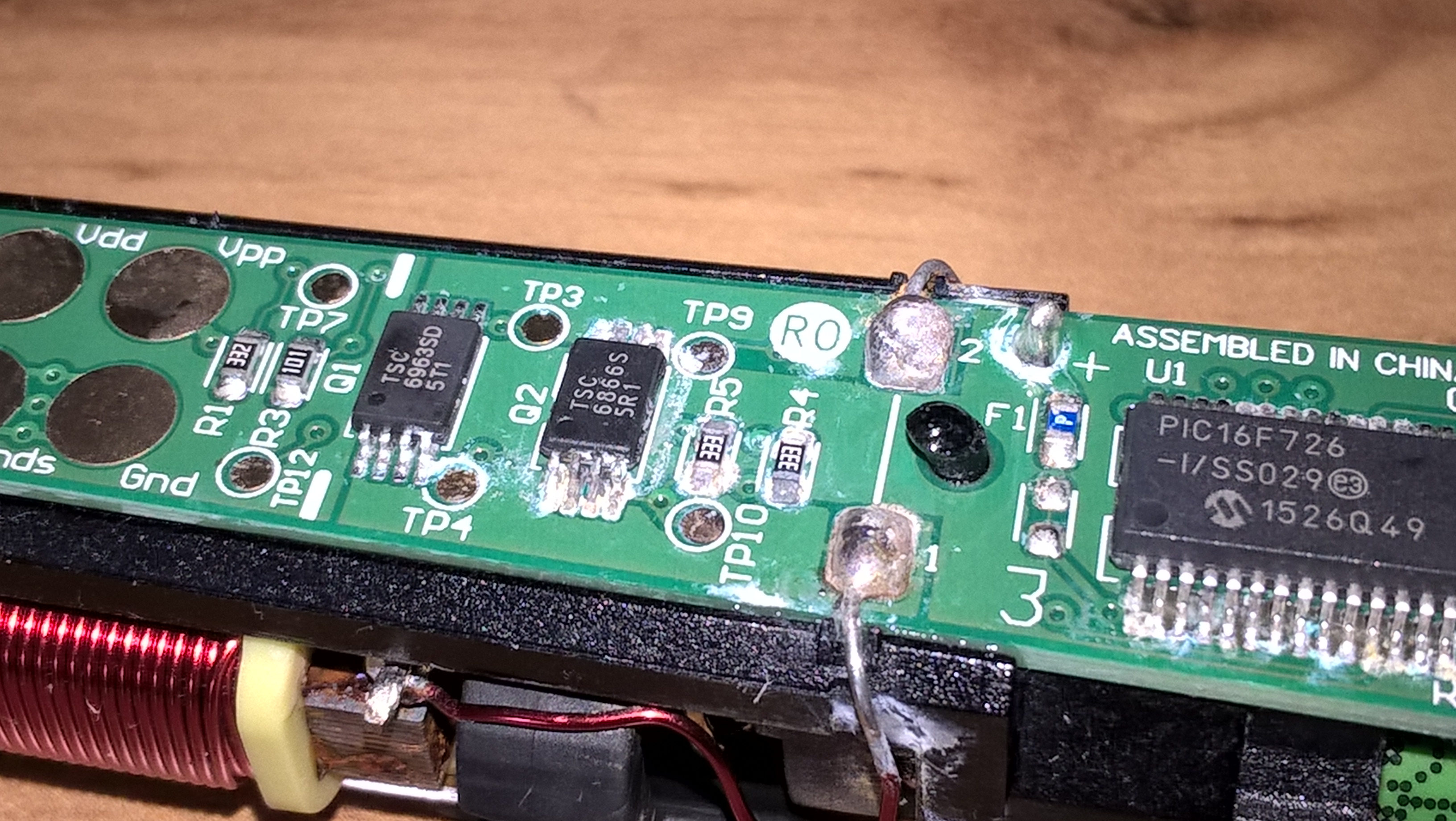

    Here is the last of two brushes that fell in the same way - from water :)
    The funny thing is that it's almost equal to the end of the guarantee. If any of you have one, I recommend opening and drying it because water is collected which destroys it over time.
    We open them by lifting the lid on the bottom of the brush, which should go out without a problem.
    Then we clamp the casing from the narrower sides and push the entire chip from the top.

    I have been using such toothbrushes for at least 14 years. The first one served me for about 10 years and is still running, but without a rechargeable battery. It is powered from the power supply and is used to clean various trinkets. At that time she was cleaned several times. The second one has been used for about 8 years and has not been dismantled yet. When cleaning my teeth I try to keep it in a horizontal position. After brushing my teeth I always rinse the brush (tip) under the water, take off the tip, and from the support of the drive shaft, shake the water by flicking the brush body several times.

    Unfortunately, these Philips are a sell. In the first versions, this rubber bellows rubbed between the metal vibrating pin and the brush. As a result, the water was coming in. Of course, Philips does not offer any brush parts, because for what.
    In later versions, they put a plastic cover on the elastic band and the problem was significantly reduced.
    I have already patched this electronics 4 times.
    In one of them fatigue of the material in the vibrating blade and burst ...
    Do not put it vertically, because the water pulls through the thin O-ring from the bottom and floods the electronics, which of course is not even painted. Therefore, the brush should be placed horizontally, and the o-ring should be cleaned and smeared with Teflon grease once in a while.
    In total, I made one of the three brushes, which has been amazingly working every day for 2 years.

    in my crack a gasket and water got under the PCB.
    Etched eyelets at:
    - button
    - driver H
    - processor
    After soldering the 0.25mm wire into the vias, soldering on both sides and replacing the gasket, the brush opened.
    Seals are on Allegro for PLN 28
