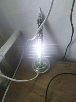

    The toothbrush probably fell after being knocked onto the floor by the cat. After opening it, it was wet with water. The battery lasted for about 2 weeks when I brushed my teeth 2 or 3 times a day. However, the toothbrush does not work. The only positive symptom is that when the toothbrush is connected to the charger, the diode lights up. Any tips on how to get the toothbrush to work?
    Philips Sonicare Toothbrush Not Vibrating After Fall and Water Exposure Philips Sonicare Toothbrush Not Vibrating After Fall and Water Exposure Philips Sonicare Toothbrush Not Vibrating After Fall and Water Exposure Philips Sonicare Toothbrush Not Vibrating After Fall and Water Exposure Philips Sonicare Toothbrush Not Vibrating After Fall and Water Exposure Philips Sonicare Toothbrush Not Vibrating After Fall and Water Exposure
    Edit1:
    After drying, the toothbrush placed on the charger began to charge, but 2 hours after charging, the vibration still does not work.
    Edit2:
    After 5 hours of charging, the white diodes disappeared and instead of a green diode there is a pulsating orange one.
    Does the LED light up when you press the button? It doesn`t make any sound?
    After a fall, the air gap on the coil may have disappeared and then it will not vibrate but a sound will be heard. I marked the gap in the photo. I set it to about 1 mm and filled the screws with glue to prevent the situation from happening again.

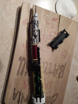

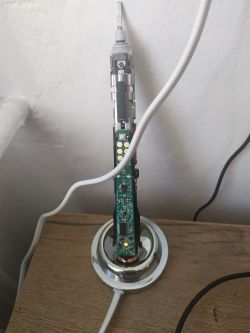

    I got to the toothbrush plate.
    There was dirt underneath, I cleaned it with isopropyl alcohol. I also replaced the battery. After replacing the battery, it turned out that the toothbrush was flashing white LEDs while charging, plus a green LED. When I pressed the button, the toothbrush vibrated once and then stopped. I heated the area around the button for a while with a LODERSTAR heat gun set to 300 degrees Celsius. After the plate cooled down, the toothbrush vibrated once again.
    I charged the toothbrush because the battery from the seller had a sticker stating that the battery should be fully charged. I left the toothbrush overnight. The white LEDs were on, plus the green one was flashing. And again, after 5 hours of charging, the orange diode appeared flashing. But when the button was turned on, there was a pulsating sound signal and white diodes.
    By doing this, you damaged the core of the programmed system. This is the manufacturer`s protection so that they do not replace the batteries and buy new toothbrushes.
    There is a JP1 jumper on the board near the charging coil, which had to be unsoldered when replacing the battery to protect the system against voltage loss.
    Perhaps on Russian forums you will find the charge and what programmer you can use to reprogram it, but it is not very profitable for a single piece.
