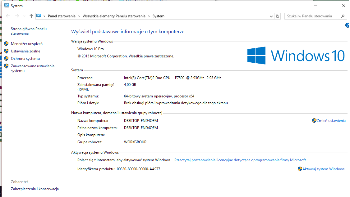

    1. I enclose information about the equipment. If they were insufficient (something was not visible - the report is generated by the trial version of AIDA64), please ask.
    2. How do I reset the BIOS? I have to start the computer, can I do it from the BIOS?
    3. Can I start with this bios, RAM test, HWiNFO, OCCT? If it is the fault of the power supply, can the tests be rather unreliable? I am asking because I do not have a meter and I will not be able to do the measurement myself, I am green in the subject of hardware, when it comes to some cables, etc.

    Configuration:
    ASRock G41M-VS3
    Core 2 Duo E7500
    2x DDR3 2GB 1333MHz
    GT9500

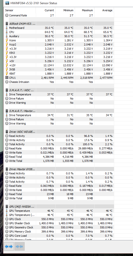

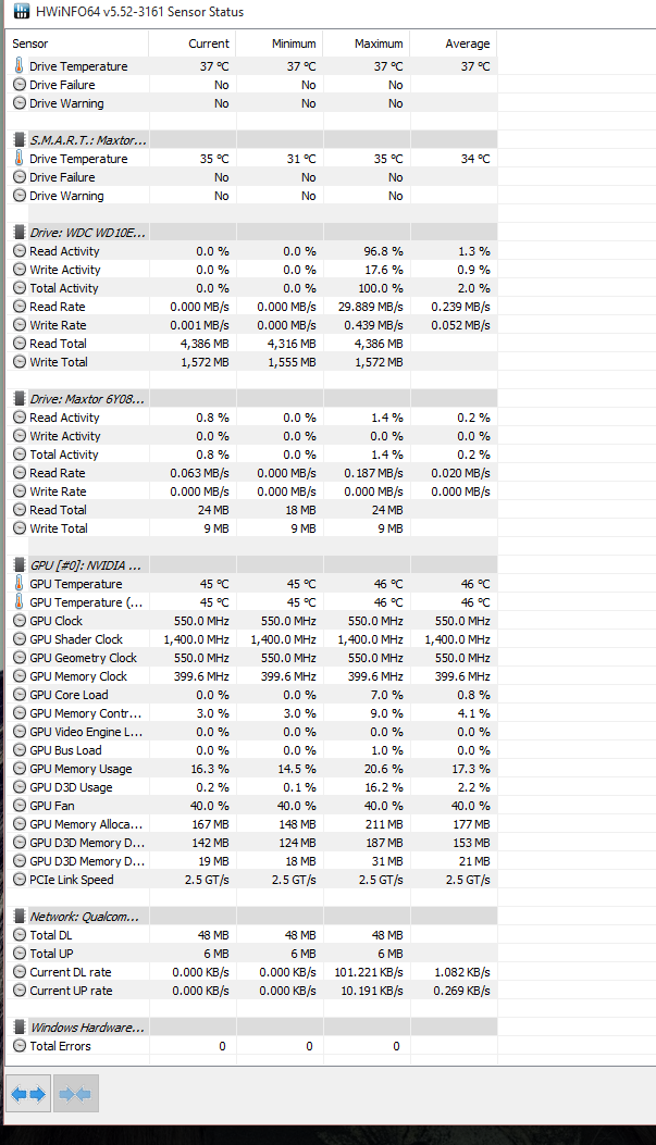

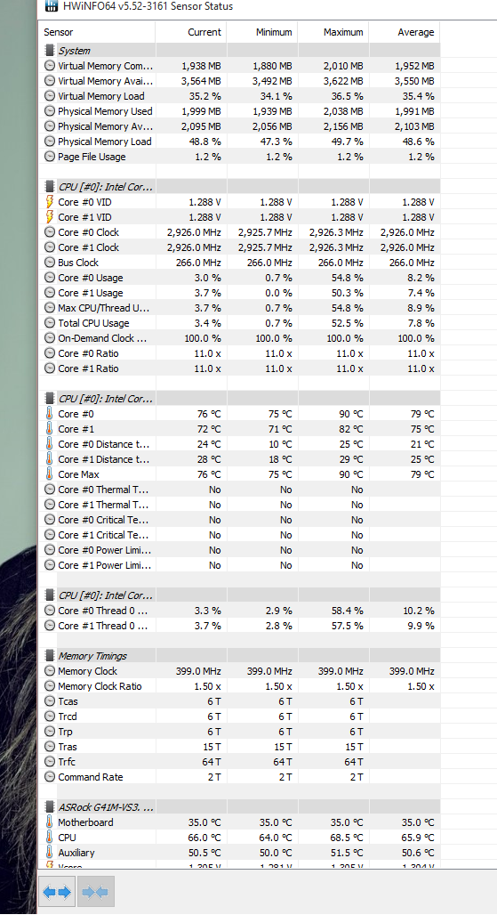

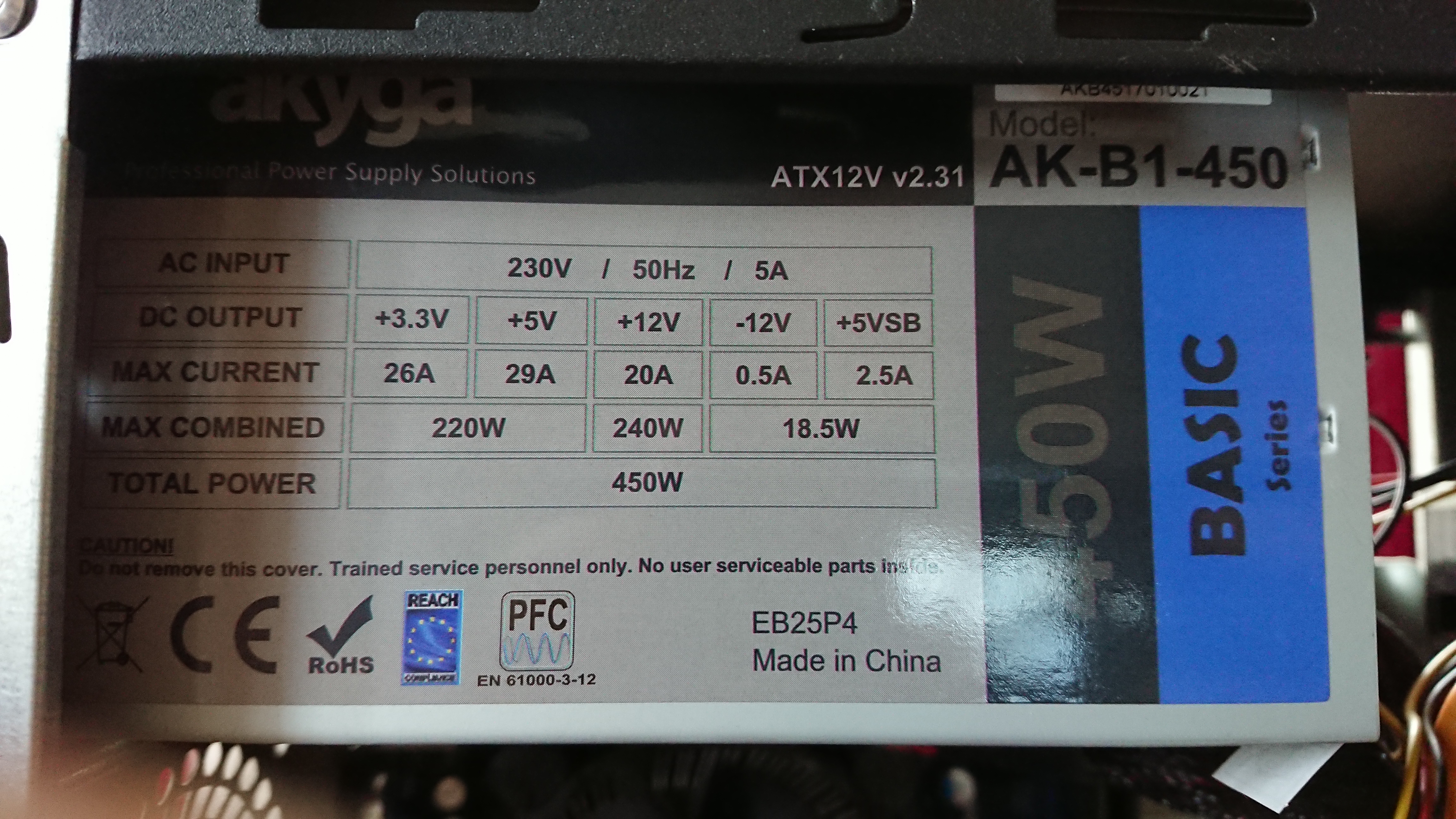

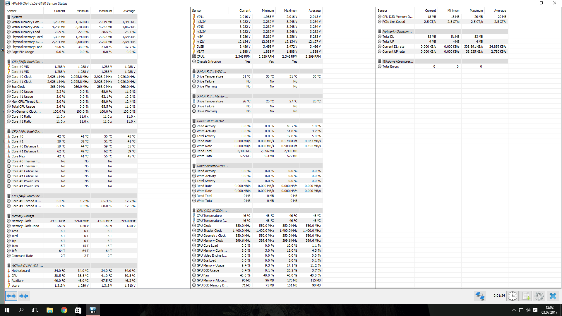

    I know the name of the power supply, because I mentioned it a few months ago: Akyga 450W AK-B1-450.
    I attach screenshots from HWiNFO (when using the browser and listening to music in Winamp).
    Then I will look inside the casing and throw in some photos.

    The CPU temperature is too high - replace the thermal grease and properly install the cooling. Probably not all pushpins are kept correctly / are broken.
    This is for garbage and not for powering a computer.
    https://www.elektroda.pl/rtvforum/topic3087862.html

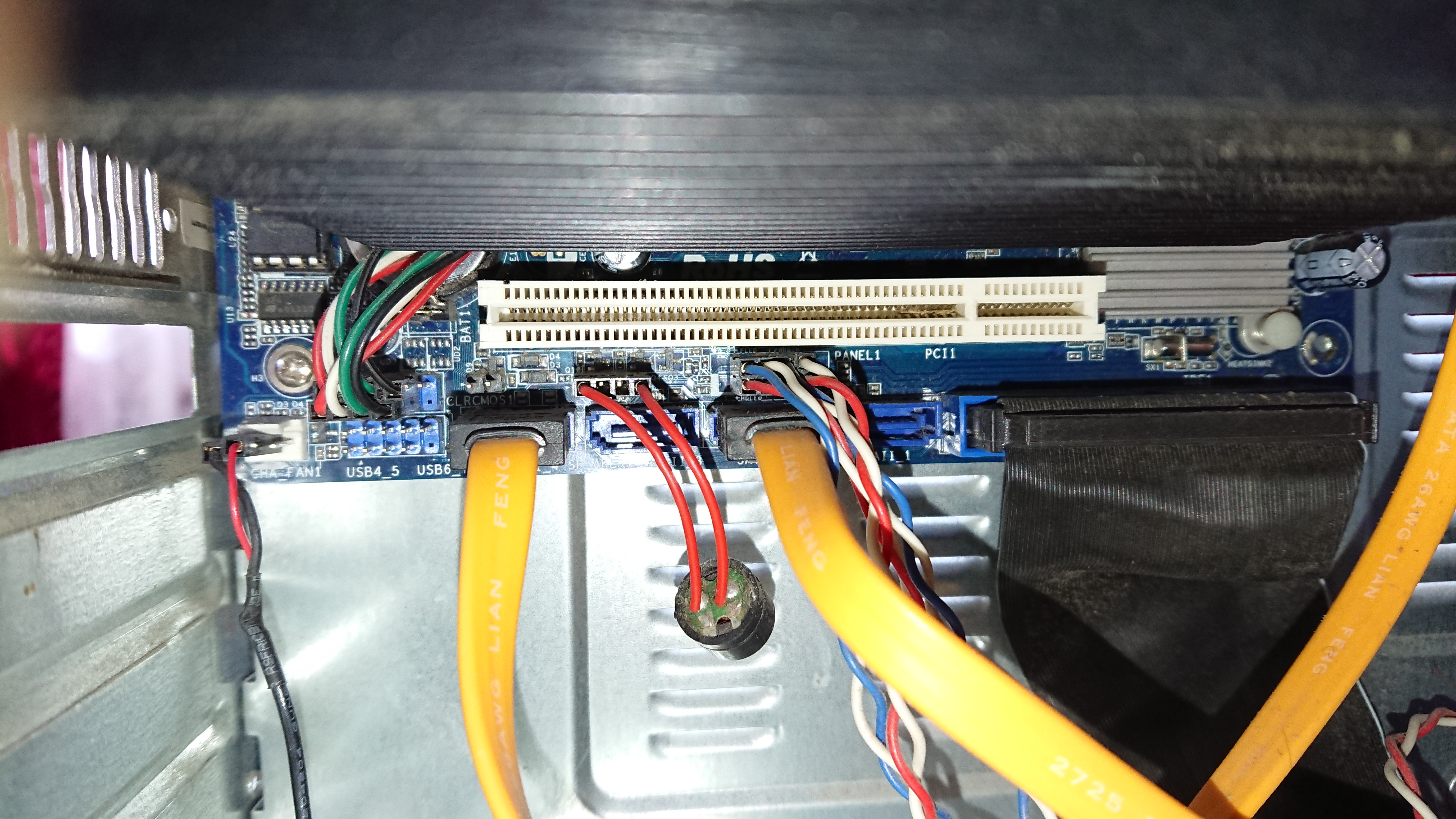

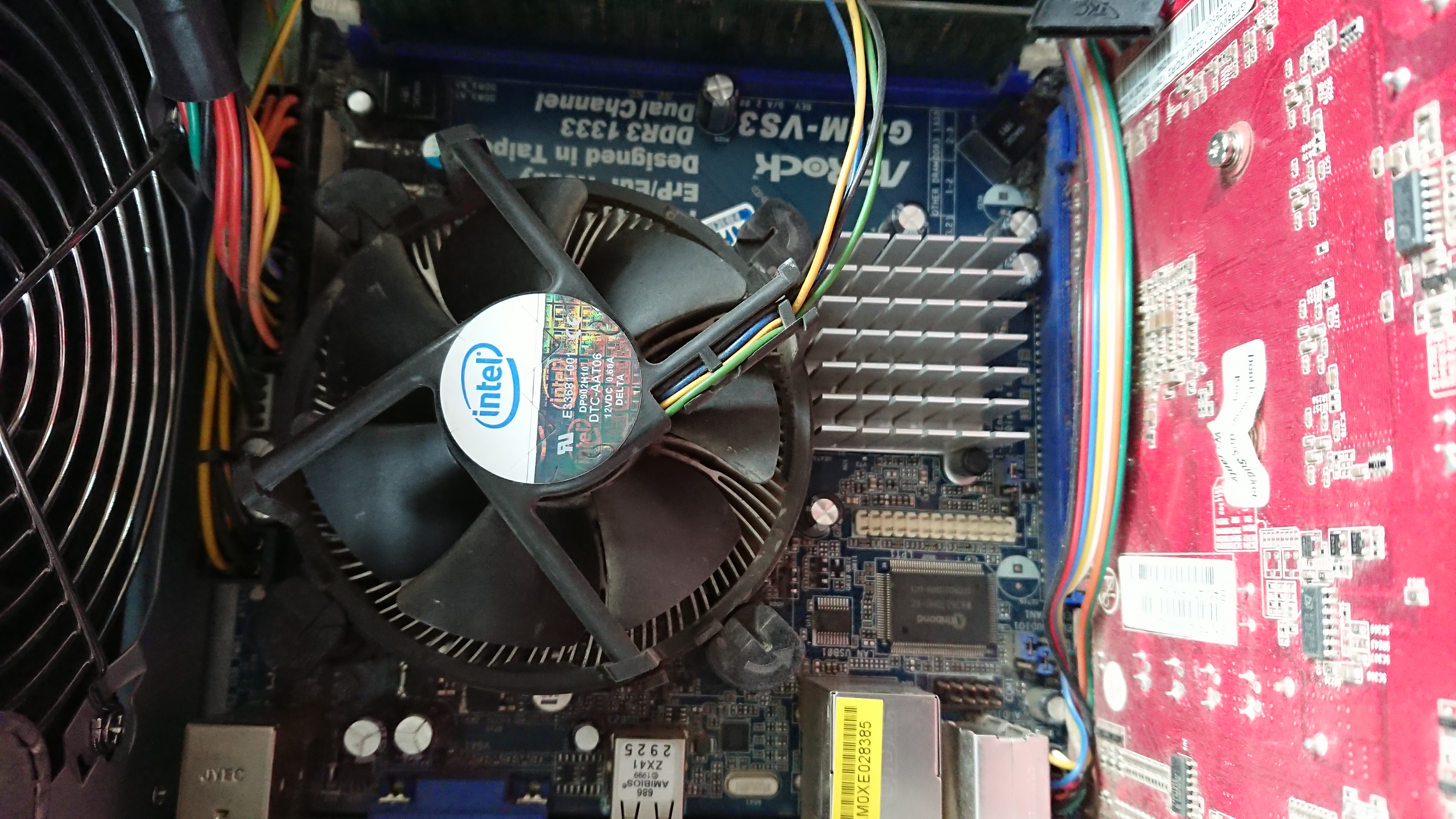

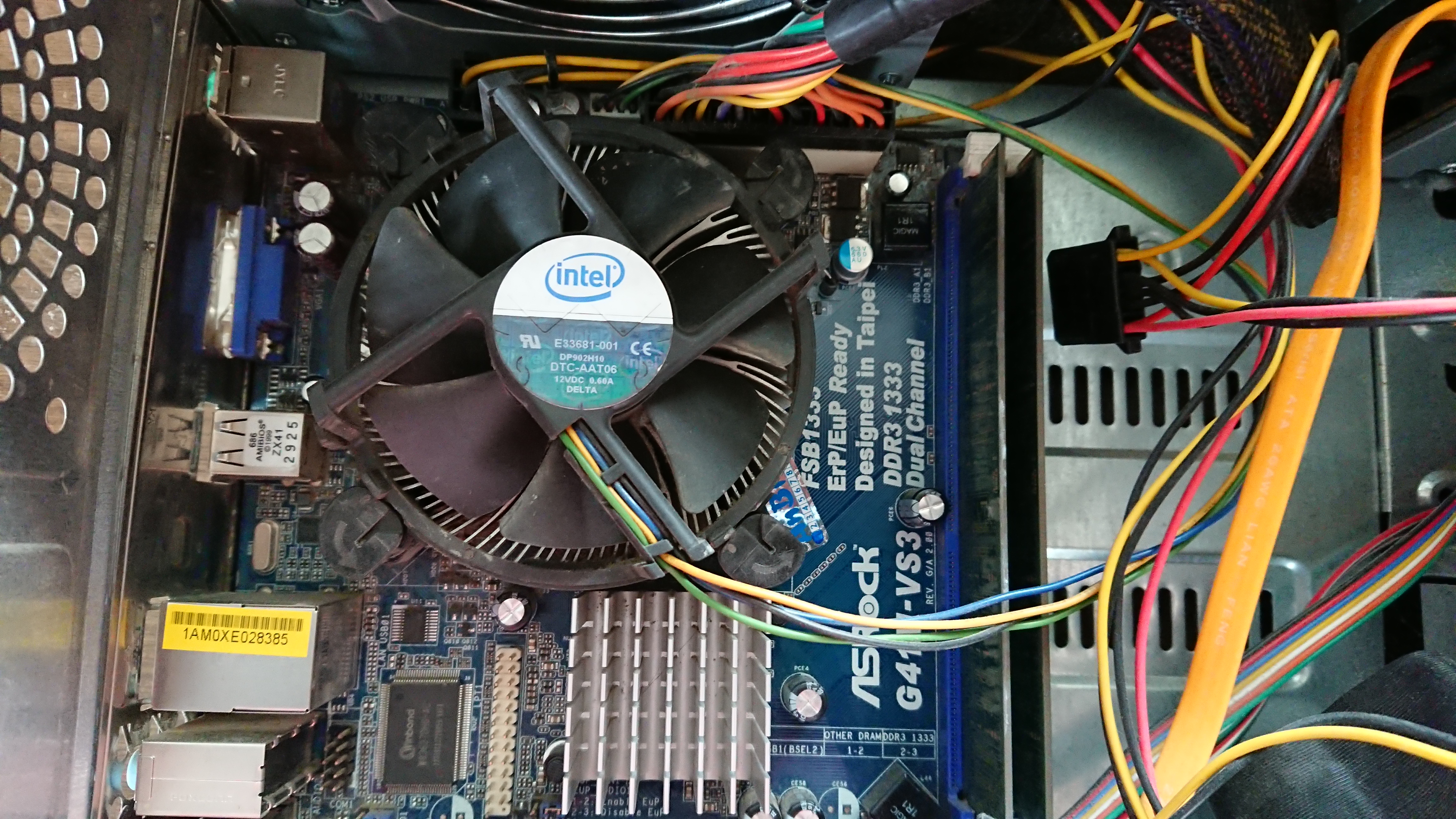

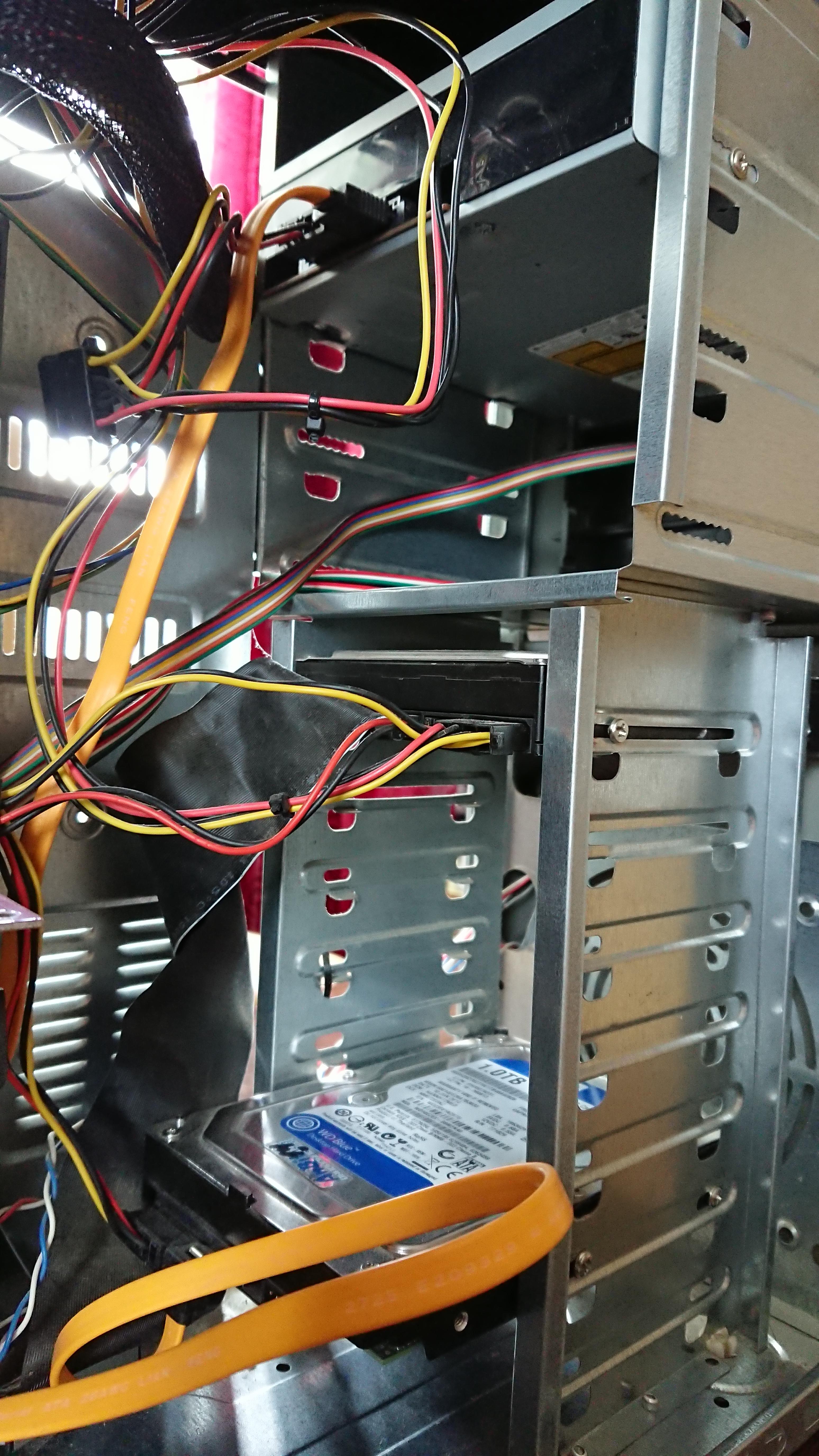

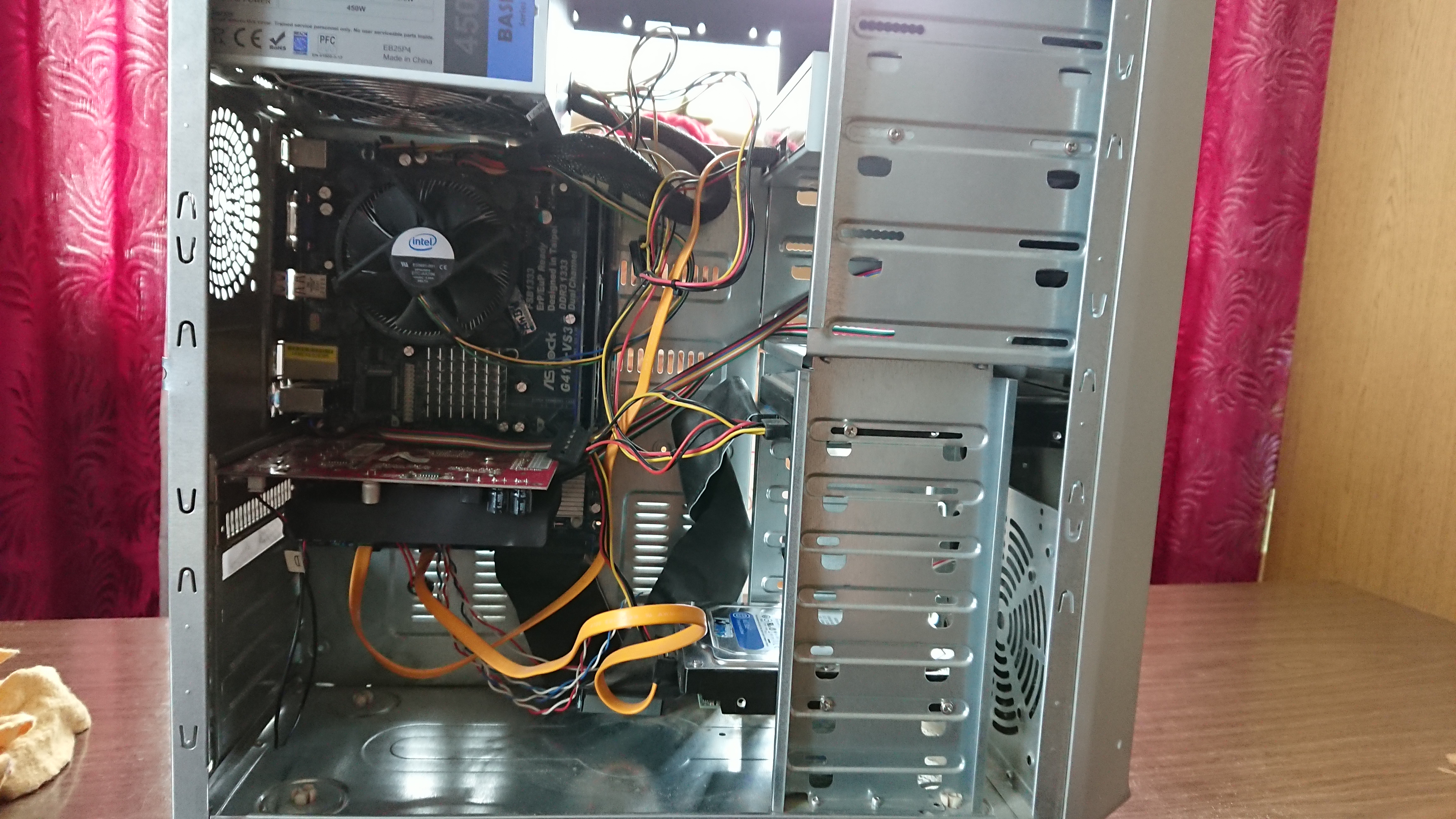

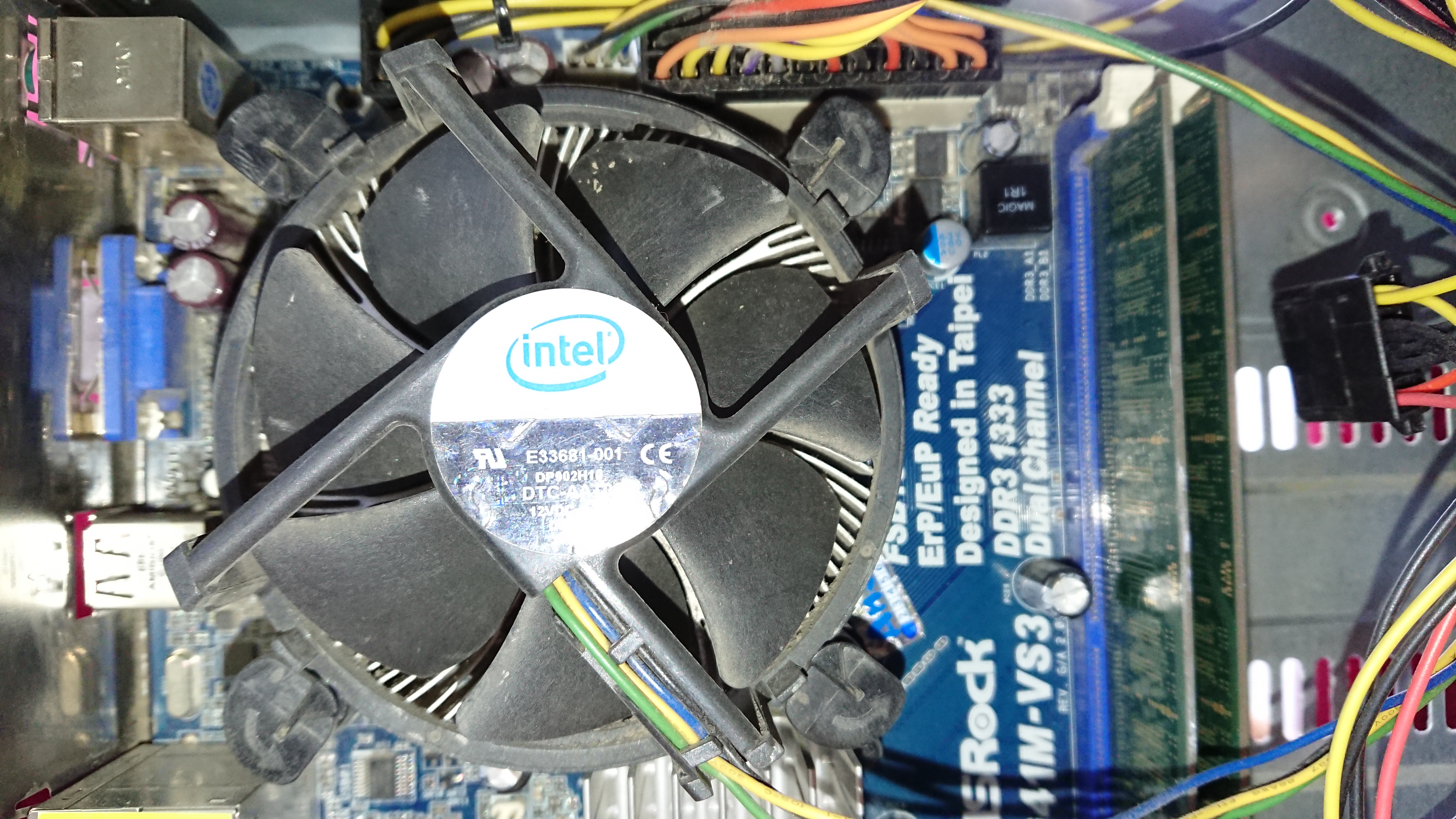

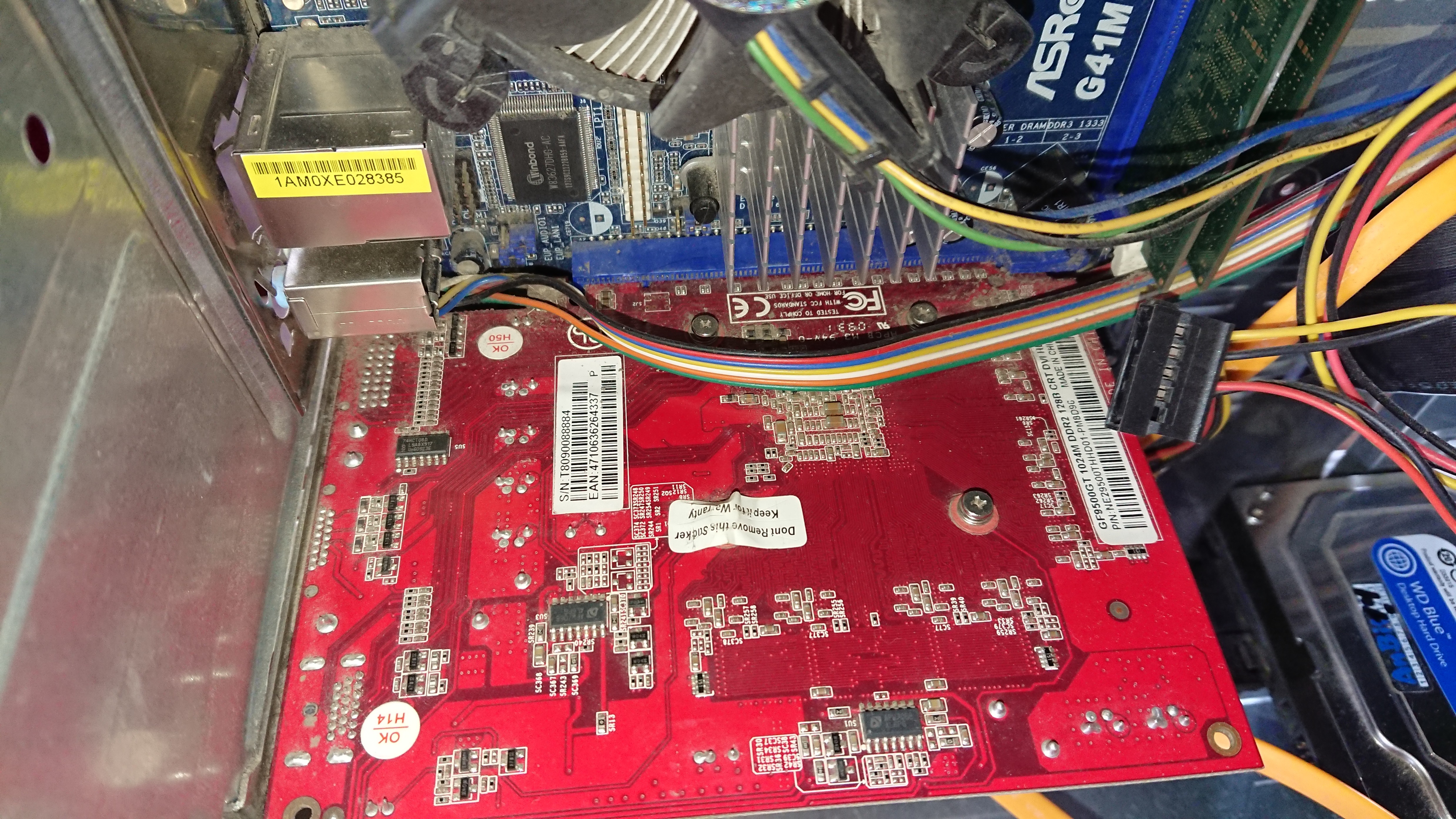

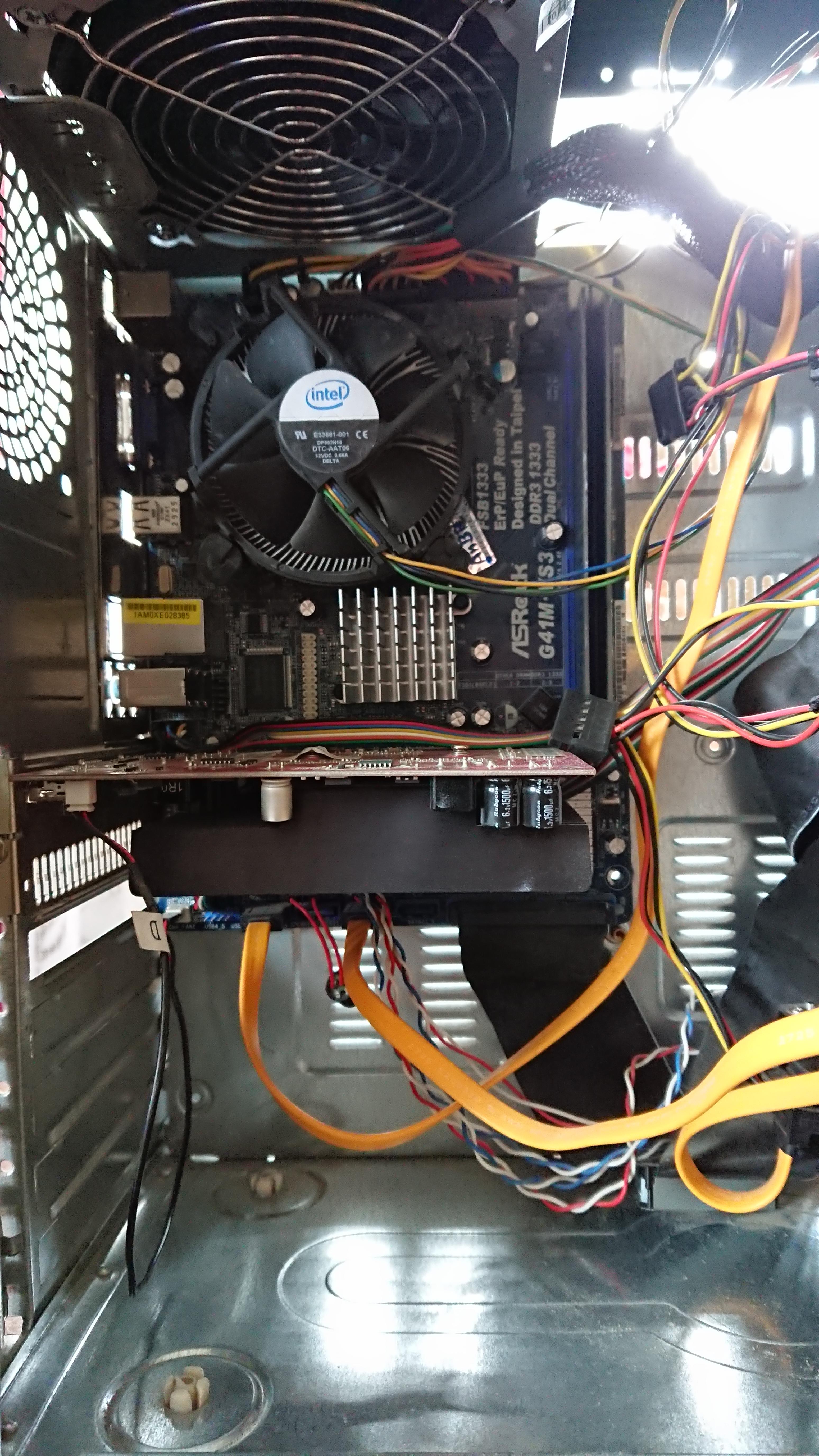

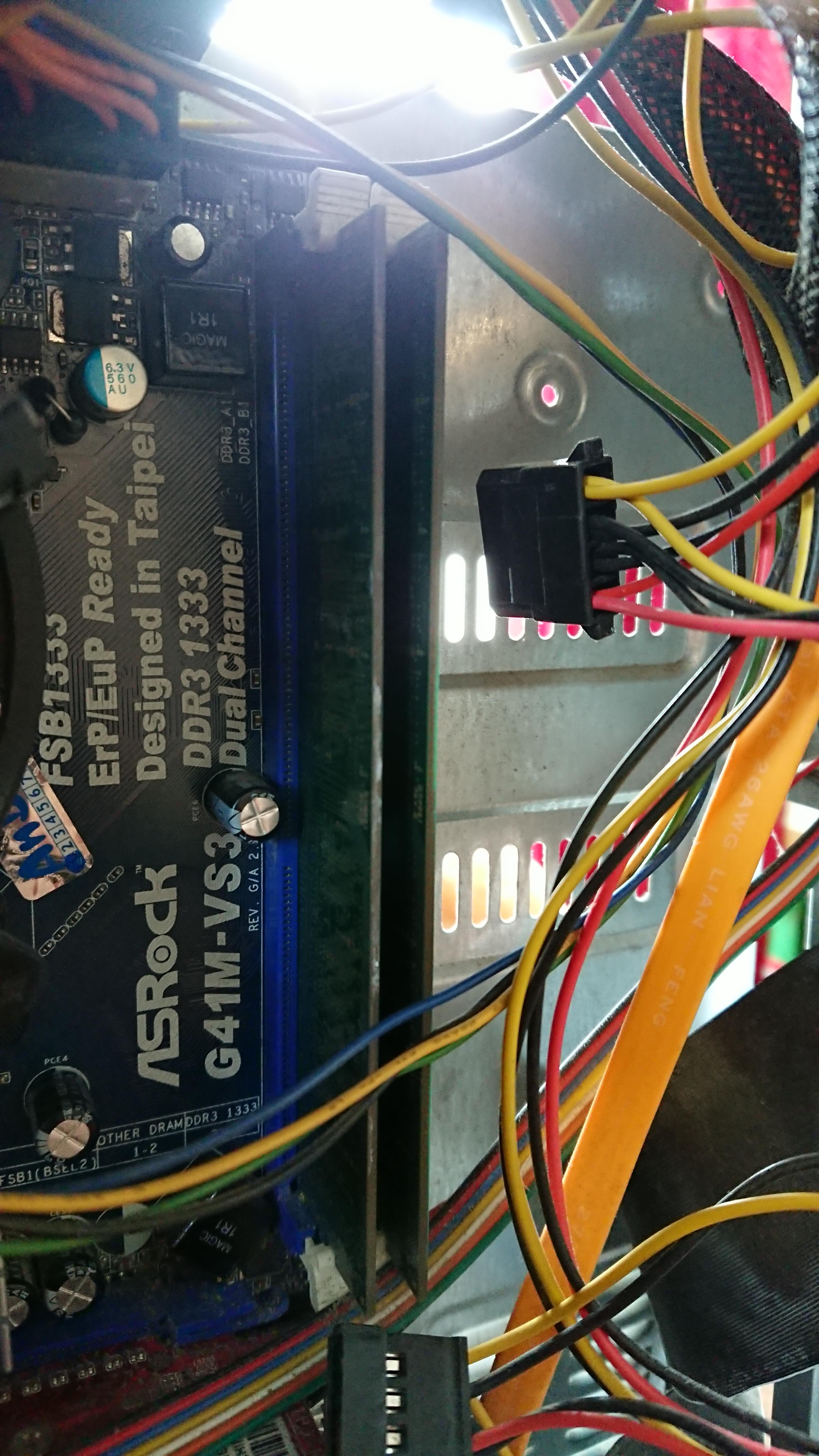

    I took the casing off and cleaned it a bit because it was a bit run down.
    I go to the computer to get the toothpaste and clean it a little more and see what the results will be.
    This is what it looks like inside:
    Windows 10 Blue Screen - IRQL-NOT-LESS-OR-EQUAL Error after 2 Years, Post-Upgrade from Win7

    Check your computer for viruses and change RAM. It is very likely that you have some crap in your computer, or you have corrupt / incompatible / wrong RAM. Overheating has nothing to do with it, not unless you have bad memory banks and RAM ...
  • #12 16567168
    310artur
    Posts: 9002
    Help: 980
    Rate: 670
    Piotr at 90 degrees is a cache in the CPU also gets away and gives BS similar to RAM.
    This computer is probably 10 years old and probably for a few years no one has touched this RAM. They could have fallen, but I doubt it.
    It looks good on a photo PC now. Take care of this cooling - 75 degrees is the absolute maximum for this processor and it is under full load and here it hits 90 degrees and half loaded. For the summer anyway, it would be worth investing in fans for the back and front of the housing. It will be cooler inside, it will also be easier for him.

    The computer is almost 8 years old, but about 3-4 years ago I replaced the motherboard and by the way I replaced the RAM, because the one I had now did not fit the new motherboard. Two years ago I also bought a new drive, and a few months ago a power supply.
    What fans are you talking about, can you send any links, price?

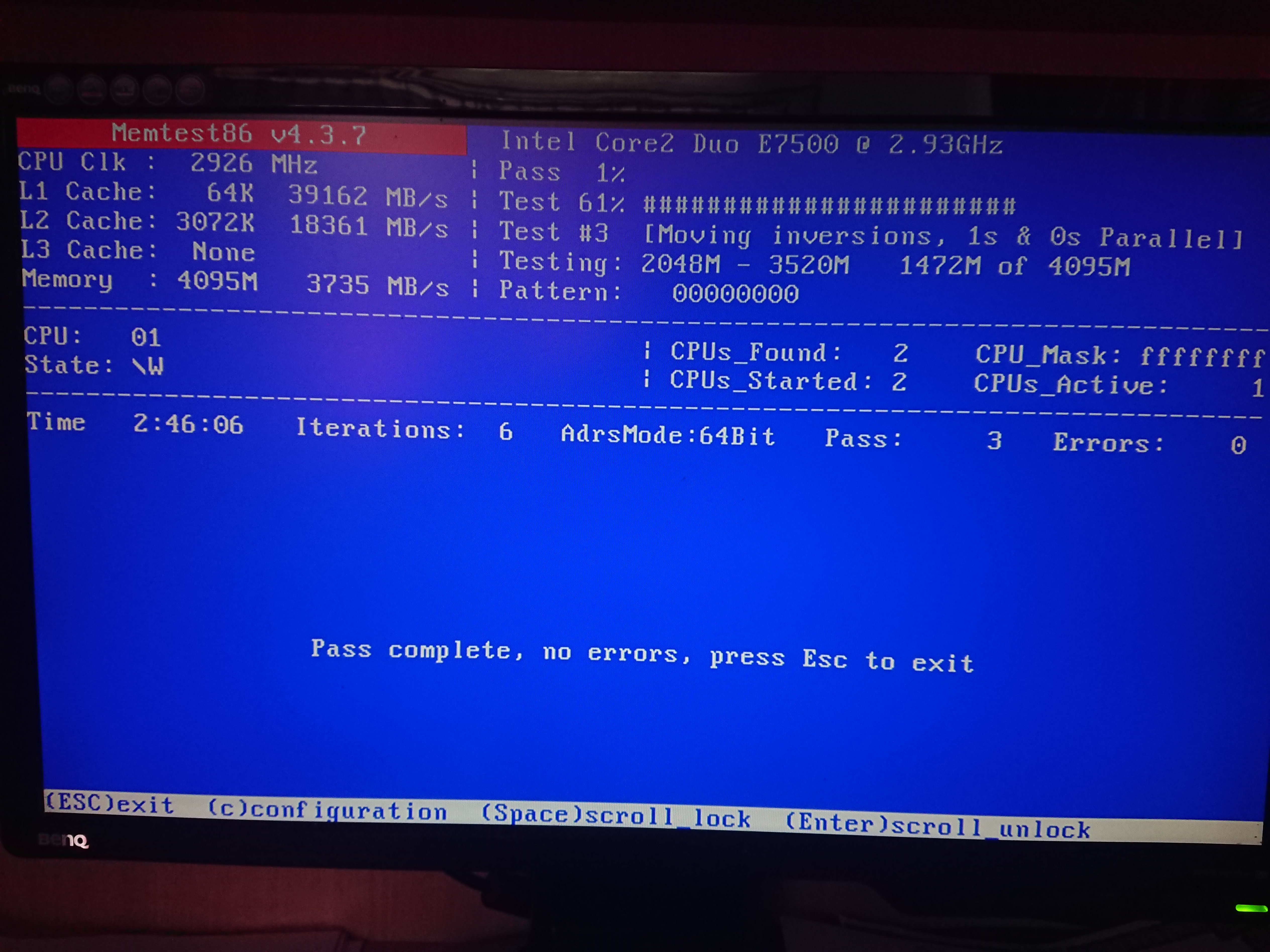

    I attach the latest screenshots from HWiNFO after cleaning the computer and replacing the paste. The temperature of the Prock had dropped significantly.
    I'm about to start the RAM test.

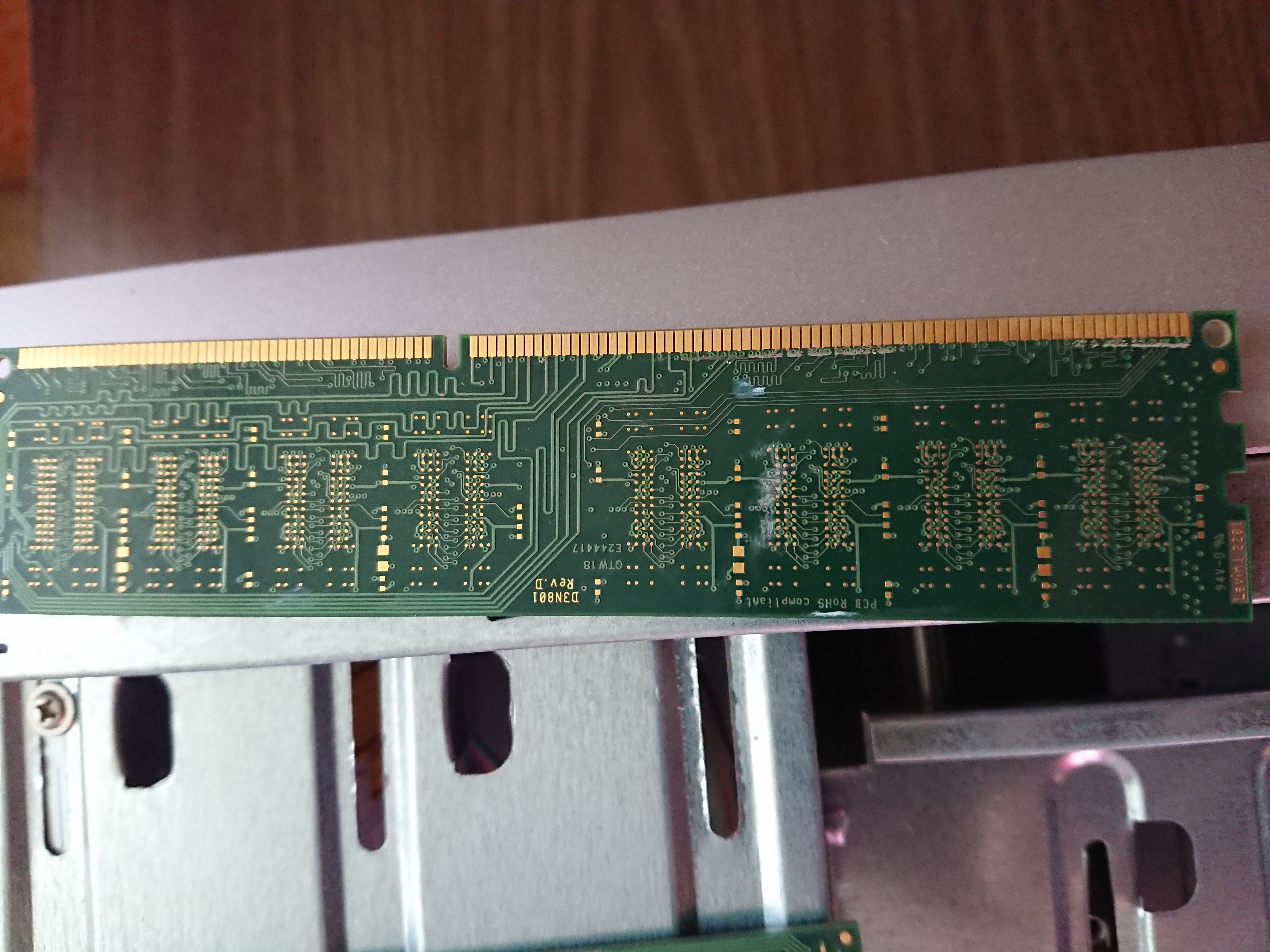

    RAM does not test, it only changes. All these software memtesters can be put into four letters because they don't always show damage. I personally, both here on the forum, and privately, I dealt with the situation where the computer was unstable, all the "Fachmen" said in a chorus to try. memtestem. This showed that it is ok and the effect was that the diagnostics came to a standstill and finally, after replacing the memory with 100% functional, the computer started to work stably ... I understand that not everyone has the option, but with the current prices of DDRII memory, I think that it's not a problem to buy a 512MB cube, take out all the bones, insert the 512MB and check on some undemanding Lnux live cd.

    1. This is DDRIII.
    2. Maybe you're right, but it doesn't hurt to do the test first. It can always detect an error and then be sure there is something wrong with the RAM. And yes, if nothing disturbing happens, I will not throw my money away.

    werix7 wrote:
    So far 0 errors. 3 passes, ie Pass: 3?
    Enough.

    Everything's fine?

    As in the attached screenshot. No memory block corruption is visible.

    This current pseudo power supply is why it came here? The previous one was equally good and fell?
    Capacitors do not have an easy life with such a power supply - do not you see swollen ones sometimes? There are some electrolytic ones - those in the CPU and RAM power section, if they are damaged, it can manifest itself.

    Measure the voltage of the power supply or replace it with something proven. If there was still an error of a specific driver (in this case nvidia), then you could still suspect graphics corruption, but since you write that there was also a BSOD due to another driver, not it.

    werix7
    Posts: 43
    I just pulled out the RAM bones. There were some tiny white marks on one of them. Is it normal?
    I am attaching a photo of the bone.
  • #30 16588777
    Kasek21
    Posts: 45661
    Help: 4981
    Rate: 3548
    werix7 wrote:
    Is it normal?
    No.
    Someone had dirty fingers from thermo paste. and that's it :)
