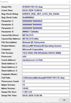

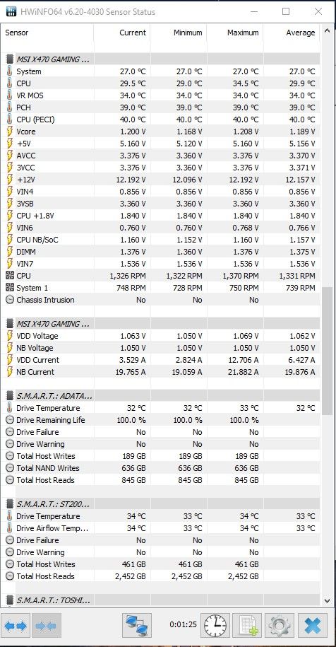

    Please download: https://www.bleepingcomputer.com/download/bluescreenview/ run and read from the dump which driver error the system indicates. Your post lacks any information - configuration, etc. - that could help determine the cause "on feel".
    The fact that you "updated the drivers" not only does not say much, it could also be the cause of the error.

    Below is what you asked for.

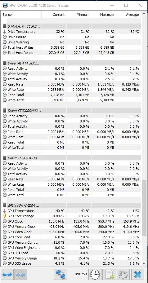

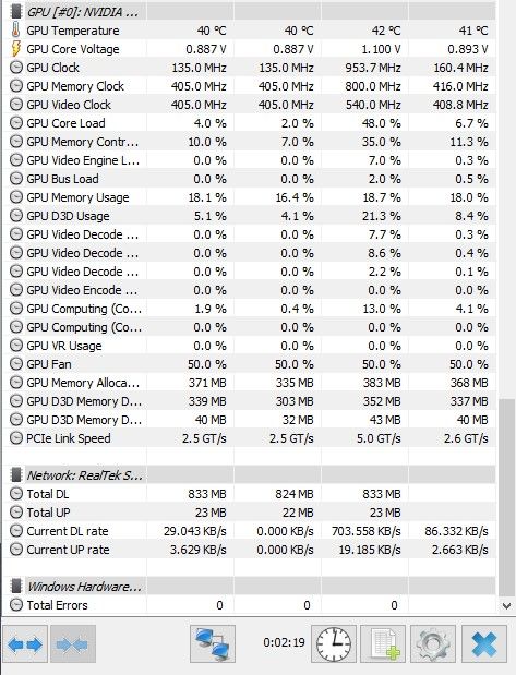

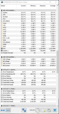

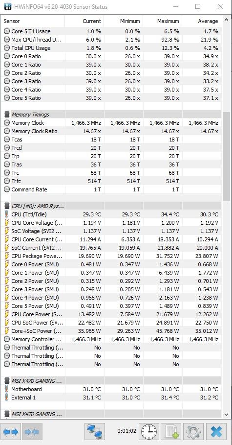

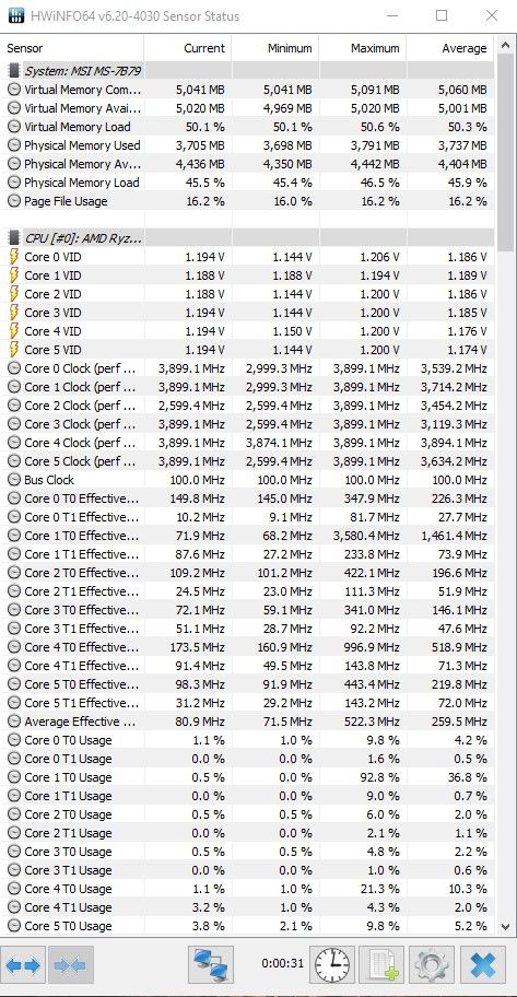

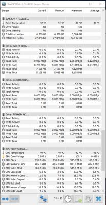

    I am attaching a picture of the voltages.

    I searched the web yesterday for information on this subject and also most of the answers indicate that it is a problem with the network card driver. Already this morning I removed the drivers from the network card in the device manager, downloaded the new ones from the manufacturer's website and installed them and so far everything works. I'll let you know if anything changes. Thank you very much for your help.
