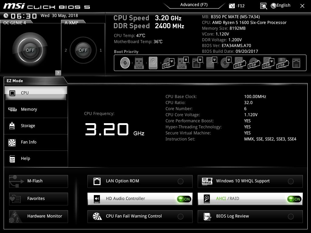

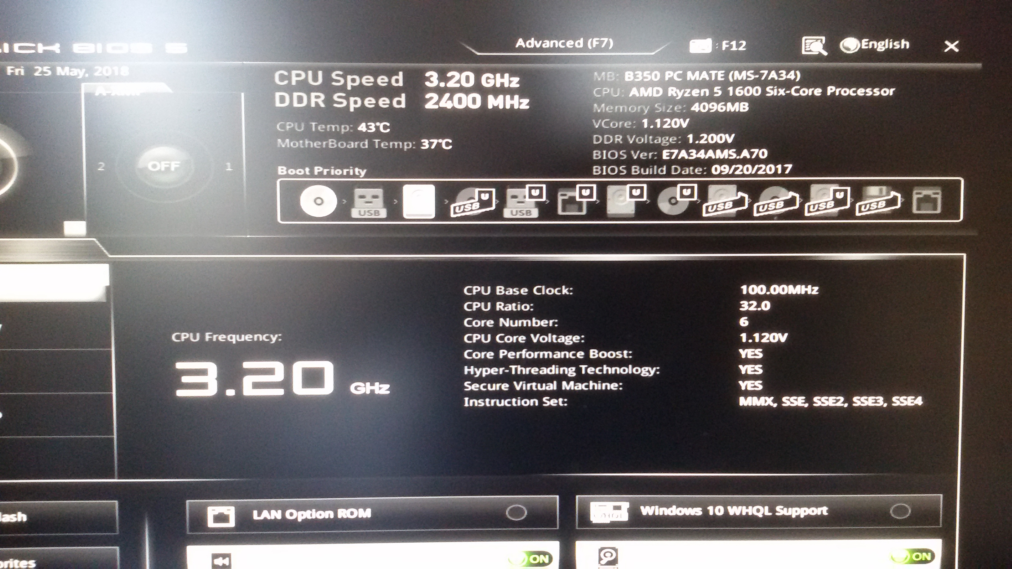

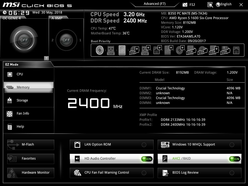

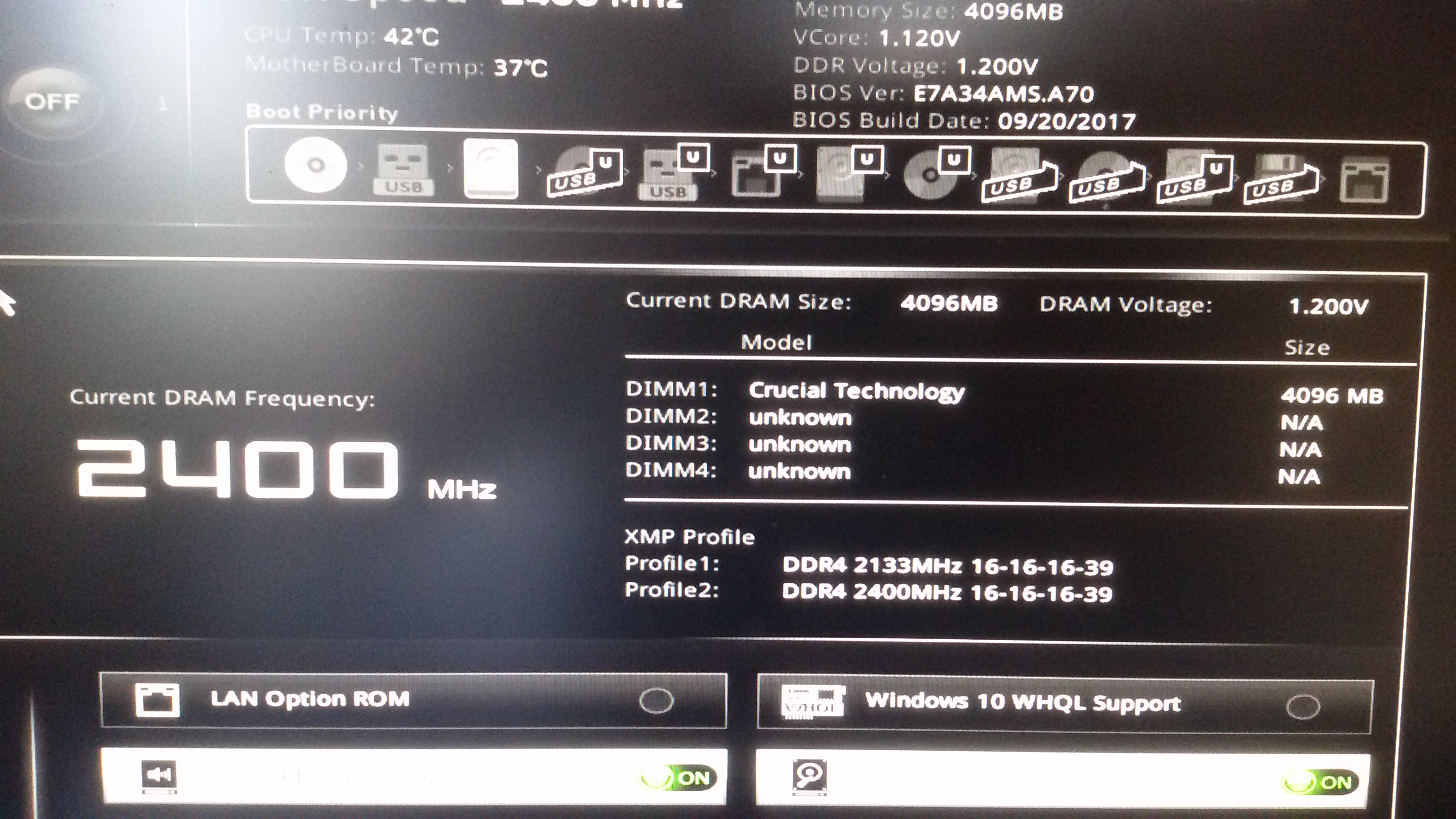

    Specify exactly what RAM model it is and upload the screenshots from the BIOS with the settings (basic settings, i.e. timing and voltage as well as timings), preferably all tabs expand and take screenshots).

    Ok thanks for the info. I'll figure it out ... RAM sits in the 2nd and 4th slot. I will translate into 1 and 3 and upload BIOS screenshots tomorrow.
    Added after 19 [hours] 32 [minutes]:
    Changing slots did not help. After removing one bone, a blue screen also appeared, now I'm checking the other. The memory is Crucial DDR4 Ballistix Sport LT 2400 CL16. BIOS screenshots:

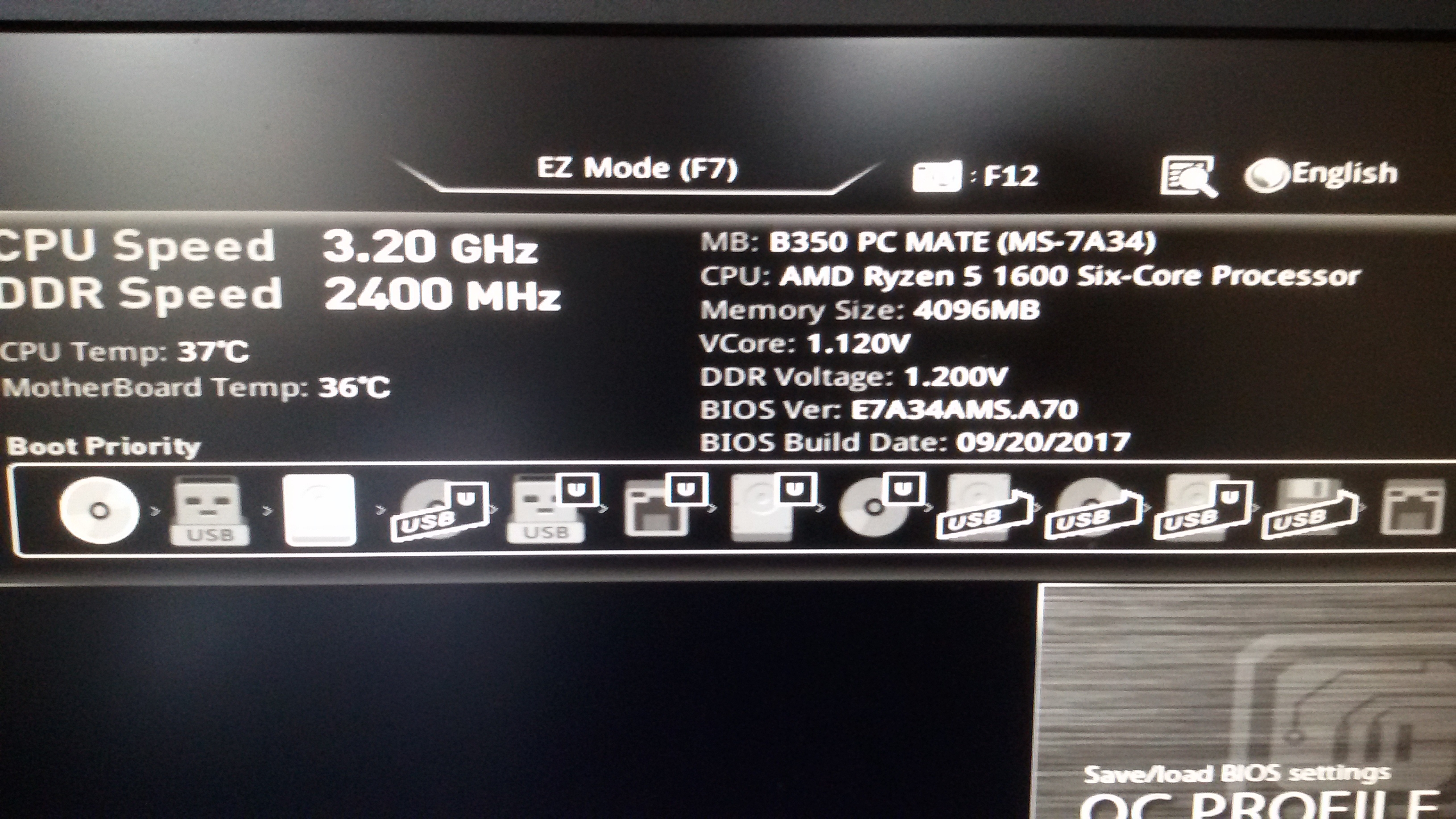

    Meanwhile, there was a problem on one bone. This time, besides the familiar error, I saw the file name "pci.sys" before the system rebooted.
    Below are screenshots from the BIOS. I don't know how it was before, but now RAM works at different frequencies ...
