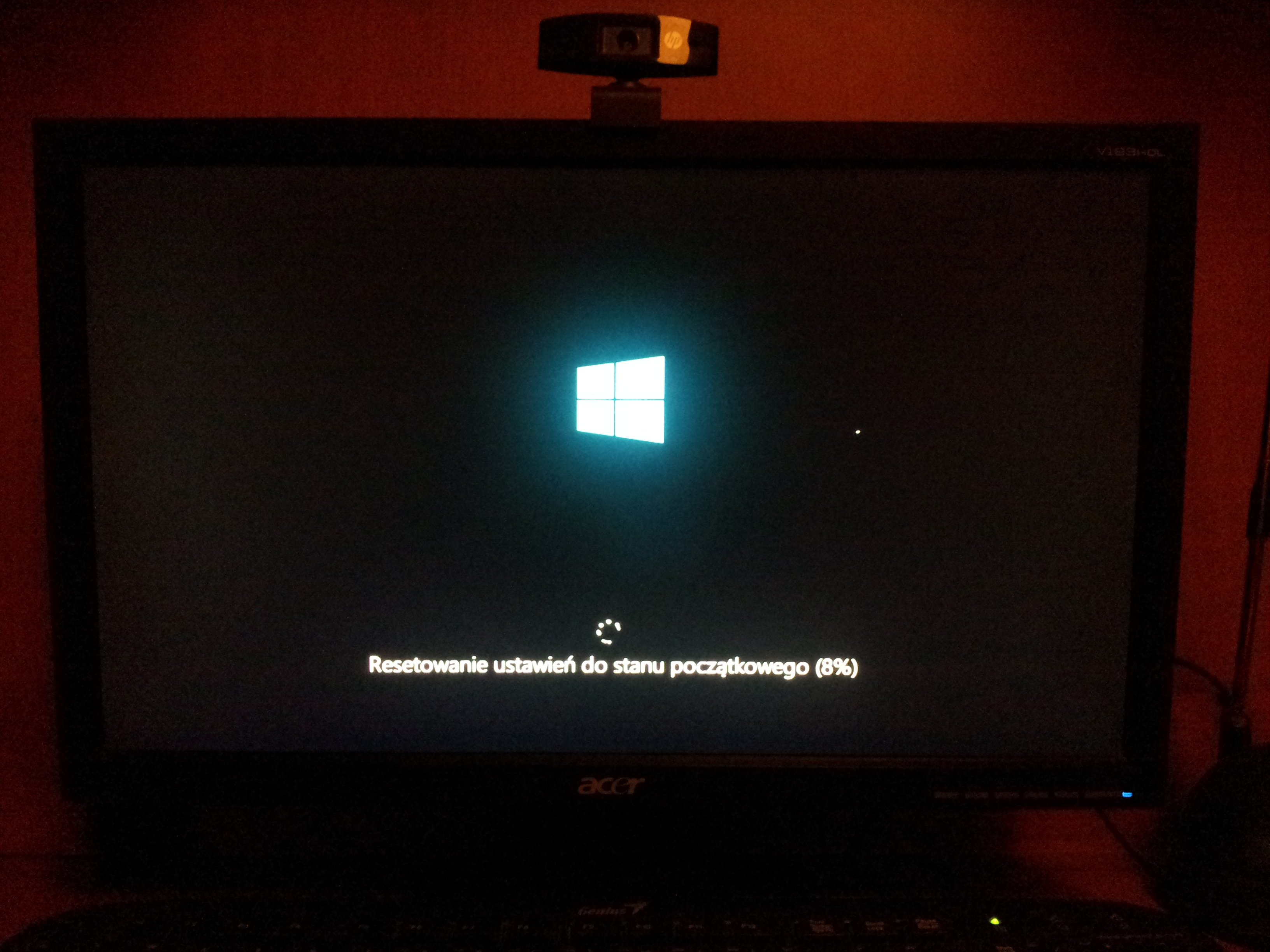

    Hello. I have problem with my computer. Yesterday it was ok, the computer worked very well and today I had problems to run it and when I start it, I get an error from time to time and the computer restarts.
    Windows 10 Error: KMODE EXCEPTION NOT HANDLED - Computer Restarts, Solutions Needed
    Does anyone know what the problem is?

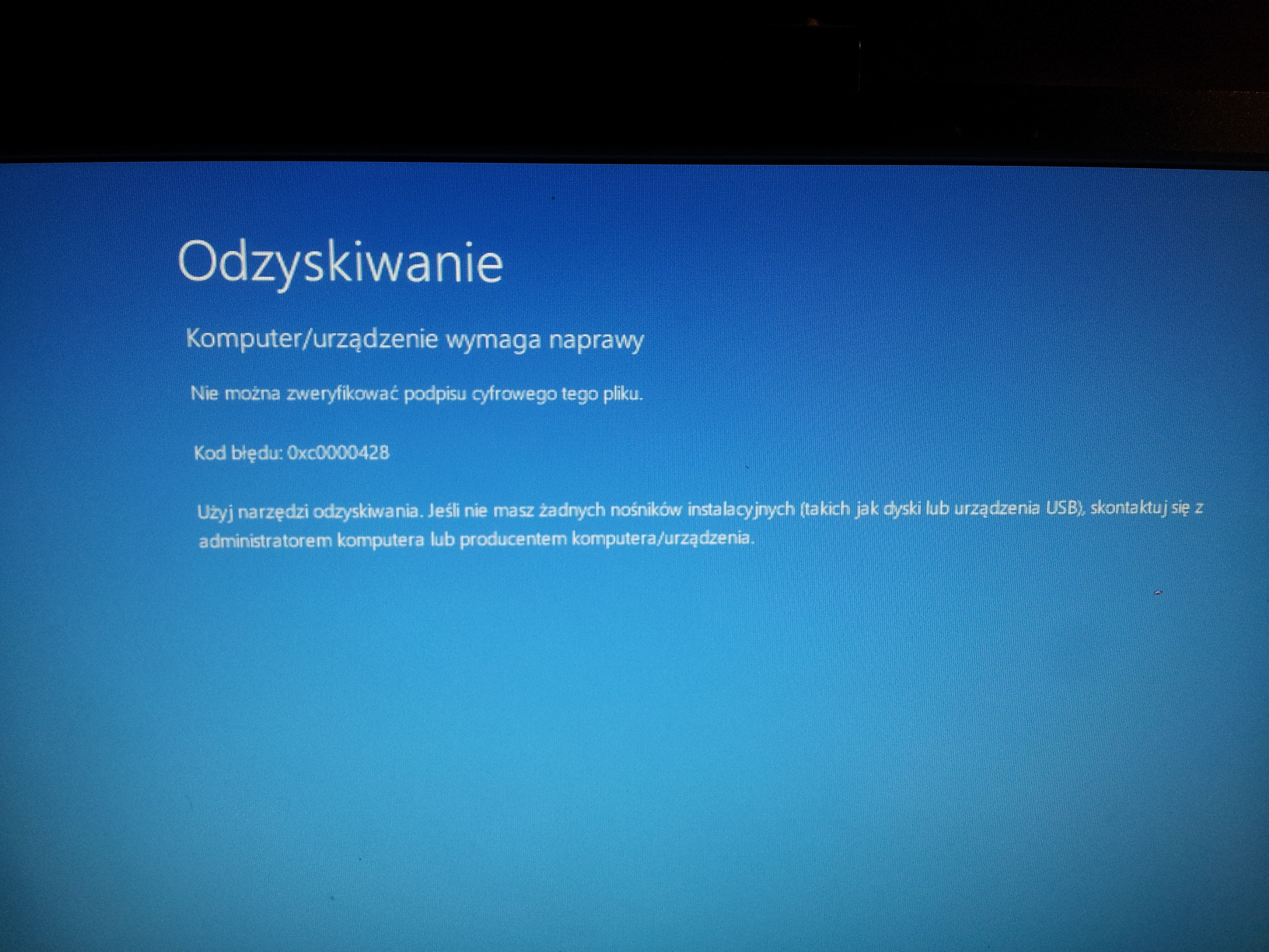

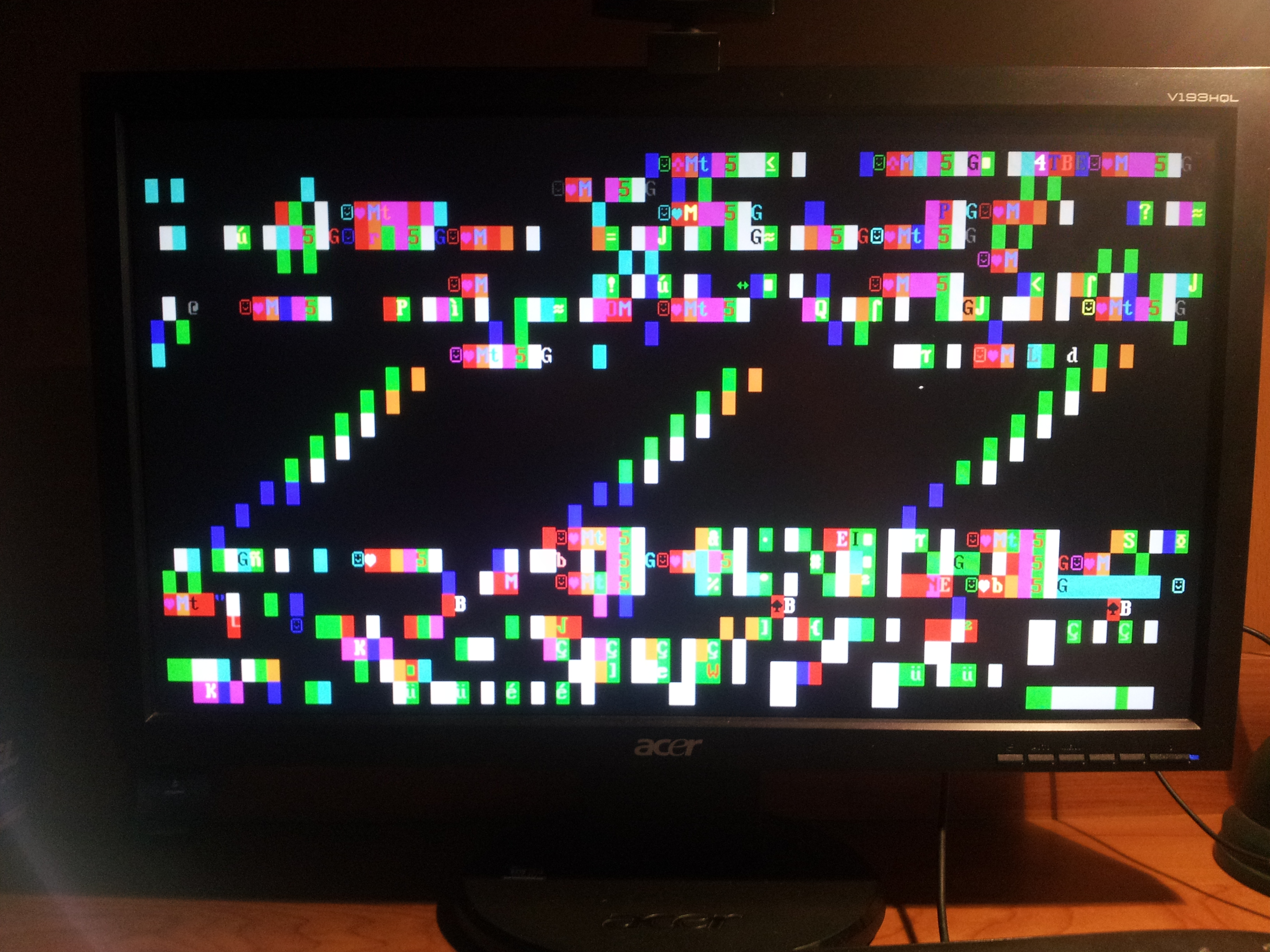

    Recently, miracles have been happening with the computer ...
    I reset Windows 10 to its initial state twice and it was no improvement.
    I'm fed up with Windows 10 and installed Windows 7.
    I thought it was the fault of the system and that it would be better ... I was wrong.
    Every now and then the monitor goes into sleep mode and some error with the graphics driver pops up. Sometimes it goes into standby and then restarts. Maybe the problem is in the GPU drivers?

    How does a computer behave without a graphics driver?
  • #7 15387199
    Damian99PL
    Posts: 53
    Rate: 9
    When I freshly put Windows 7 up and there were no controls yet, it was normally my way. The resolution was small, that is as it should be and there were no problems.
    Are you thinking about uninstalling the drivers and checking if the problem persists?

    Let yourself be led on the right track. Remove the graphics from the computer and see how the equipment will behave without it, on this integrated graphics.
  • #13 15387281
    Damian99PL
    Posts: 53
    Rate: 9
    Okay. If there is no improvement, I will take the graphics out of the computer and run it on an integrated from the motherboard. But I'll still want to install some older graphics drivers and check them out.
