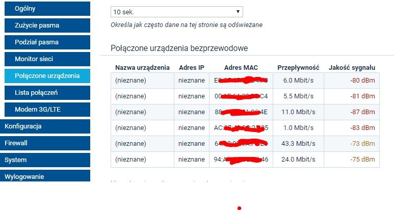

    Everything flashes nicely, there is only one problem, or rather a lack ...
    When TP-Link mr3420 (Gargoyle) worked alone, it recorded a lot of data, i.e. what device is connected, statistics of downloaded data, visited pages, etc. Now when TP-Link is connected to Huawei B525s-23a, it only registers devices that are connected to it (shows only MAC), IP and name is unknown. Parameters such as: Bandwidth consumption, Bandwidth sharing, Network monitor, Connection list, are empty.

    Is it possible for TP-Link to register everything as before when it worked alone?

    There is no such possibility. Now he works as a so-called "stupid AP" and cannot have such information because it does not route packets.

    As above, it would have to be connected via WAN and all traffic to the internal network would have to go through it.

    I understand that if I connect TP-Link to Huawei B525s-23a via WAN, data on devices connected to it will be registered by TP-Link?

    Of course you do, you connect your home network to the Gargoyle TP-link LAN ports.
