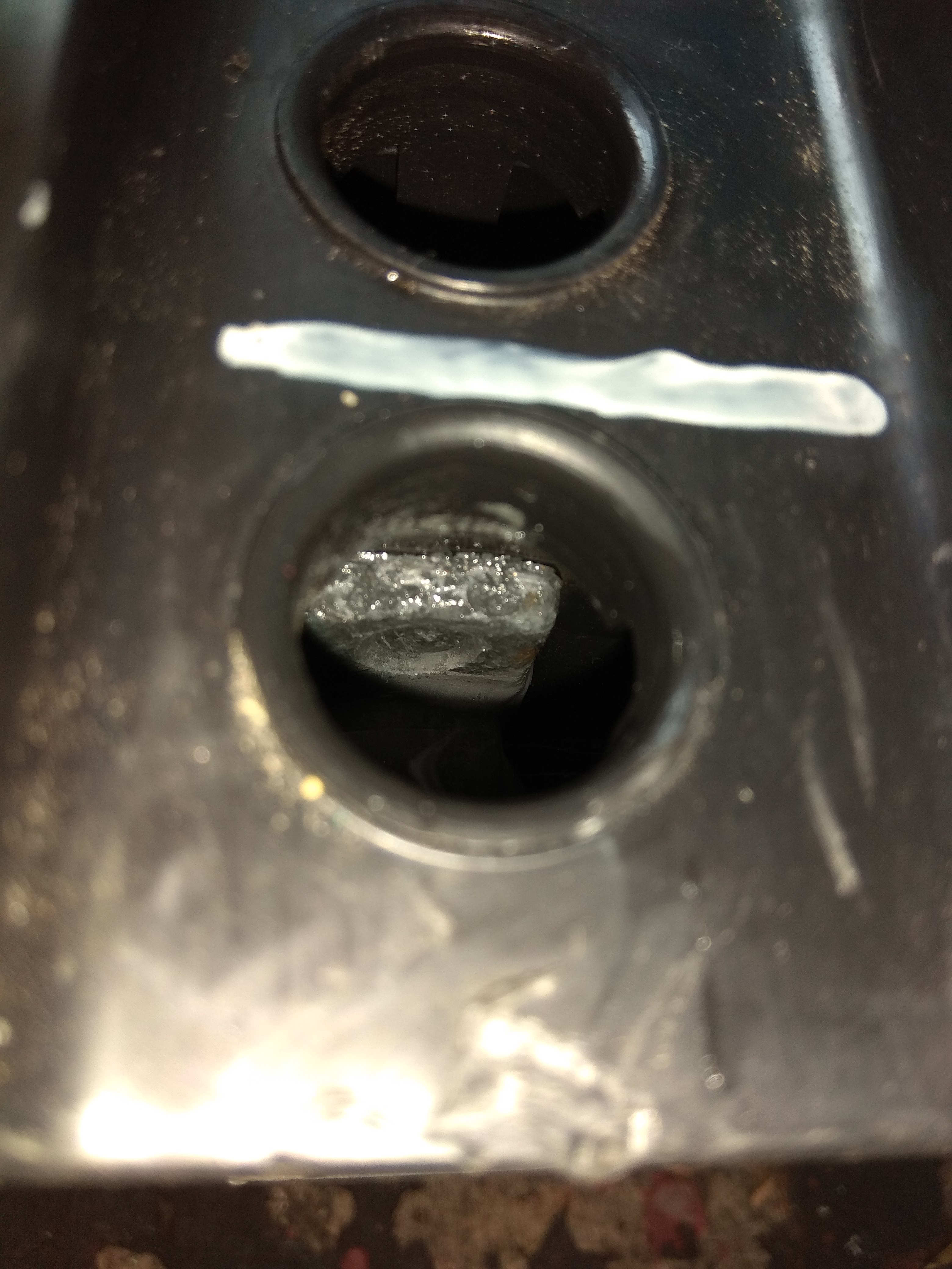

    The three-year Centry 50Ah battery has a break on the bridge between the cells. Is it possible to repair (regenerate) it?

    Is provided that you have a new housing. The event is medium, or rather unprofitable - given the price of the new one. The three-year battery is already quite worn out.

    In the early 70s, as the battery looked like a photo, I did such things, I cut the jumper with a lead with a metal saw, then I scraped the seal off the tar around the damaged cell and after replacing or repairing the connection, sealing with hot adhesive and welding of the joints between cells followed with the help of a carbon electrode and an external battery, and even if it was an external cell, welding was carried out without involving external power.

    As it is a bridge on the opposite side of the plugs, you can try to open the housing here.
    Reflecting on the cause of such damage, the first thing that comes to mind is freezing a discharged battery in winter, and in this case any further play with it makes no sense.

    I have such a battery. A damaged connection is marked with a white line.

    I would cut the casing with a metal ball, solder a 100-200W soldering iron using a solder to the gutters or other lead connections and sealed the casing with the same soldering iron, or possibly with hot pistol glue. You can try PLN 200 along the way it is not. It's just that you have to be careful not to pierce the clothes and other things with acid.

    It's easy to get in with a carbon electrode by drilling a hole on the side of the housing, opposite the broken bridge.

    New PLN 165. Is it worth wandering ??

    Access to the bridge connecting the cells is good through the filling holes. You can see it in the pictures. How to fix this link? (It is probably welded and welded from the factory).
