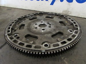

  • #7 16578585
    mkaminski100
    Posts: 501
    Help: 7
    Rate: 227
    Here is only a plate with teeth and I can see that it is properly screwed to the box converter, so it certainly does not knock.
    After locking the flywheel, it feels no play on the shaft

    #17 16716741
    mkaminski100
    Posts: 501
    Help: 7
    Rate: 227
    Pathetic torment was right.
    The reason for the knocking was a stratified flywheel.
    After unscrewing the slack with your hand you can feel it.
    Here is a video of how much it knocks. The outer sheets are quite loose. The new wheel is gone.
    I'm just worried about the shaft seal under the wheel. The mounting ring in the box with a new seal (from Ford) was loose and there, as I remember, the lips are to be in opposite directions (inner brown towards the engine, outer to the box). I put it on the ring, but I have the impression that this outer lip does not adhere perfectly to the shaft and there is a minimum gap. The funny thing is that you don't spend it bent, it's just the way it is.
