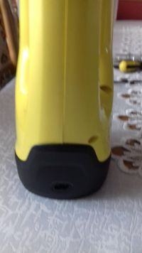

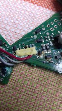

    Hello, the washer does not turn on, after pressing the switch the LED blinks 4 times and nothing happens. Charging attempts do not work, the charger is working.
    Second thing, I can't take the bottom case off, how to take it off Karcher WV2 Window Washer: LED Blinks 4 Times, Won't Charge & How to Remove Bottom Case Karcher WV2 Window Washer: LED Blinks 4 Times, Won't Charge & How to Remove Bottom Case Karcher WV2 Window Washer: LED Blinks 4 Times, Won't Charge & How to Remove Bottom Case ?

    Hello, a typical damage is rust on the engine shaft - the washer must be disassembled between the turbine and the slnik, spray WD with it, remove the rust from the engine shaft. Manually turn the turbine, you will feel resistance at first, make a few turns again and spray WD again in the indicated place. The lower part is mounted on latches, they can be released, for example, with a screwdriver.

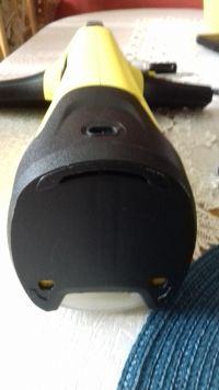

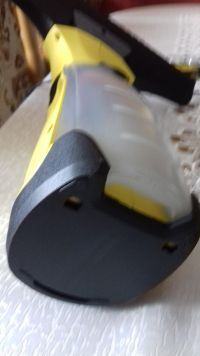

    Thanks for the answer, these latches are these holes from the bottom? because I tried but nothing slows down?

    Not those holes, the latches are between yellow and black Karcher WV2 Window Washer: LED Blinks 4 Times, Won't Charge & How to Remove Bottom Case .

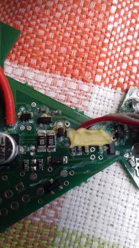

    I opened it, the motor twitches and stands after pressing the button. The rotor moves slightly as if I twist my finger, but unfortunately there are stains and stains on the board, i.e. electronics fault? can it be fixed? Karcher WV2 Window Washer: LED Blinks 4 Times, Won't Charge & How to Remove Bottom Case Karcher WV2 Window Washer: LED Blinks 4 Times, Won't Charge & How to Remove Bottom Case Karcher WV2 Window Washer: LED Blinks 4 Times, Won't Charge & How to Remove Bottom Case
  • #6 16577360
    fredo110
    Posts: 407
    Help: 75
    Rate: 235
    What is the battery voltage? Clean the electronics with a nitro solvent.

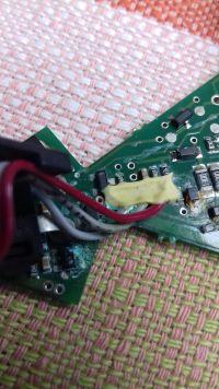

    3.47V has, ok it will wash in a moment, I have a spray to electronics, I washed the car's flow meter with it.
    Added after 19 [minutes]:
    Unfortunately, I washed it thoroughly and nothing :-( After pressing the switch, the current does not go to the motor, the meter shows 0.00V on the wires at the motor.

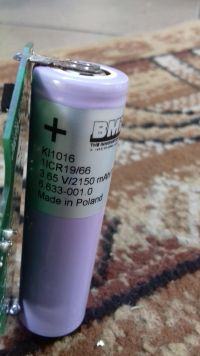

    The rechargeable battery is not charged, the rated voltage is 3.7V after charging 4.2V, the battery may have run out.
    Added after 9 [minutes]:
    Check the charger if there is voltage at the outlet of the plug, connect the charger to the washer's socket and measure whether the charger is charging the battery, if it is charging, wait until the voltage on the battery increases to at least 3.7V then turn on the washer. At a voltage of 3.4V, the electronics will not turn on the power to the motor.

    The electronics with a voltage of 3.4V will not turn on the power to the motor, it is set in such a way to protect the battery against complete discharge.

    Before charging, the battery was 3.38V. For 50min. charging, the battery still has 3.38V. So something with the charging system? but the rechargeable battery? I removed the battery and measured the current on the battery contacts without a battery with a charger connection and it is only 0.28 V

    You made a mistake by connecting the charger to the electronics without a battery. The electronics is normally powered by 3.7V (4.2V after fully charging the battery). The charger, as you write, gives 5.5V, think about what could have happened when the supply voltage was exceeded.
    My suggestion is - if you have a 3.7V stabilized power supply and 3A current, connect this power supply in place of the battery, do not confuse + with - check if the engine starts, if so, the washer is operational and you need to take care of the charger.

    Hello again, I have finally installed the link and the washer works, but it does not charge the battery, where to look for the reason? The LED on the switch blinks 2 times and goes out.

    I bought a Li-Po charger module on the TP4056 chip, soldered and the washer works and charges.
