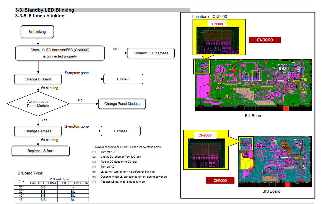

    Good evening, I have a problem with the TV, namely the TV turns on, the Sony inscription appears and turns off 3 times, and then the red LED starts flashing and it can no longer be turned on. I am asking for help if it can be repaired, I did the reset in accordance with the instructions and nothing helped.

    Probably broken soft. It can be repaired on a good TV site.

    Thank you very much for your help, but I couldn't make it myself. I will give it to the site, thank you again.
