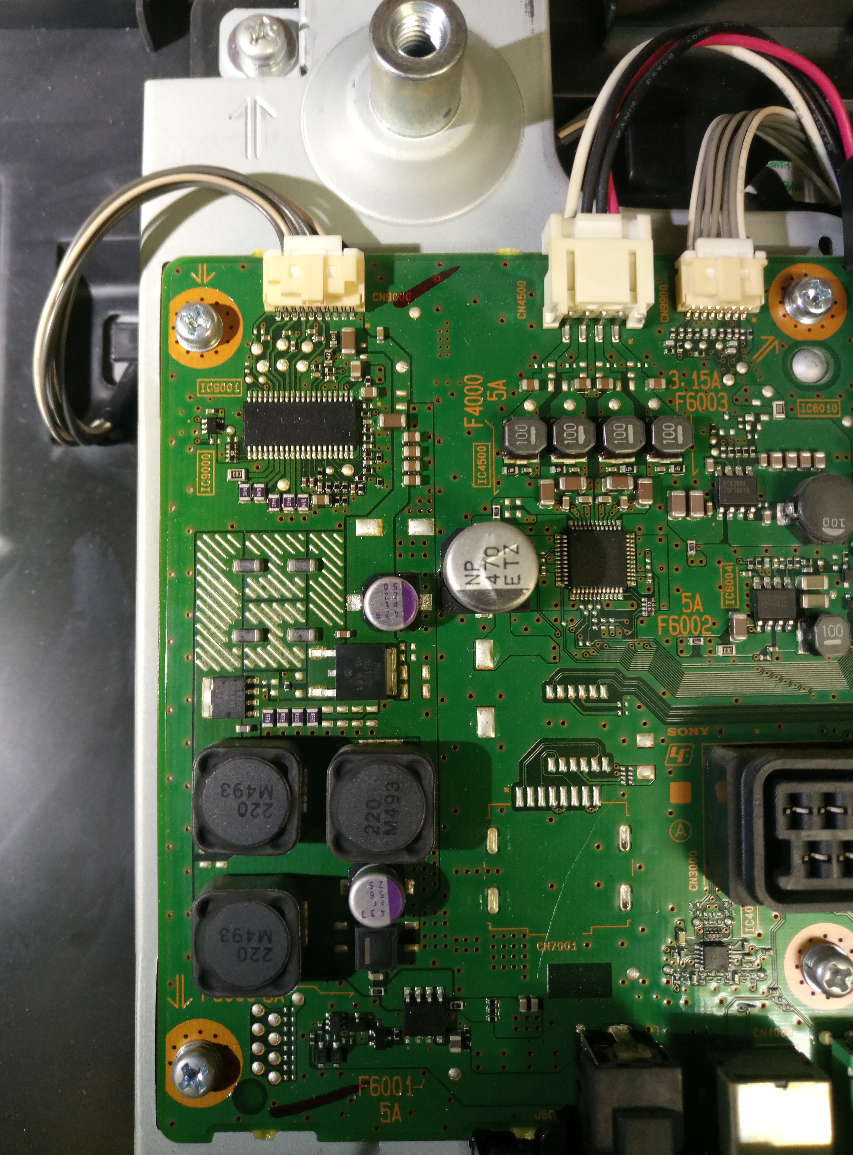

    I have a Sony Bravia KDL-40R480B TV. The symptom is that when turned on, the SONY logo appears and it reboots three times. Then the screen goes blank and there are 6 red blinks. Every time the TV is turned on, it will have time to enter the normal mode (displays the message no signals), but after a few seconds, restart to the SONY logo and signal the error 6x by blinking the red diode.
    Apparently, at the beginning the problem occurred after 2-3 hours and after some time we have the condition as described above.
    According to posts on the forum and the diagnostic manual found here, the problem in highlighting. The TV has 10 stripes with 5 LEDs on each. I undressed the TV and checked all the LEDs one by one with a meter (they all glow) and then I connected each strip to the 15V power supply and it also turns out that they all glow normally.
    For a Chinese, new strips for this model are priced PLN 100 per set, but should you risk replacing them if the original ones do not reveal damage to the diodes? Is the problem then on the side of the power circuits?
    In the attachment there is a photo of the LED power supply (the backlight connector is the first from the left and top) and the strips themselves (Chinese, they look identical).

    This IC should be an LED driver.
    Oops, the topic is old.
    • bd9397efv-e.pdf (1.07 MB) You must be logged in to download this attachment.

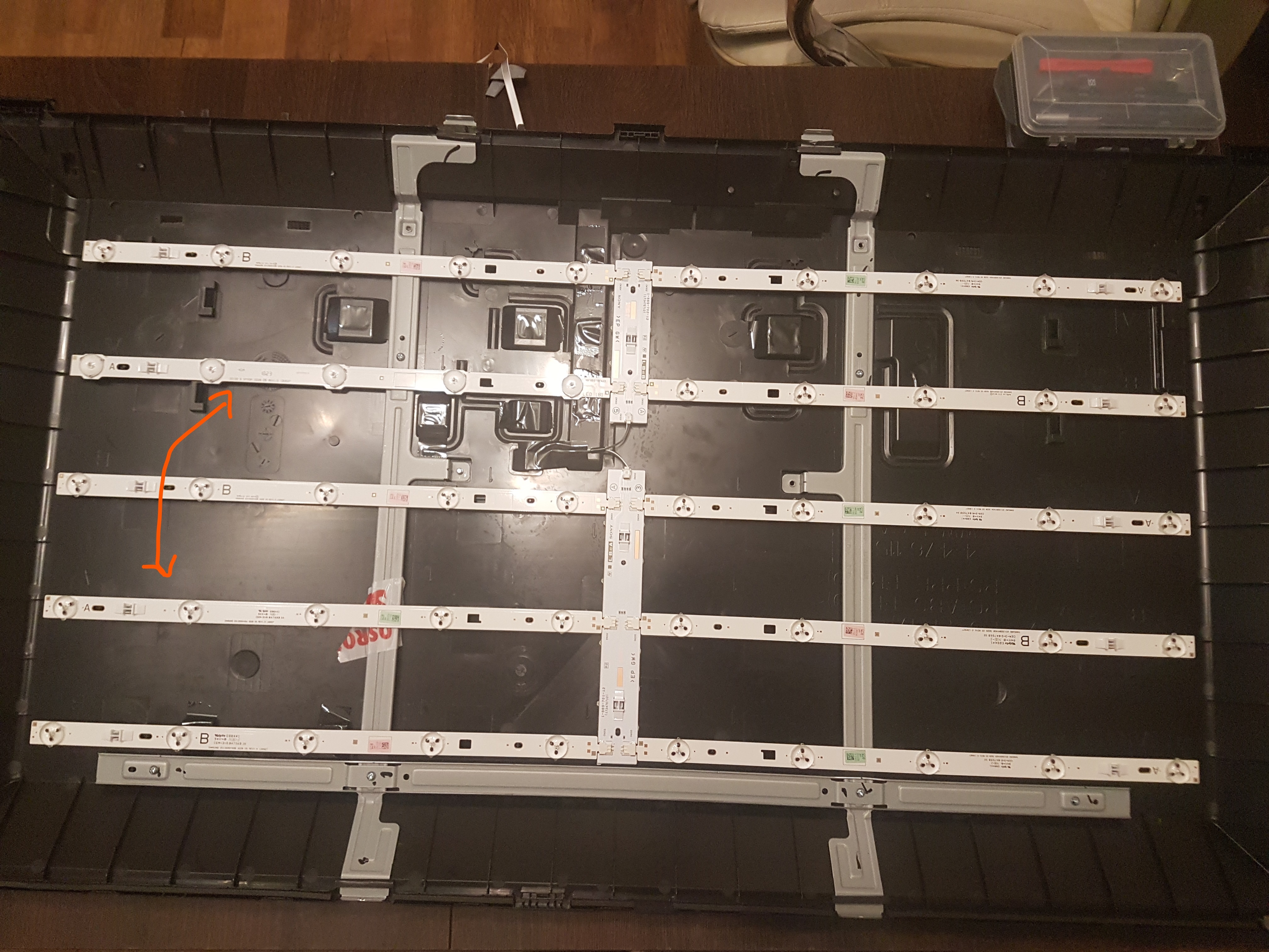

    I think you can solve the problem, but you have to remove the display.
    Turn on the TV without display, and you'll see which LED channel is not rolling ... it has 5 channels.
  • Backlight LED break diagnosed by strip flex test
    #10 17611467
    OMMMM
    Level 19  
    Posts: 514
    Help: 10
    Rate: 32
    My friend, I had a similar problem with Sony, but another model, the problem was the break on one LED from the backlight. I checked with the meter and it was ok when I connected it to the power supply it was ok, but when I started to gently bend the led strip, it started to flicker. Replacing the diode helped, try to connect the strip to the regulated power supply and slowly lower the voltage, all of them should fade evenly, if one of them starts flickering on the background of the others, it is either damaged or will be damaged in a moment.

    I have the same TV and the same symptom.
    I undressed and one diode was burnt, I replaced the entire strip with a new one (5 diode).
    After replacement, it has no effect. So I don't know if it's a matter of LEDs or maybe firmware

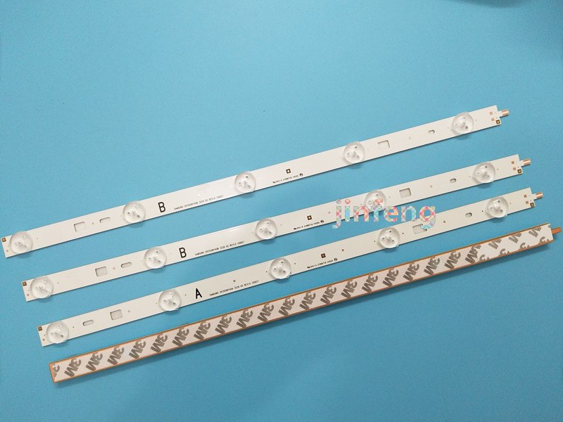

  • Replacement LED strip from Allegro fixed the backlight
    #18 17696052
    microkod
    Posts: 10
    morghul wrote:
    And where did a friend buy a replacement LED strip?
    STRIP SAMSUNG 2013SONY40A 3228 05 REV1.0 130927 A - also -mawipol-with Allegro, oddly enough it shines brighter than the factory ones.
    Today I sat over these LEDs again and changed the lists in places, the TV set started working strangely. I've already been testing it for 5 hours and everything is fine.
    Maybe someone explain why.
    Sony Bravia KDL-40R480B - LED Error Indicator Blinks 6 Times, Screen Goes Blank
  • Replacement LED strip from Allegro works brighter

    ps ... after replacing the straps with new ones from Ali Chinaman, he did not fire me ... I just made jumpers on the strips and there was contact ...
