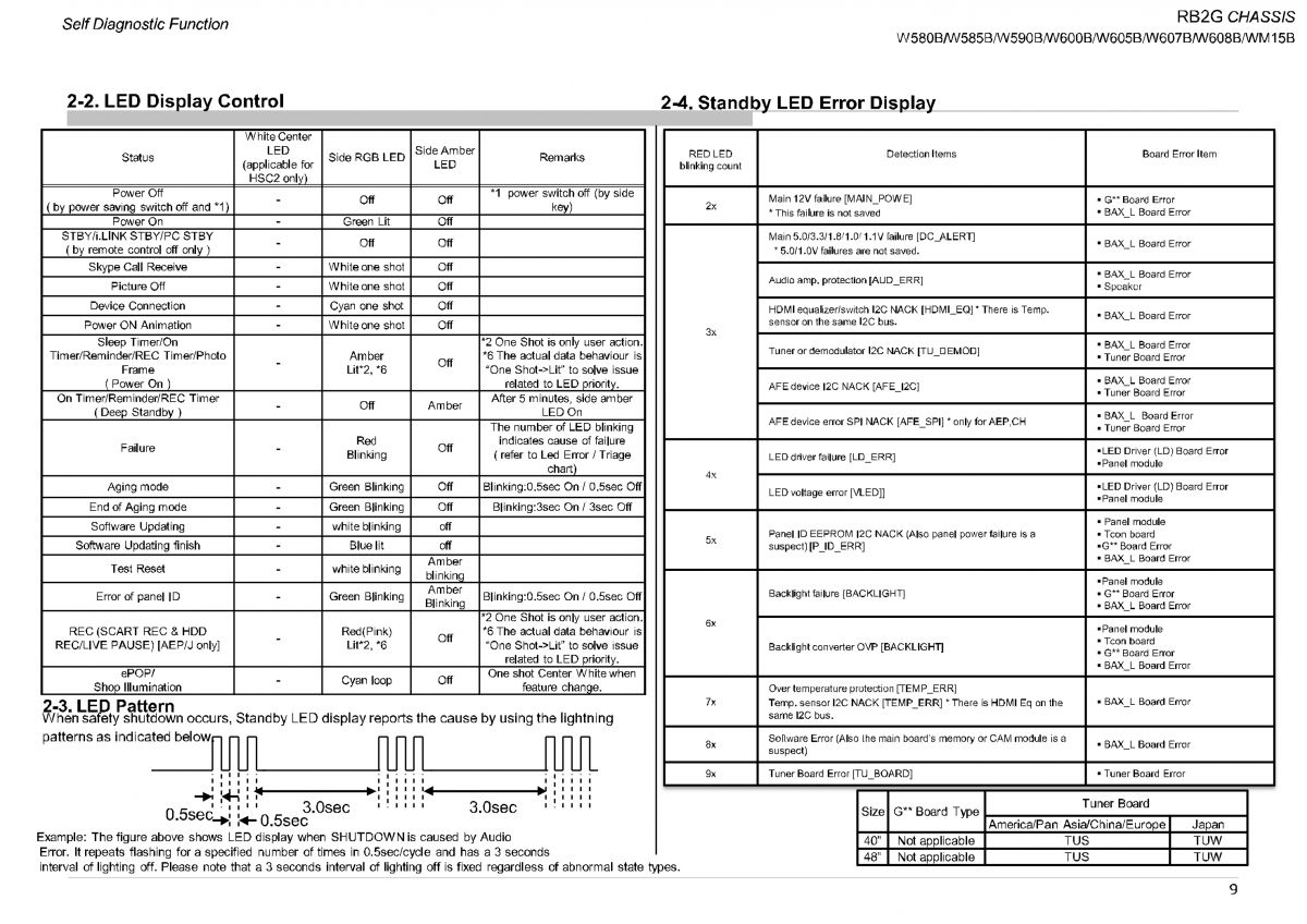

    TV! I have a SONY BRAVIA - kdl42w805b and I have a problem. When it's switching ON it blinks 6 times red one LED. When I plugged off the cable that goes on T-CON BOARD it's working normally.
    What is the problem. The panel or T-Board ?

    Check backlight!

    >>21433795 My friend, when I unplugged the flex cable which connects to the T-CON board, the TV is working normally with backlights but without image because of the missing t-board. When I plug in the flex, the led blinks 6 times.

    Replace the backlight with a new one and everything must be ok. I have not come across another case in this series for 6 flashes

    >>21434687 Explain me this: why when I turn ON the TV it's working normally without the T-BOARD and when I plugged in the TV with T-board it's switching off and the LED backlight it's blinking six times ?
    Added after 8 [minutes]:
    >>21435934 >>21435721 >>21434687 >>21435721 >>21434687 >>21434480 >>21433795 >>21434687 >>21435721
    I measure with oscilloscope the voltages and everything is OK. Also, I switched off the TV and I unplugged the LED cable and plugged the T CON Board on, the same applies.

    >>21436087 Man. thank you for your time! I just changed T-Board and it's working normally. Thank you all, also >>21433795 and >>21435721 !! Thank you !
