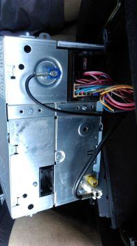

    I apologize in advance if the topic was created in the wrong work and if I duplicate but I did not find any similar topic.
    Well, I have a Skoda Octavie 2nd generation and in it the radio "Skoda Radio Navigation 1Z0 035 194 A" (if you gave it wrong forgive) and on the front panel there is a button with the transition to AUX but the cable is missing. If anyone of you is familiar with this topic or has already bought such cables and found the right one I would be extremely pleased to be honest with, I am stupid in this topic because I was looking for items of this type in the Allegro but I am not sure if this radio comes up with many different pops cables.
    Another question is whether you can buy such a cable but instead of AUX would be USB or both preferably as if it were USB.

    There should be something like that, check to see if you have one.

    This is the back panel.
    Skoda Octavia 2 - Radio Navigation 1Z0 035 194 A: Find Right AUX Cable or USB/AUX Alternative
    Or maybe something like this but with USB?

    CameR wrote:
    mario19985 wrote:
    something like that but with USB
    Yes,
    digital changer.
    What is this and what is the price?
    #6 16580839
    DriverMSG
    Posts: 44094
    Help: 3984
    Rate: 4883
    For example - Yatour YT-M06, around 230 PLN.

    Thank you for your help, now just thinking about buying.
