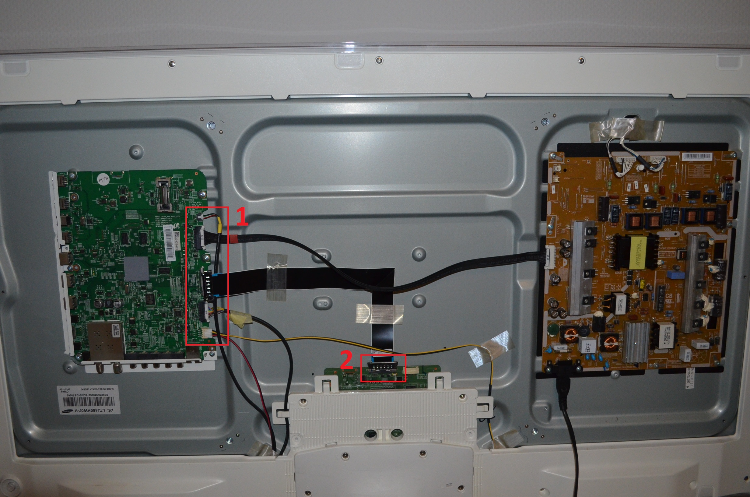

    Samsung UE46ES6710 TV does not start up.
    The standby LED is still on (as always), when I want to turn on the TV, the LED blinks 5x and then I hear a double pop in the upper right corner (looking from the back of the TV). What could be the reason?? Where can I start?

    You want to crank it up, disconnect the main board, disconnect the T-con and turn on the TV.

    After disconnecting all tapes and cables from the board (photo 1.), the entire matrix lights up
    After disconnecting only the tape (photo 2.) nothing changes, which is like in the first post.

    Read the motherboard name carefully, probably BN94-05898x xxx, look for it, buy it, it should work.

    the board is BN94-05898N in addition to it, there is a power supply and the one at the bottom in the middle, the chances of hitting are high :)
    Added after 16 [minutes]:
    I would like to add that it is enough to disconnect only the cable that connects the power supply to the BN94-05898N board and the LCD matrix is turned on.

    You have a good power supply, and this plate is at the bottom. Rather. ;)
    That's why I asked for a simple test.

    I have a question about the motherboard, mine has the designations BN94-05898N and I found BN94-05898J has a different ending, I have "N" in my own and here is "J".
    Can I buy such a CD and use it in my TV ??

    Look at the LVDS socket.

    I bought this BN94-05898J, everything fits and works. Thank you.
