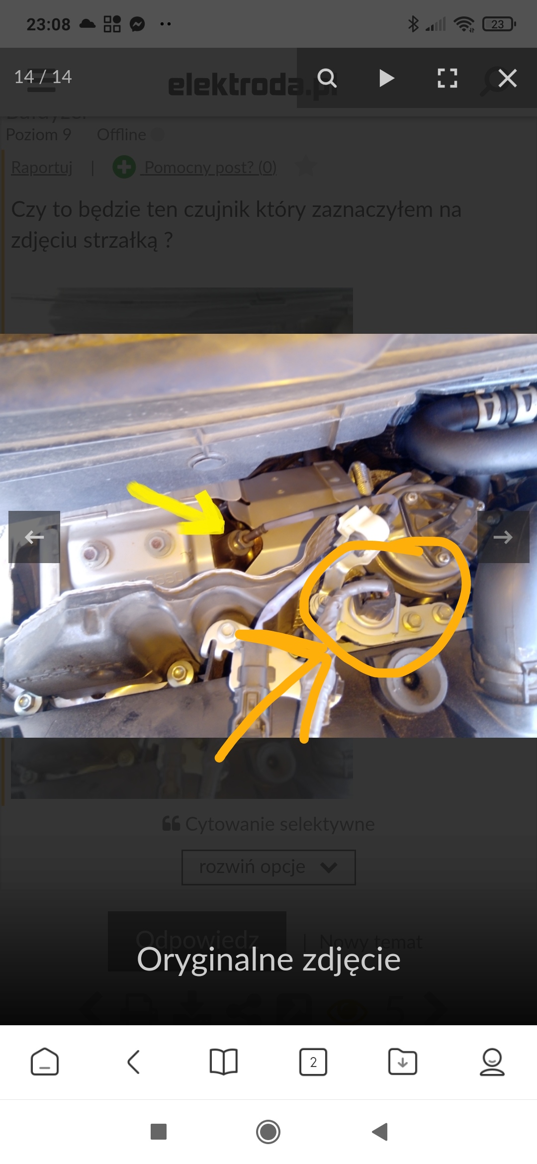

The fault was caused by another exhaust pressure sensor, not the DPF differential pressure sensor already replaced [#16647464] It is a small sensor like a boost-pressure sensor, mounted at the rear of the engine, roughly behind the valve cover and before the turbocharger, with one hose and a 3-pin plug [#18801528] After replacing that sensor, all fault codes cleared, the check engine light went out, and the car regained full power [#16647464]

    Hello, 90 percent of it is the sensor I marked it in the photo
    • Mazda CX-5 2.2 Diesel 175HP 2014: Persistent P0472 Error After Replacing DPF Sensor IMG_20201026_230934.jpg (424.1 KB) You must be logged in to download this attachment.
