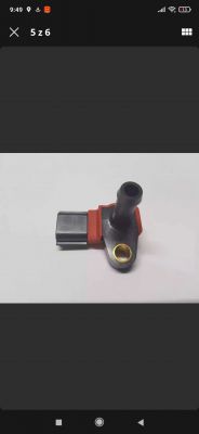

  • #18 18801528
    MarcinS70R
    Level 22  
    Posts: 591
    Help: 52
    Rate: 290
    The sensor is in the rear of the engine
    Yes, more or less behind the valve cover and before the turbocharger
    It is a sensor for one tube and a 3-pin plug.

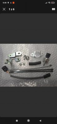

  • #22 18925374
    Mat7817
    Posts: 12
    Part of the year 2014 was to change the name of the sensor under the warranty SHY6-18-W00, enter this code in google so I was looking, I replaced everything is already ok but it does not start as before maybe the village why can it be so

  • #25 18925823
    Mat7817
    Posts: 12
    I don't have any errors, but the car is not as lively as before, maybe I have to see the throttles. And you have a manual or an automatic machine?

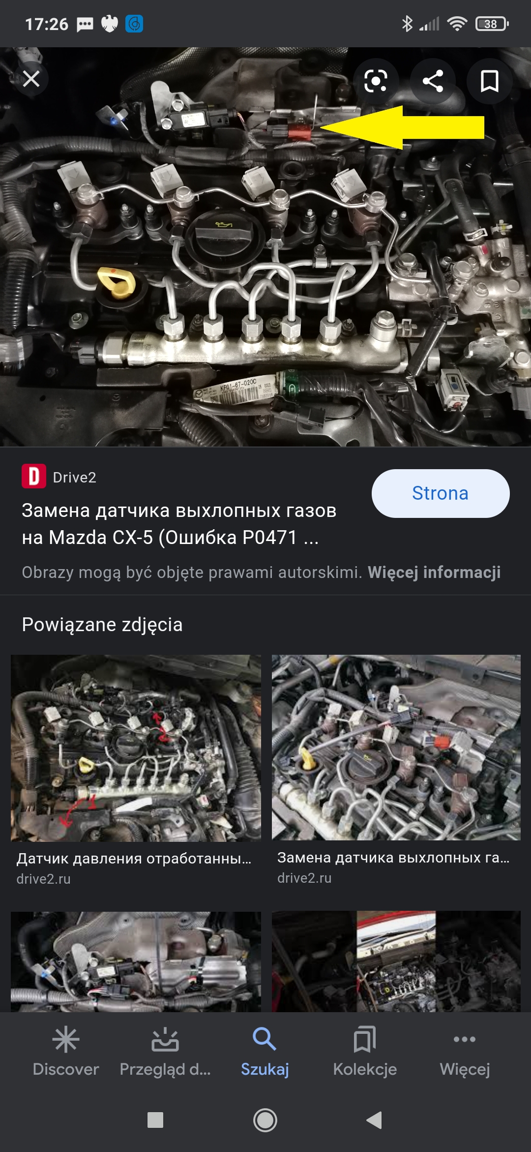

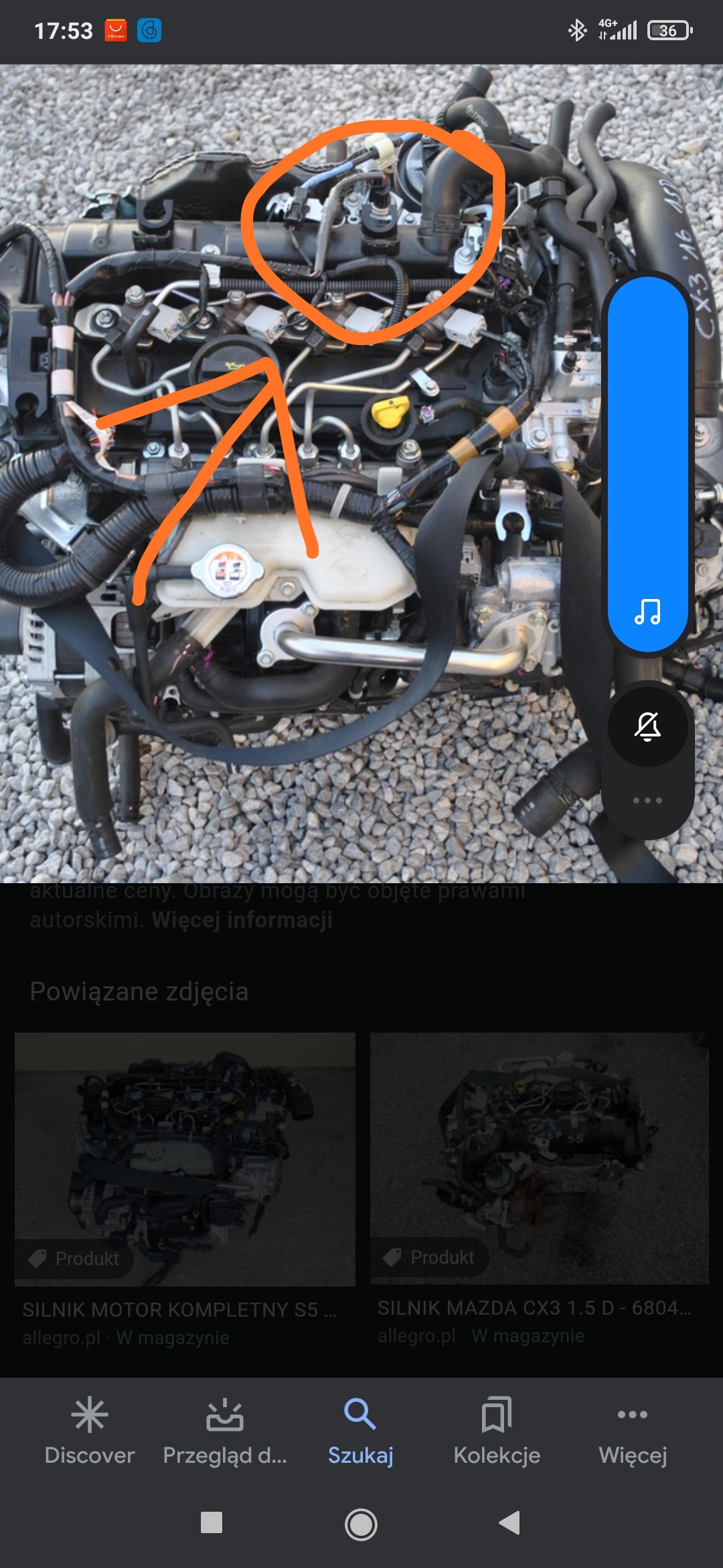

  • #27 18995289
    Bałdyzer
    Posts: 1419
    Rate: 227
    I have a question . Where can I find this sensor in the Mazda CX-3 1.5 diesel car?
  • #28 18995596
    Mat7817
    Posts: 12
    Some of them, I think, will be similar to mine, so look at the picture and search
    Mazda CX-5 2.2 Diesel 175HP 2014: Persistent P0472 Error After Replacing DPF Sensor
    • Mazda CX-5 2.2 Diesel 175HP 2014: Persistent P0472 Error After Replacing DPF Sensor Screenshot_2020-10-23-17-26-58-502_com.google.android.googlequicksearchbox.jpg (1.06 MB) You must be logged in to download this attachment.
  • #29 18995653
    Mat7817
    Posts: 12
    If your engine looks like this, I marked the sensor in the picture
    • Mazda CX-5 2.2 Diesel 175HP 2014: Persistent P0472 Error After Replacing DPF Sensor IMG_20201023_175504.jpg (690.11 KB) You must be logged in to download this attachment.
  • #30 19002277
    Bałdyzer
    Posts: 1419
    Rate: 227
    Will it be the sensor that I marked with the arrow in the photo?
