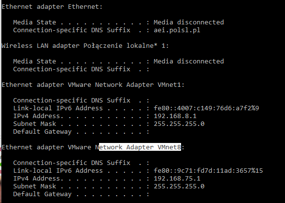

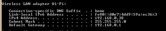

    What does ipconfig show on a computer where you have internet access?
  • #3 16598789
    karkam13
    Posts: 23
    No Internet Access on Windows 8.1 Laptop After Switching to UPC & CH7465LG-LC Router No Internet Access on Windows 8.1 Laptop After Switching to UPC & CH7465LG-LC Router

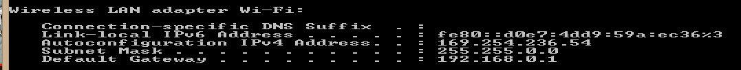

    For some reason the computer does not get an IP address from the router's DHCP. Do you have access to the Internet by manually typing the address into the wireless card on this windows?
    192.168.0.130
    255.255.255.0
    192.168.0.1
    and DNS also 192.168.0.1

  • #13 16599105
    karkam13
    Posts: 23
    Safe Mode Screenshots:
    She did not download, I pinged the router (192.168.0.1) - no answer, the same for wp.pl. The only difference is that the name of the network says "Connected", not "Limited".
