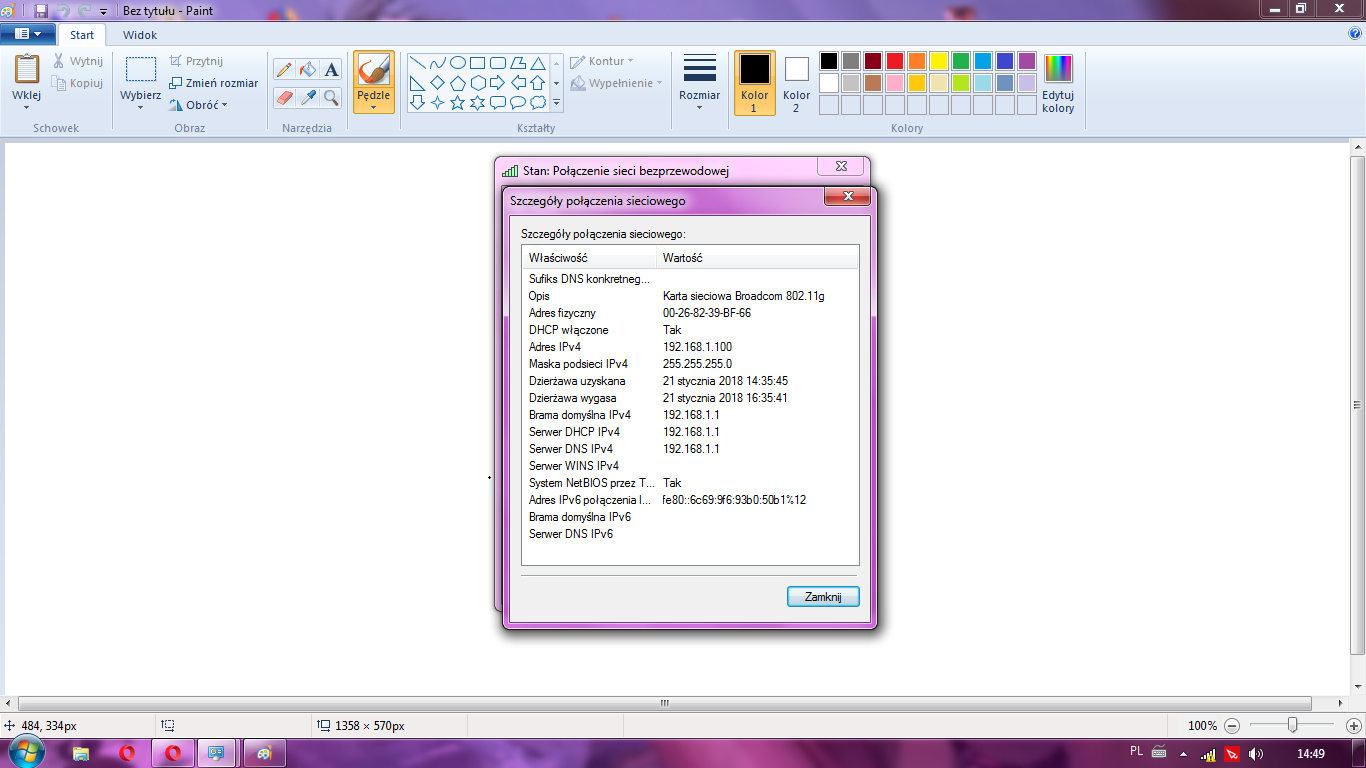

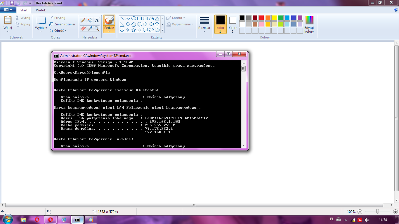

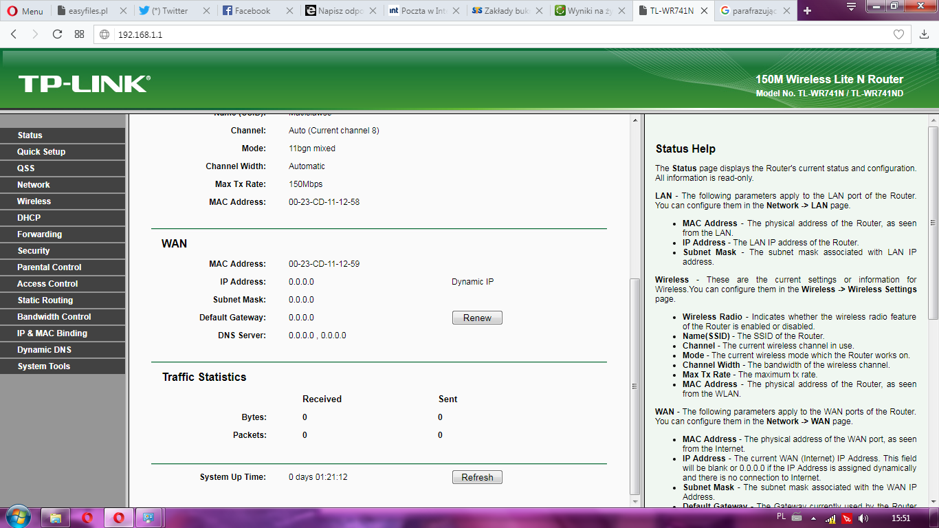

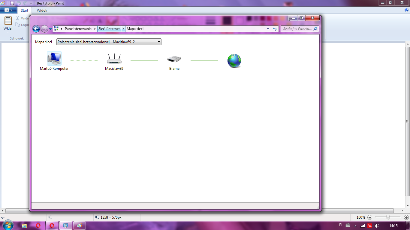

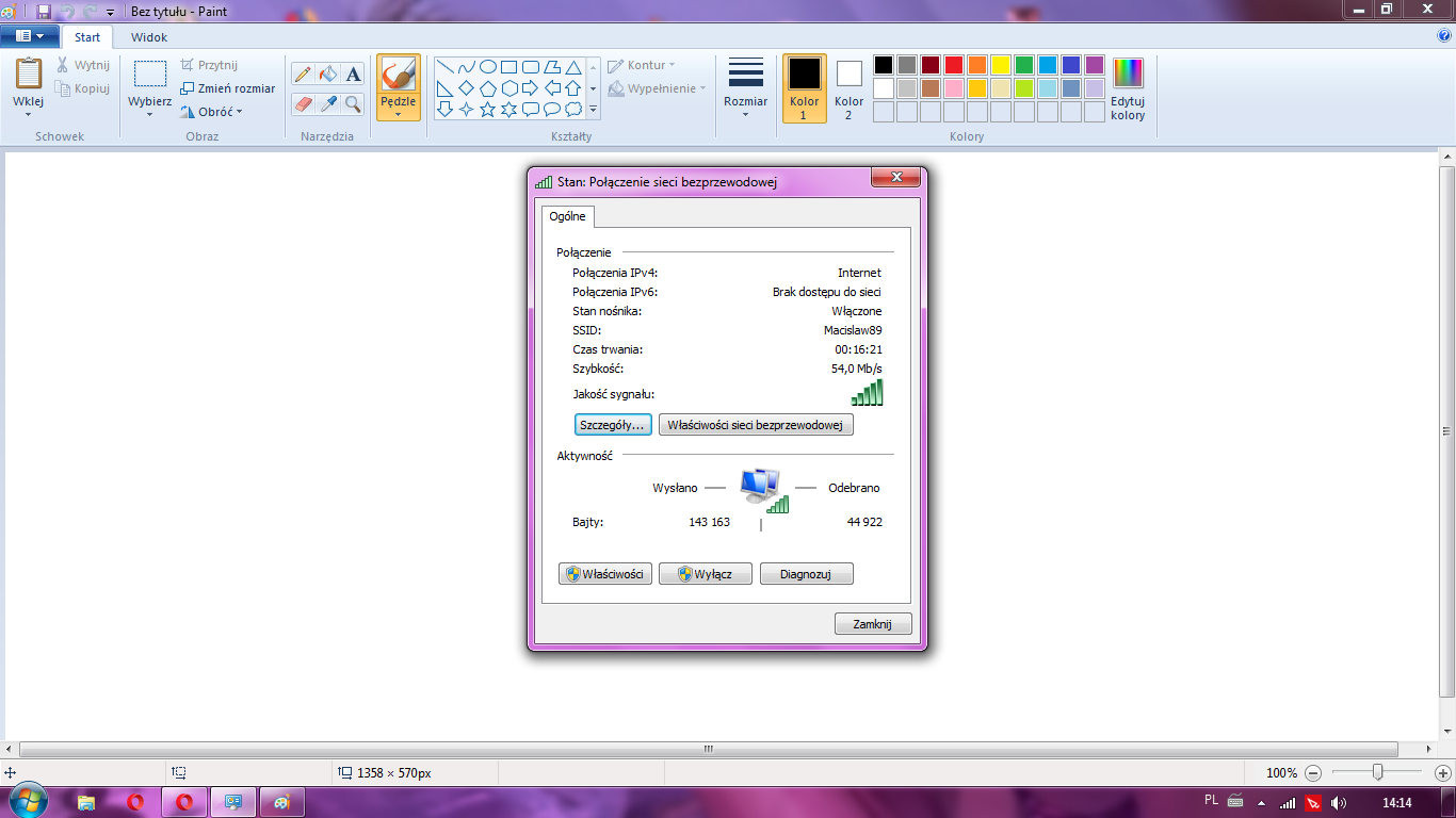

    I am creating a new topic because I have a problem with the WIFI network that I cannot deal with. I haven't had a wireless connection for two days .. It started with the fact that I did not notice that the switch of this network, which is located on the front of the laptop under the controls, had just turned off. When I realized that this was the problem and turned on the detection of wireless networks again, it found my network for me, it connects to it, but there is information about the lack of internet access, as well as a black exclamation mark on a yellow background on the taskbar next to the WIFI icon .
    I read all the forums, tried all the things that were recommended but it didn't work. In the network state, there is information at IPv4 - no internet, and IPv6 - no network access .. So I tried to manually enter the values for Ipv4, it did not work - but when I set it back to determine the IP address automatically, I already thought that the problem was resolved - because the exclamation mark disappeared from the taskbar and the information that there is internet access appeared - the same when I entered the network with Ipv4 this information appeared. Unfortunately, to my dissatisfaction, there is still no internet. I tried to reset the router twice (TP LINK TL-WR741ND), checked the network card drivers (Broadcom 802.11g) - the information says that the drivers are up-to-date. I would like to add that the Internet is not available on all devices - i.e. a second laptop, mobile phones. The only way to connect to the Internet is via a cable. I am adding 5 photos, gentlemen, which may tell you, as professionals, something where the problem may be. Thank you in advance for each tip and help in solving my problem. Regards Maciek

    Hello. Click diagnose in wireless network connection. No Wi-Fi password?

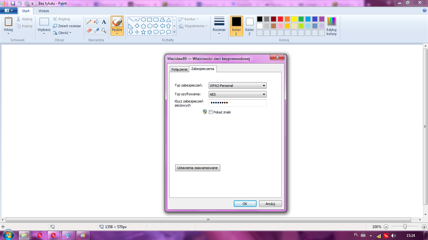

    The problem cannot be identified by troubleshooting.
    Sure there is a password - see photo

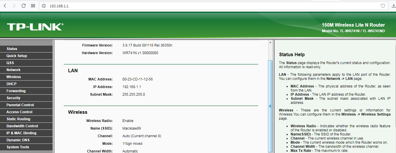

    Hmm .. When I reconfigured the connection, there was some quick configuration - in the sense of setting the password and name. Unless something needs to be figured out here? (picture)

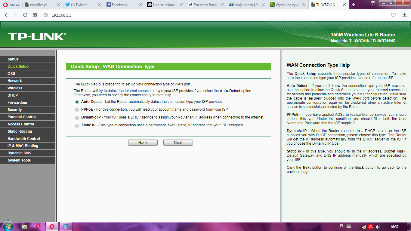

    Static DNS address or dynamic IP provider IP entered?
  • #8 16977576
    Macislaw89
    Posts: 10
    Probably not - but have a look for yourself .. In this "WAN" category should I complete it?

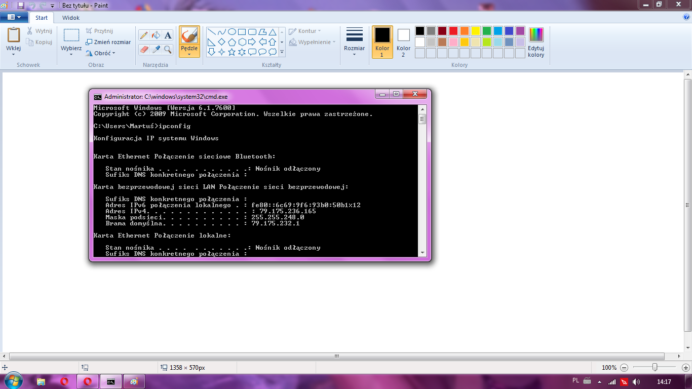

    No matter where I plug in the cable - whether in the "WAN" input or in one of the other four, when I click there in WAN "RENEW", a moment of thought pops up the message "Obtaining network parameters" and they are still 0 .. And tell me more - because Before, I had one of the four sockets plugged in all the time, never in the WAN - and everything was ok. Maybe when restarting the modem it should be plugged into the "WAN" input?
    Or maybe something needs to be configured here? (photo) just for me it's gently black magic.

  • #17 16977681
    jimasek
    Posts: 35287
    Help: 3783
    Rate: 2681
    Connect to WAN and disconnect the modem from the provider for a while. Then check what is on the WAN of the TP-link.

    Gentlemen, there is progress :) I did as my colleague recommended above - I connected to the WAN, restarted the cable modem and all the necessary parameters jumped in in the WAN settings and the wireless internet works :) Tell me at the end, should I leave the plug in "WAN" or switch to one of the others? The question is whether the internet will still work then.
  • #21 16977759
    jimasek
    Posts: 35287
    Help: 3783
    Rate: 2681
    Leave the connection through the WAN port. This is the only correct connection when using more devices in the local network.
