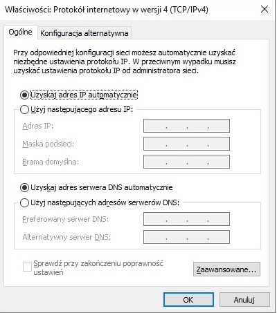

    WITH ipconfig it follows that there is an IP address, there is a gateway address, no DNS server addresses! It has no right to act. Computer configured for automatic download or "finger"?
  • #7 16469433
    flisekk5
    I do not really know what is going on, but when it comes to the IPv4 internet protocol, I have set to automatically obtain an IP address.

  • #9 16469486
    jprzedworski
    Posts: 5366
    Help: 758
    Rate: 827
    flisekk5 wrote:
    I am set to automatically obtain an IP address.
    In Windows you have two options: automatic download of IP address and DNS servers.

  • #10 16469545
    flisekk5
    Limited Internet Access Every 15-30 Minutes: Lenovo Z-51 Laptop, Windows 8.1, Huawei E5573 Router
    I do not have access to the router, so I do not even have to show the configuration.
    That's exactly how I got it, as in the picture above.
