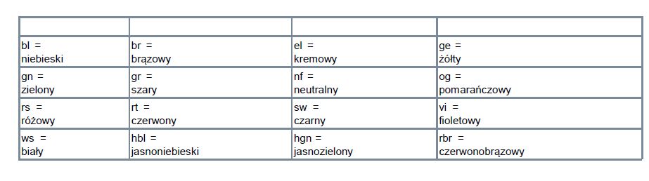

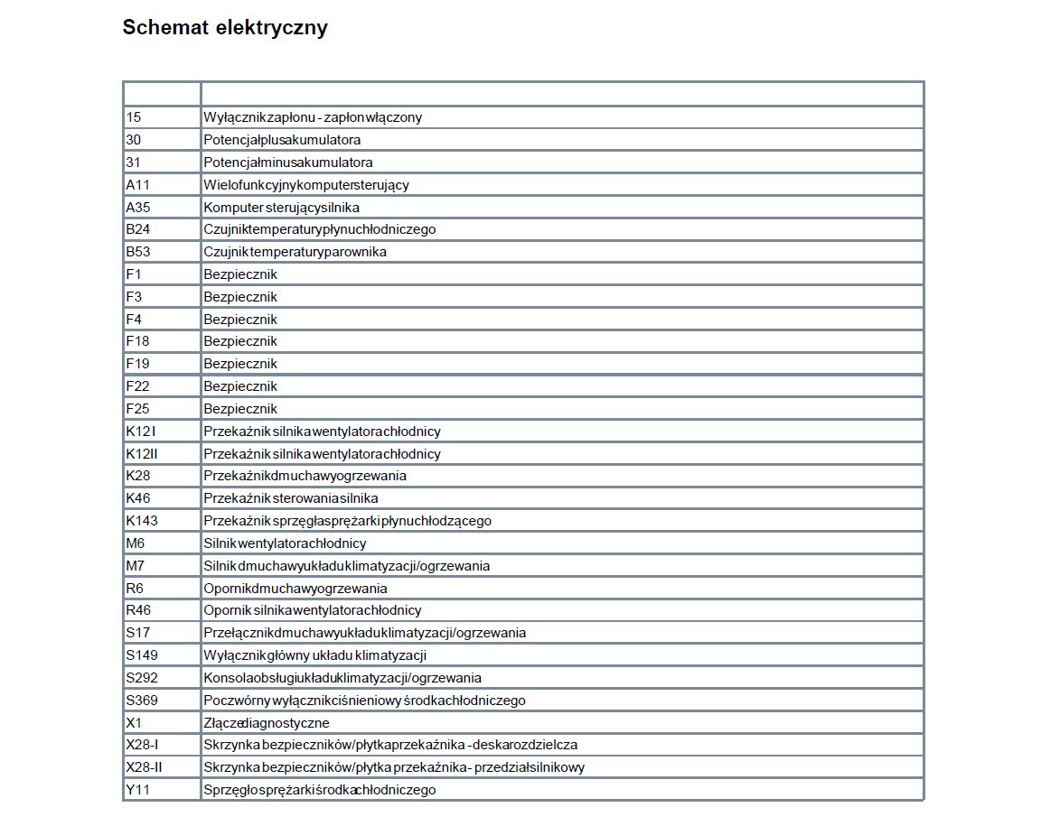

    prosty_01 wrote:
    The pictures show a diagram for the 1.2 16v engine
    FIAT PUNTO II FL 2003: Seeking Air Conditioning Schematic for Non-Original System
    Descriptions of elements in the diagram
    Wire colors

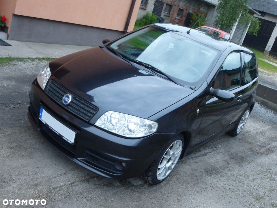

    However, not this pattern. He said that in 2003 Fiat presented a faceted version of the Punto II, modeled as the Punto II FL. You need to look for a diagram of the 2003-2004 model as in the picture and there must be 3 contacts in the pressure switch there (plus and minus enter and the signal comes out).
    Best, [/ syntax]
    • FIAT PUNTO II FL 2003: Seeking Air Conditioning Schematic for Non-Original System 849616221_5_1080x720_sporting-19-jtd-fl-alu-16-klima-zarejestrowany-lodzkie_rev001[1].jpg (122.57 KB) You must be logged in to download this attachment.
