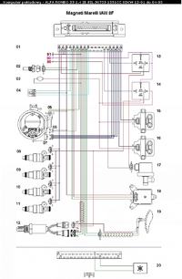

    I warmly welcome.
    Does anyone have a driver diagram (pinout) Magneti Marelli IAW 8F.5T / 070C-18 FIat Punto 1.2 CM MPI IMB
    I need to run a completely different engine on this driver (plus pigyback) and I have some doubts.
    greetings

    take a look maybe it will help
    Fiat Punto 1.2 MPI: Magneti Marelli IAW 8F.5T/070C-18 Driver Diagram & Pinout for Engine Swap

    Connectors / modules:
    05 - TPS (throttle position sensor)
    06 - IAT (air temperature sensor)
    07 - ISCV ("stepper motor" / slow speed controller)
    17 - EVAP
    18 - MAP
    Others probably do not require explanation.
    If you do not have the "ECOL" version then you have IMMO ...

    Thank you very much
