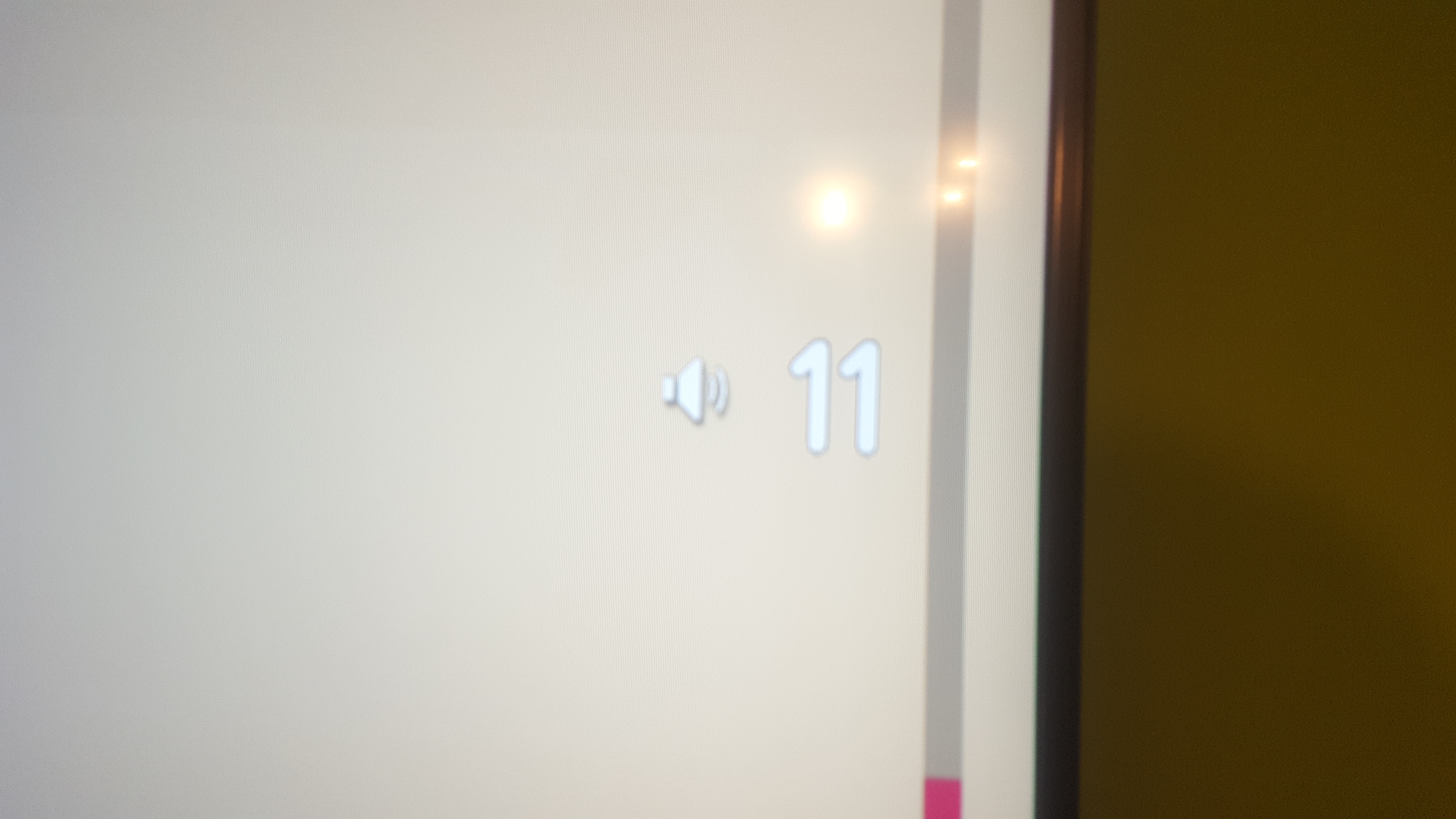

    Hello forum members, I have a current problem in my purchased TV from the exhibition, which stood for 1 month. There is a problem with the image - on each channel, the logo and the image are slightly yellow, not white, even on the UPC inscriptions, when the description is displayed, the subtitles are also yellow, but when I press, for example, when I press the TV, the logo gives a white color. I tried the settings in various forms, but the result is the same, I changed HDMI too and nothing helped. Is it possible to somehow manage it, set it up or is the TV set for return? Thanks in advance for your answer. Photos in attachment.

    Ok, I will check it, but the picture is generally a little yellow and I also noticed when I turn on the TV and upc, for 5 seconds the graphics are white and in a moment everything is yellow. I would like to add that I have a 7-year-old 37 inch LCD LCD, the colors are white not yellow.

    Go to the image settings and see if anyone has changed. Turn off the ECO modes, set the color temperature to neutral, standard settings and not some movies or games.
    Do you watch from a set-top box via HDMI or the TV itself?
    I have LG and nothing is yellow. White is white so don't do LG anti-advertising. It's the best TV in my opinion.

    Everything is turned off and still the same I wrote that even if I turn on the ps4 consoles, it is also yellow and I have lg 37 inches and there is ok
    Added after 10 [minutes]:
    Restoring the factory settings of the tv and upc brought a positive result, the white theme is closed.

    czaryna23 wrote:
    Everything is off and I still wrote that even if I turn on the ps4 consoles, it is also yellow and I have lg 37 inches and it's ok
    What does it all mean? I wrote you to go into the image settings and change.
    The same as factory settings you would do by setting as I wrote to you.

    Solved subject resetting tv and upc to factory settings gave a positive result thank you for the information
