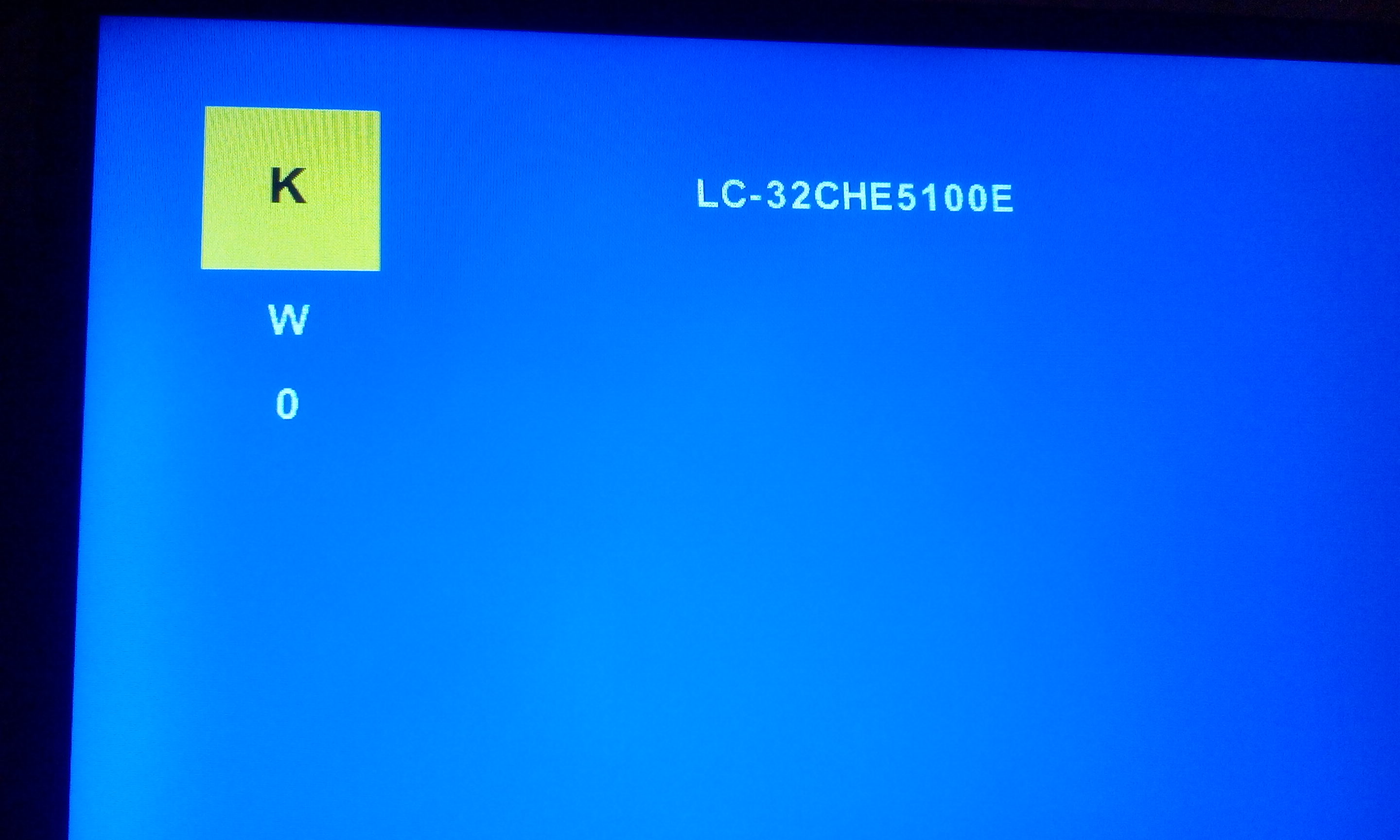

    I have a problem in my Sharp LC-32CHE5100E, namely I somehow turned on the yellow letter K on the TV, there are also letters W and zero (0) below and to the right of the letter K the model of the TV.
    I have no idea how to turn it off. This is very annoying; I called the service, they gave me combinations of buttons but it did not help.
    PLEASE HELP QUICKLY!!!

    what if i don't have this input button?
  • #4 16151638
    Polon_us
    Level 42  
    Posts: 6937
    Help: 1184
    Rate: 1280
    Another name for the "Input" button is "Source".
    After all, the TV has such a key.

    the command you gave, press menu on the remote control and then 1349 the TV will turn off and the installation will start again Unfortunately, it does not work when you press this combination nothing happens :(

    Hello Colleagues. In my case of such a TV, to turn off the letter K, it is enough to press the source button on the local keyboard while the TV is turned on and hold it for a moment power. The TV will turn off and when you turn it back on, the letter K no longer pops up. I have to enter the service mode myself and none of the ways described on the forum work, maybe someone knows a different way and will share their knowledge. I will add that I have two such TV sets, in both there are different matrices and other electronics.

    First remove the antenna cables. Then turn on the TV. Use the remote control to bring up the menu (menu button on the remote control) and enter 1147. Then the service menu appears. There, directly select point 0 Init and execute with the right arrow key. The TV then turns off. Now reconnect the antenna cables. Now only the installation is carried out. Set the country language etc but set the LCN to OFF. Start your search.

    Thanks for your help, code 1349 worked for me

    Code 1349 works for me
