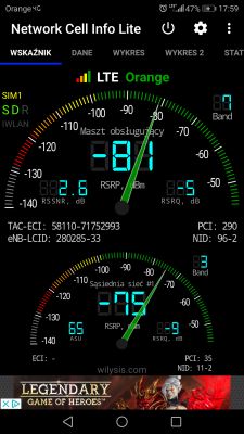

  • #16 17299349
    Weekend123
    Posts: 10

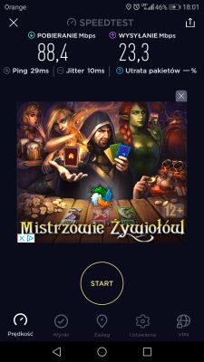

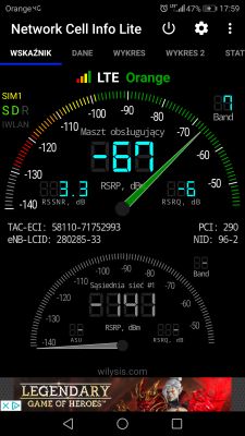

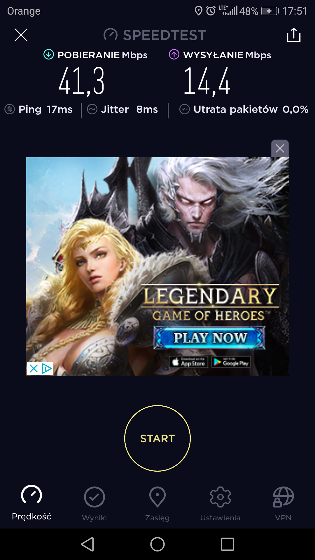

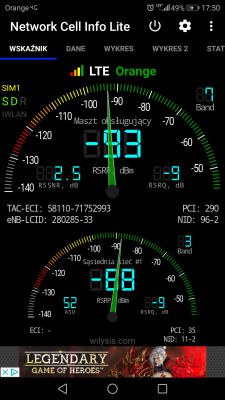

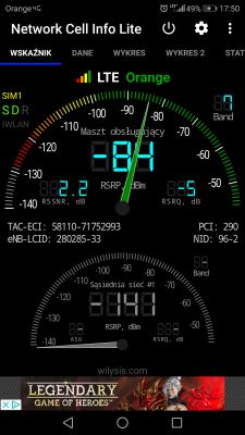

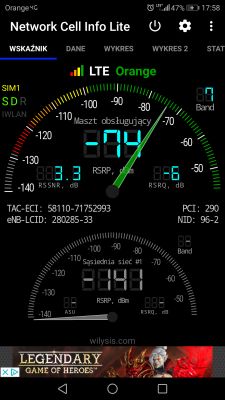

    I will connect not to create a new topic.
    I am asking for help in choosing a router with a modem and a mobile internet antenna with orange (I do not have abo yet, but the best option seems to be PLN 19 / month for 50gb because I already have abo in orange)
    My Location:
    Single Antenna Use on Dual-input Routers: A Study on B-315, B-525, B-593 Models
    measurements in the room:
    Single Antenna Use on Dual-input Routers: A Study on B-315, B-525, B-593 Models Single Antenna Use on Dual-input Routers: A Study on B-315, B-525, B-593 Models Single Antenna Use on Dual-input Routers: A Study on B-315, B-525, B-593 Models
    measurements more or less in the place where the antenna would be:
    Single Antenna Use on Dual-input Routers: A Study on B-315, B-525, B-593 Models Single Antenna Use on Dual-input Routers: A Study on B-315, B-525, B-593 Models Single Antenna Use on Dual-input Routers: A Study on B-315, B-525, B-593 Models Single Antenna Use on Dual-input Routers: A Study on B-315, B-525, B-593 Models Single Antenna Use on Dual-input Routers: A Study on B-315, B-525, B-593 Models
    thanks in advance for your answer
    Edit: I want to spend PLN 500-600 on equipment

    B525 and www.cybertech.com.pl/p173,antena-dualna-lte-a-4g-17dbi-mimo-1800-2600mhz.html
    Do you have 50 GB, and after exceeding 1Mb / s?

    Weak offer, no equipment. Why load into something like this? On Allegro you can buy a card with 300GB for six months for PLN 90. You can still use these methods, you need to buy an Orange YES starter for PLN 5, register and provide your address details in the salon and marketing consents. Then change the tariff to Orange Free for which you get a 50GB bonus for 2 weeks, use it and then run another bonus on Orange FREE, i.e. 100GB for marketing consents and address details. In this way, for PLN 5, we have 150 GB of internet for 45 days. If we do not find Orange FREE, we only use 100GB for 30 days for PLN 50. As long as the offer works, you can use other cards using these myki. Next to RBM pre-paid with RWK and DIL, it is the cheapest way to access mobile internet without a subscription. A subscription with equipment in T-Mobile and no limit beats such subscription offers for PLN 19 per head. The cost is PLN 49 for DL up to 20 Mb / s, but the subscription includes PLN 20 for a router with LTE-A B525. Coverage as in Orange. And there is still free LTE Internet with no limit for RBM on Card 5 on the LTE Play network, cost 5-15 PLN. Range from Play BS to ZEC Wołomin, 4 LTE bands with aggregation. When it comes to coverage, you live under BTS NetWorks with LTE2600, LTE1800 and LTE800 and with their aggregation and minimum is a router with LTE-A 6 category aggregating two bands, B525, E5186. You can buy B715 with LTE2600 + 1800 + 800 aggregation for about PLN 500. No antenna needed for Orange, T-Mobile. The signal parameters on the LTE phone are correct.

    You have about 3 km to BTS Play, so without an external antenna it is difficult to get an effective connection. Only the T-Mobile Strong LTE starter has no DL / UL limits. As for the B525 and B715, the latter aggregates three LTE bands and this is the fundamental difference. On BTS Duczki are LTE2600, LTE1800 and LTE800 and their aggregation. You will use it on B715, of course, also from the aggregation of two bands or a single one. On B525 only with LTE2600 + 1800, LTE2600 + 800 and LTE1800 + 800 and single band. HManager is used to manage the bands on them. As for ping, it is usually the lowest on a single band.
