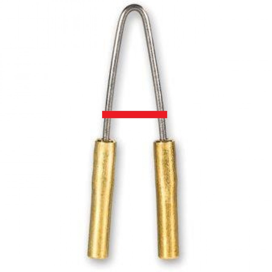

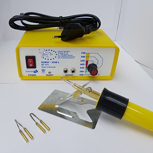

    While reading the reviews about the devices, I have recently purchased a Burny-Star L ST 171 professional pyrograph. (A supply station with temperature control and a butt with a resistance wire).
    Reading the topics on this forum, due to the rather complicated process, dissuaded me from trying to create a device from scratch.
    Coming to the point: the lowest temperature offered by the burner is 450 degrees - this temperature is definitely too high to work on miniatures with small details, also shading comes with great difficulty (Razertip, unavailable in Poland, offers work from 170 degrees)
    Could any of the Readers advise me on a safe way to lower the temperature of the tip?
    I was getting ready to prepare my tip from a thicker wire (hoping to lower the temperature) but the fear of burning the power station led me here to ask more experienced people.

  • #2 16608976
    redbull00
    Posts: 223
    Help: 5
    Rate: 16
    It is impossible to answer this question without knowing what is inside such a pyrograph. I suppose there is a thermocouple inside that senses the temperature of the tip, a comparator and, for example, a power supply whose power is controlled by voltage. In the simplest situation, the whole thing can be reduced to replacing the resistor next to the potentiometer for setting the temperature.

  • #4 16608992
    Freddy
    Posts: 19997
    Help: 1394
    Rate: 2822
    I suspect that this "temperature control" is just a regulation of the current flowing through the tip. However, without knowing the internal system, nothing can be said more precisely.
    You would have to disassemble the device and take clear pictures of the interior and the circuit board.
    The tip is most likely a piece of resistance wire, not ordinary copper wire.

    Wouldn't a lower resistance wire tip reduce the temperature?
    Added after 23 [minutes]:
    Additionally, how would the solution based on creating a bridge on the mainsail according to the diagram attached in the photo work? Would the temperature at the tip of the tip stay the same?
    Lowering Burny-Star L ST 171 Pyrograph Tip Temperature for Detailed Work
    Added after 15 [minutes]:
    I already have the equipment at home - hence the need to lower the temperature when I tested it.
    It is covered by the warranty, so I try minimally invasive methods first.
    Is there any risk of an increased electromagnetic field in the case of the above-mentioned bridge?

  • #7 16609220
    Gmiter
    Posts: 24
    Regulates the change in voltage at the output: from 0.5 V to 1.6 V

    This voltage can be achieved in several ways. Anyway, you can try with increase tip resistance (if you have such a resistance wire).

    398216 Usunięty wrote:
    If it can safely withstand the increased power consumed (additional jumper on the tip) then OK, but if not
    I could also ask for an explanation of the risk of short-circuiting the tip with a bridge (e.g. from copper wire)?

    #10 16609505
    398216 Usunięty
    Posts: 34327
    Help: 3925
    Rate: 9453
    You add additional resistance in parallel to the existing burr - as a result, you reduce (as long as you don't measure the resistance of the tip) the resistance "seen" by the power supply. If this resistance is too low, the power supply may be overloaded and, consequently, damaged. Besides, such a bridge (for the voltage you specified) will not touch the tip well (you would have to weld it), and therefore it can bypass once and not once.
    I think that the principle is similar to transformer soldering irons - in them too much wire thickness causes a significant voltage drop (because it overloads the transformer) and the tip heats up less, but the transformer (in this case the power supply) more ...
  • #11 16610351
    Gmiter
    Posts: 24
    Unfortunately, I will not look inside the power supply because I have a warranty seal. Well, at the moment I am releasing the modifications. Maybe one day I will catch my eye something that suits the installation of a thinner resistance wire in place of the current tip.
    Thank you for your help.
