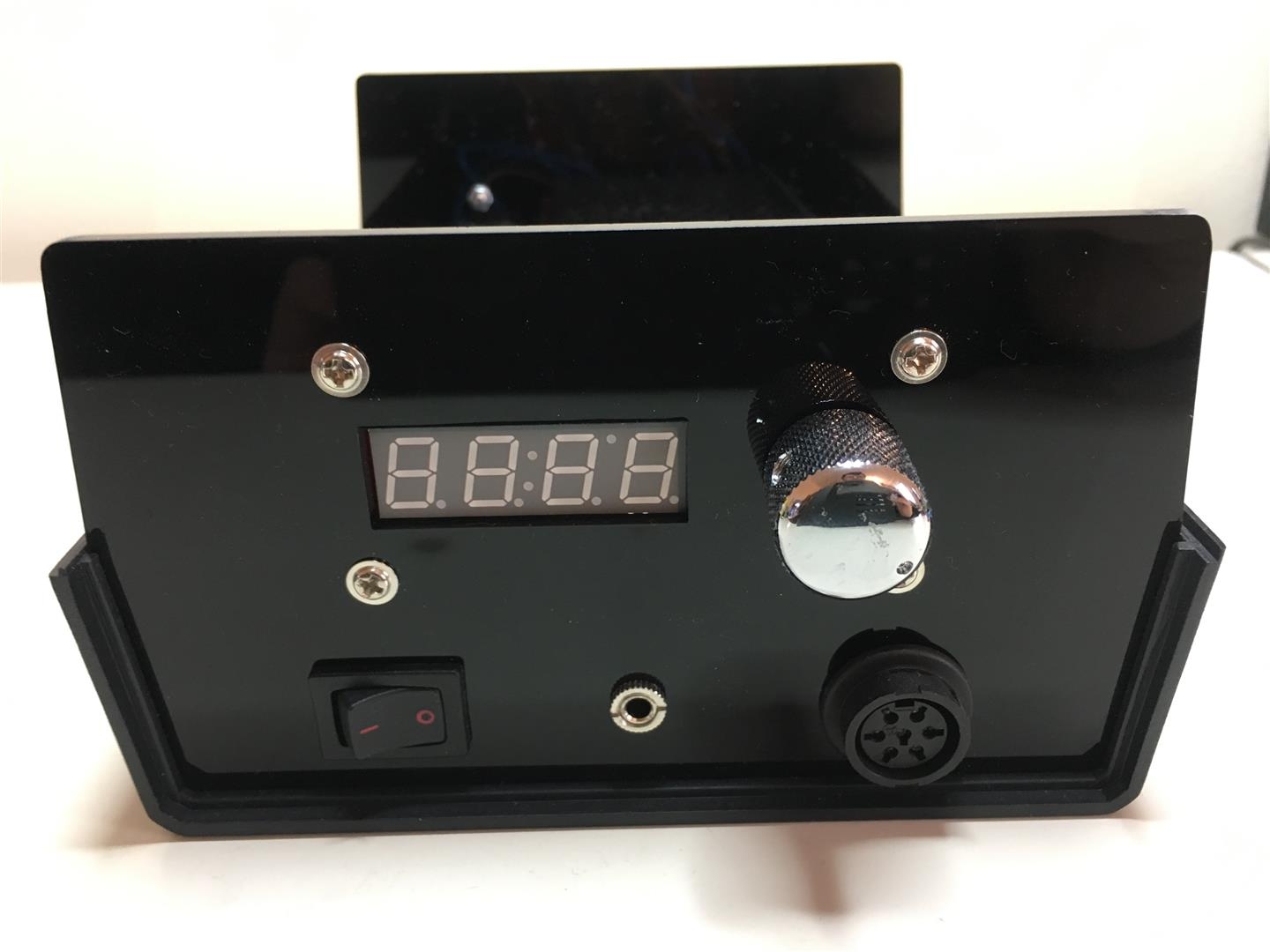

    The case was ordered from eBay measuring 180mm x 150mm x 90mm. The front and rear panels were cut on a laser exactly for the housing and the mounting plate and sockets. I could only do this after measuring the original panels that came with the casing - they are matte and so is the entire casing. However, the ones I got from a company that cuts with a laser are mirror-like, which look better than matte ones.
    DIY Weller WMRP and WMRT soldering station DIY Weller WMRP and WMRT soldering station
    As for questions about why such a large casing could be accommodated in a smaller one, it was only to put my second station for large tips on it, and now there is also a sound card for YouTube. This is what it looks like on my desk:

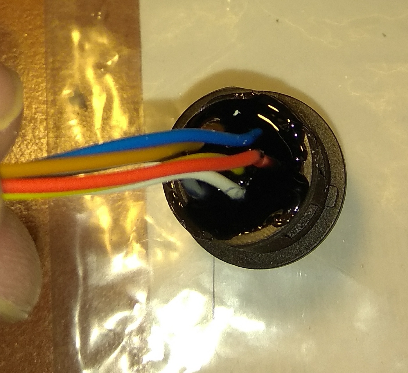

    The stock was made of a stock from the Zhaoxin soldering station. I didn't want to use a tip plugged into the 3.5mm jack extension only, because it wasn't comfortable for me, and the tip itself was stuck in the holder stand. The stock is a little shorter because I had to cut it down until the hole was large enough to attach the end of the jack extension in a way that allows for easy replacement of points like in the original stock. Extensionglued with hot glue after proper adjustment to the inside of the stock, so that it cannot slide out over time due to changes in the tips.

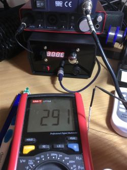

    Sorry for the long response time, but I was away. I did a test today and there was a 9°C difference between the station indication (the tip itself) and the thermocouple of the meter. Below is a photo.

  • #18 16992170
    Slawek K.
    Level 35  
    Posts: 3020
    Help: 259
    Rate: 1301
    In this case, a few degrees of deviation does not matter at all.

  • #19 16992207
    hacker_ice
    Posts: 871
    Help: 36
    Rate: 101
    If it was 30-40°C, that would be something, and as for the temperature, when I measured it, the oscillation was only 1-2°C, but that was probably only due to the movement of my hand.

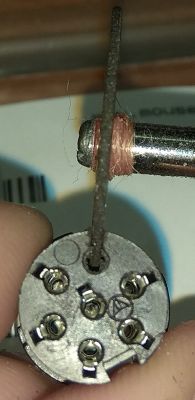

    In total, I made two stations based on this design and in both cases the temperature was too low, I didn't have time to figure it out further, so I inserted two multi-turn potentiometers in the amplifier feedback loop and manually adjusted the temperatures.
    Depending on the tip or thermo tweezers, the measurements differ by 10C. Now I wonder whether the Weller has a D-type thermocouple as it was done in this program or maybe something else.
    A table of D-type thermocouple voltages is attached
    and a mini tutorial on how to modify the socket to fit the original Weller connectors.

    I'm adding instructions for converting the socket, which are a bit easier than my friend previously added.
    • How to make Weller WMRP WMRT Socket.pdf (2.47 MB) You must be logged in to download this attachment.

  • #28 17907637
    tupax3
    Posts: 7
    So I'm waiting for the final version. Did you solder any components on iPhone boards with these pliers? I wonder how these pliers compare to JBC pliers. I found this video https://www.youtube.com/watch?v=syjEbtffkag. Is the plug from the original pliers or did you make your own?
  • #29 17908758
    hacker_ice
    Posts: 871
    Help: 36
    Rate: 101
    I just saw this video and JBC makes even smaller tips for them, I will also make stations, one prototype works.
    As for Weller, the guy shows a 0.4 mm tip, I do everything with a 0.2 mm tip and everything is OK. I make paths under the system, etc. I made a long screw in 5S with a 1 mm tip, so everything is possible.
    The plug for these pliers is made so that it fits both my station and the original Weller. The socket in my station is modified, so the original pliers and cash also fit without any problems.
    Generally, I don't know when the final version will be available, I don't have much time and people already want these pliers. The first prototype from the film found a home in a service center in Poland right after the film and the new owner is happy with them, even though they look like they do, but as he says, they do the job :).
    Regards

✨ A DIY soldering station compatible with Weller WMRP and WMRT handles was developed using a PIC16F1788 microcontroller, controlling temperature via a single Alps EC12E2424407 rotary encoder and displaying data on a Lite-On LTC-4627JR or Youngsun ATA3492BR-1 display. The station supports original Weller tips with 3.5mm jack connections, enabling fast heating and features such as PTC thermocouple cold junction compensation, flask presence detection via a magnetic sensor, temperature setback, standby modes, offset adjustments, and selectable temperature units (°C/°F). The design samples plug presence to prevent short circuits during tip insertion/removal. Thermotweezers (WMRT) require original holders connected to standard sockets, while WMRP tips use the mini jack socket without original handles. Temperature stability tests showed a typical 9°C difference between station reading and external thermocouple, with oscillations of 1-2°C. Calibration adjustments were made using multi-turn potentiometers in the amplifier feedback loop. The station uses D-type thermocouples, with firmware updates available (version 9.1). Mechanical improvements include using threaded 3.5mm sockets with aluminum bushings for better tip stability. Community members shared resources such as pinout modifications, thermocouple voltage tables, and 3D printable handle designs. Some users reported issues with tip recognition ("NC" message) and incorrect reference voltage (VREF), which were resolved by verifying connector pinouts and system calibration. The project emphasizes compatibility with Weller components while offering cost-effective alternatives and modular design for soldering and thermotweezers applications.
TL;DR: 9 °C max tip deviation, “Very fast heating” [Elektroda, hacker_ice, post #16992158], confirmed in a 1-hour run with ±2 °C drift. Cost per fully-built controller ≈ PLN 400 (~€90) [Elektroda, hacker_ice, post #16975843] Why it matters: you can match pro-grade Weller WMRP/WMRT tools for a hobby budget.
• MCU: PIC16F1788, 1.024 / 2.048 V FVR used for sensing [Microchip DS41685]. • PSU: 12 V ±5%, ≥5 A LED-strip SMPS works [Elektroda, hacker_ice, post #16975843] • Heating time: <5 s to 350 °C with RT1 tip [Elektroda, hacker_ice, post #16975843] • Typical accuracy: ±9 °C; stability ±2 °C [Elektroda, hacker_ice, post #16992158] • Latest firmware: v9.1 (2020) [Elektroda, Asedio, post #19038709]
What tools does the DIY controller support?
It drives Weller WMRP single-tip irons via 3.5 mm jack and WMRT thermo-tweezers through the Amphenol T 3437-000 connector [Elektroda, hacker_ice, post #16975843]
How accurate and stable is the temperature?
A direct test showed the display reading 9 °C higher than an external thermocouple; observed drift stayed within ±2 °C during use [Elektroda, hacker_ice, post #16992158]

How do I modify an Amphenol T 3437-000 to fit Weller plugs?
Slide the central pin block out, rotate 180°, and reseat it so the keyway aligns with Weller moulding [Elektroda, michal82, post #16996066]
