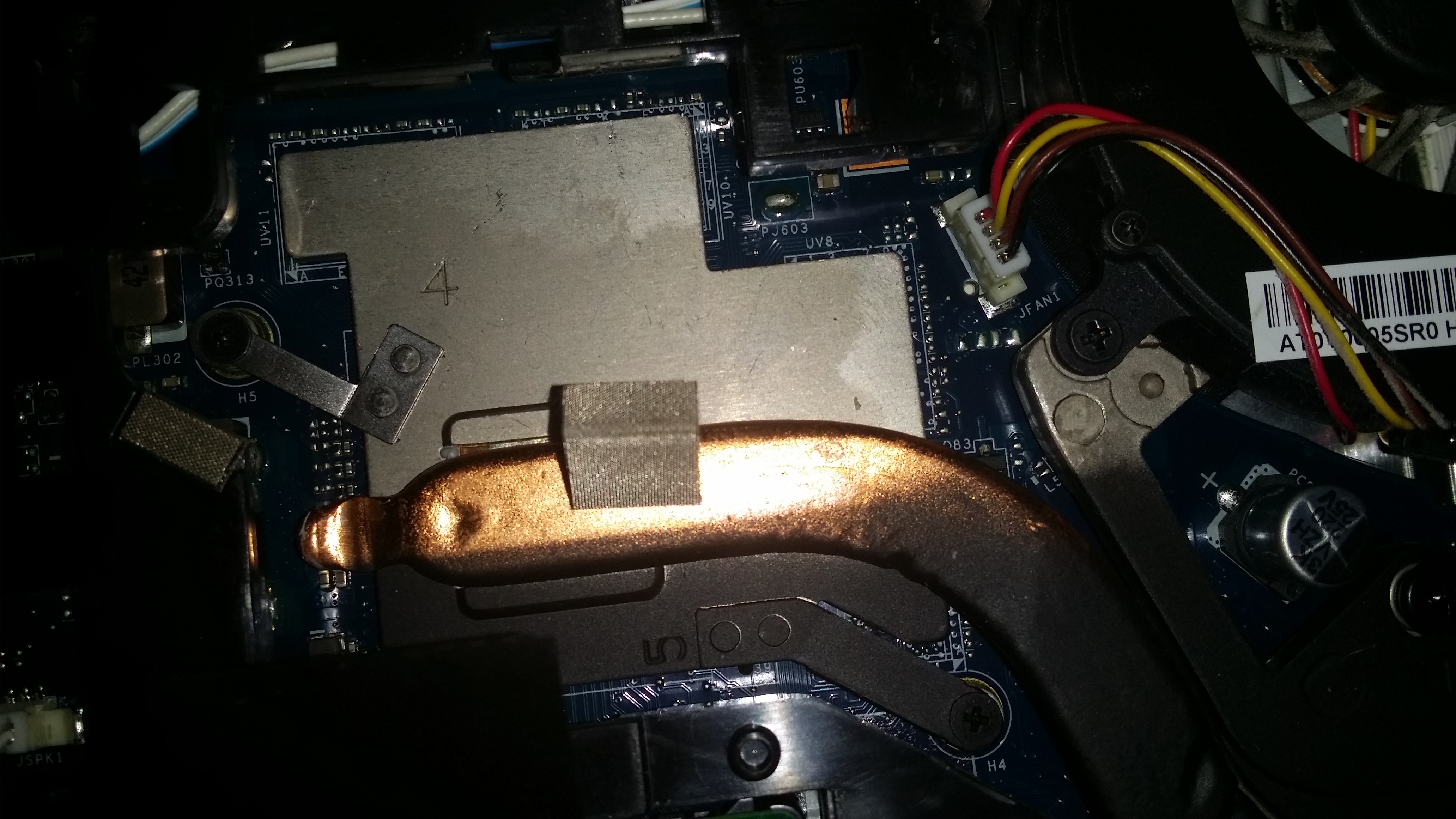

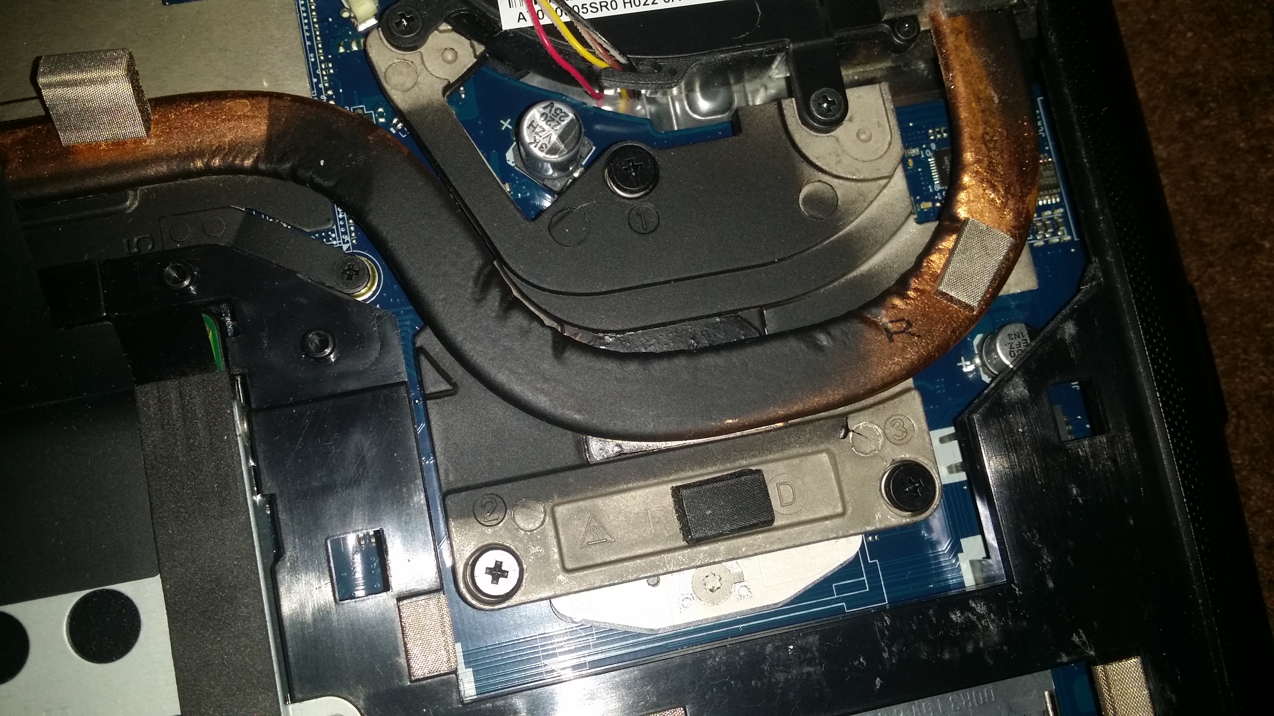

  • #11 16760772
    --shadow--
    Posts: 14
    I will refresh the topic a little bit.
    I opened the paw and took pictures.
    AMD Radeon R5 M230 Series Error 43 on Lenovo G510 Windows 7 64-bit: Device Shutdown & Solutions AMD Radeon R5 M230 Series Error 43 on Lenovo G510 Windows 7 64-bit: Device Shutdown & Solutions AMD Radeon R5 M230 Series Error 43 on Lenovo G510 Windows 7 64-bit: Device Shutdown & Solutions
    (Graphic order, processor, graphics with processor)
    Maybe you see something here?
    Thanks in advance for your help. :D
  • #12 16760796
    miecho18
    IT specialist
    Posts: 18700
    Help: 3087
    Rate: 2777
    The correct answer was already given in post # 2 (and # 4). In other words, you need to return your laptop for service.
