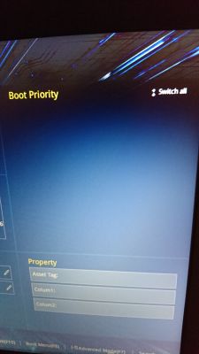

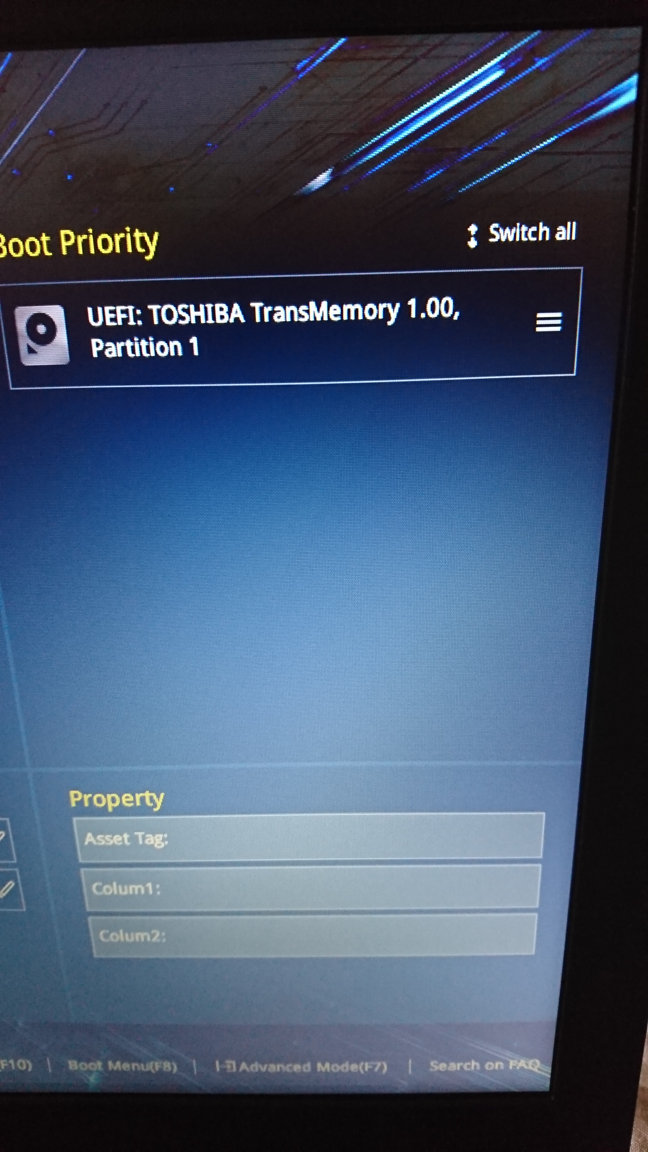

    Thank you - I have a problem with finding any type of 'Launch Bios' option. By the way, do I definitely have UEFI? As the 'Bios Utility' system appears to me - though it does not look like a typical Bios ... Attached photo.

    One of the pictures shows that you have the opportunity to create a boot plan there, specifically the penultimate photo. Maybe it is worth being interested in this option? It's about the "Boot Option" and the ability to delete and add new ones.
